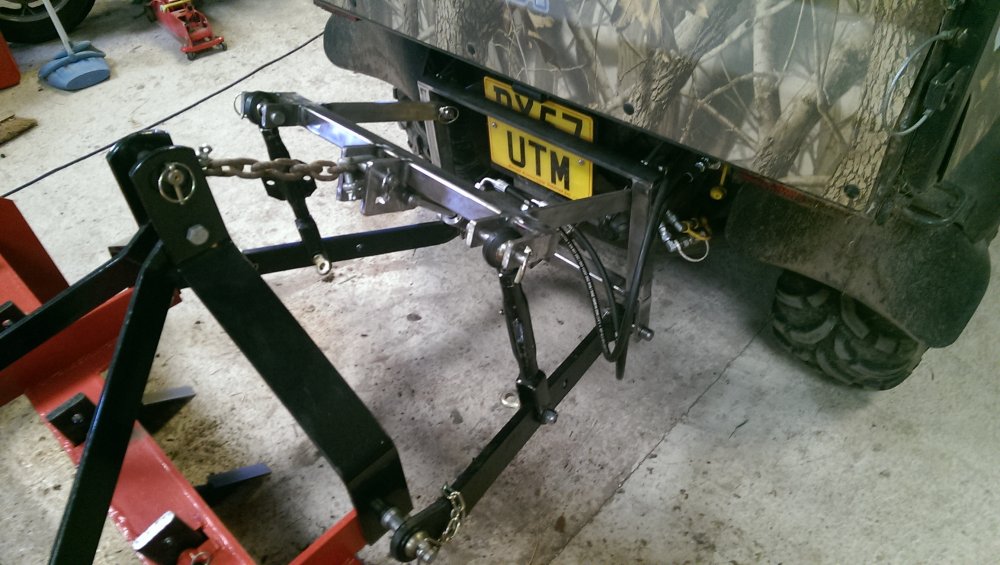

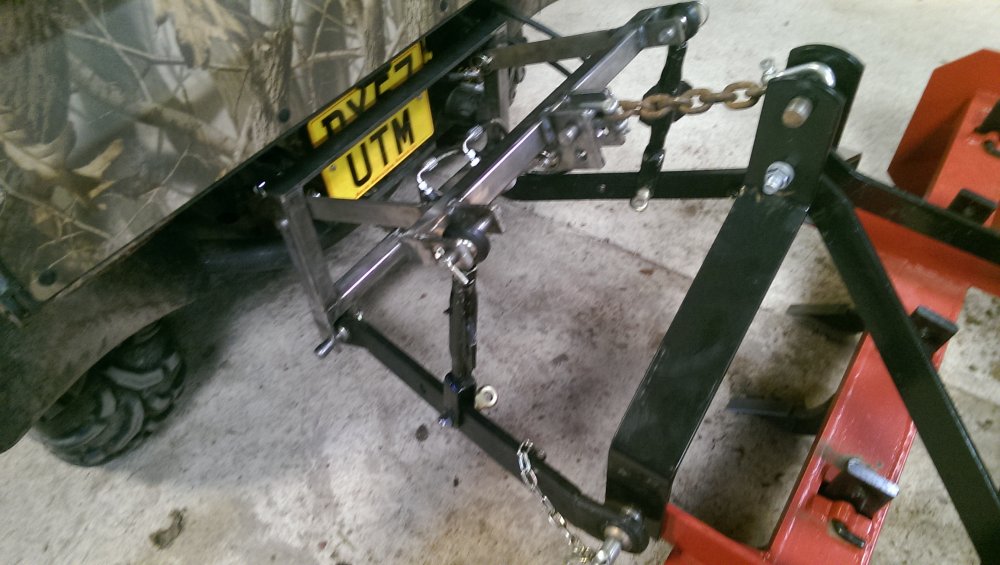

I need to fit a cat 1 linkage to the back of my UTV to carry a box blade. As I am a tight fisted farmer I cant justify the cost $1799 + shipping to buy one of these farmboys- so in true Mig Welding Forum tradition I have decided to make my own. I can get a complete cat 1 Linkage for just over £100 and a small ram shouldn't cost much more than £75 or so. All I have to do is make up the frame and fixing brackets. I have trawled through all the pictures I can find and it appears the they have used 50mm box for the frame - my question is what wall thickness? I usually have a tendency to over engineer things and make them heaver than required - at least they don't bend that way. My initial thought was to use 4mm wall box and 10mm flat for the brackets. The box blade weighs about 200 kgs empty and about 350kgs when full of dirt. Has anyone any thoughts on this.
