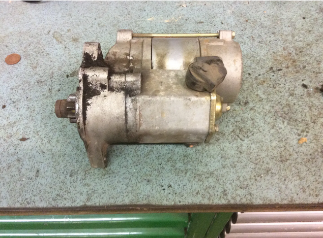

Cranking current can identify a poor connection (low current), faulty starter (high current) or mechanical fault (high current). It's not necessary but it gives good insight into the condition of everything. If the reading is out of standard range then you'll be more likely to have issues even if it works most of the time.Right after some other distraction I got back on this. Starter refitted and works perfectly, as it has always done immediately after being refitted. So I'm back where I was however many years ago.
Unless there are any other suggestions I don’t think there's anything further I can try or test until next time it plays up. When it does so I intend to ..
