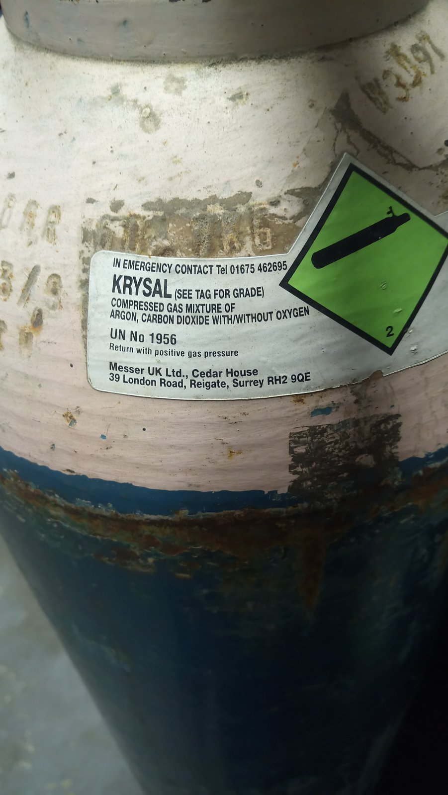

Hi does anyone know if this gas is OK for mig welding
Its 95/5 then....maybe a bit of Oxygen........its OK for MIG....similar to Argoshield LightYeah there is a tag with number 5 on it and a friend gave it to me
Bloody hell a Messer cylinder, where did you find that, the industrial museum
Krystal is/was a MAG welding gas. Might be an idea to roll it around a bit before you use it
