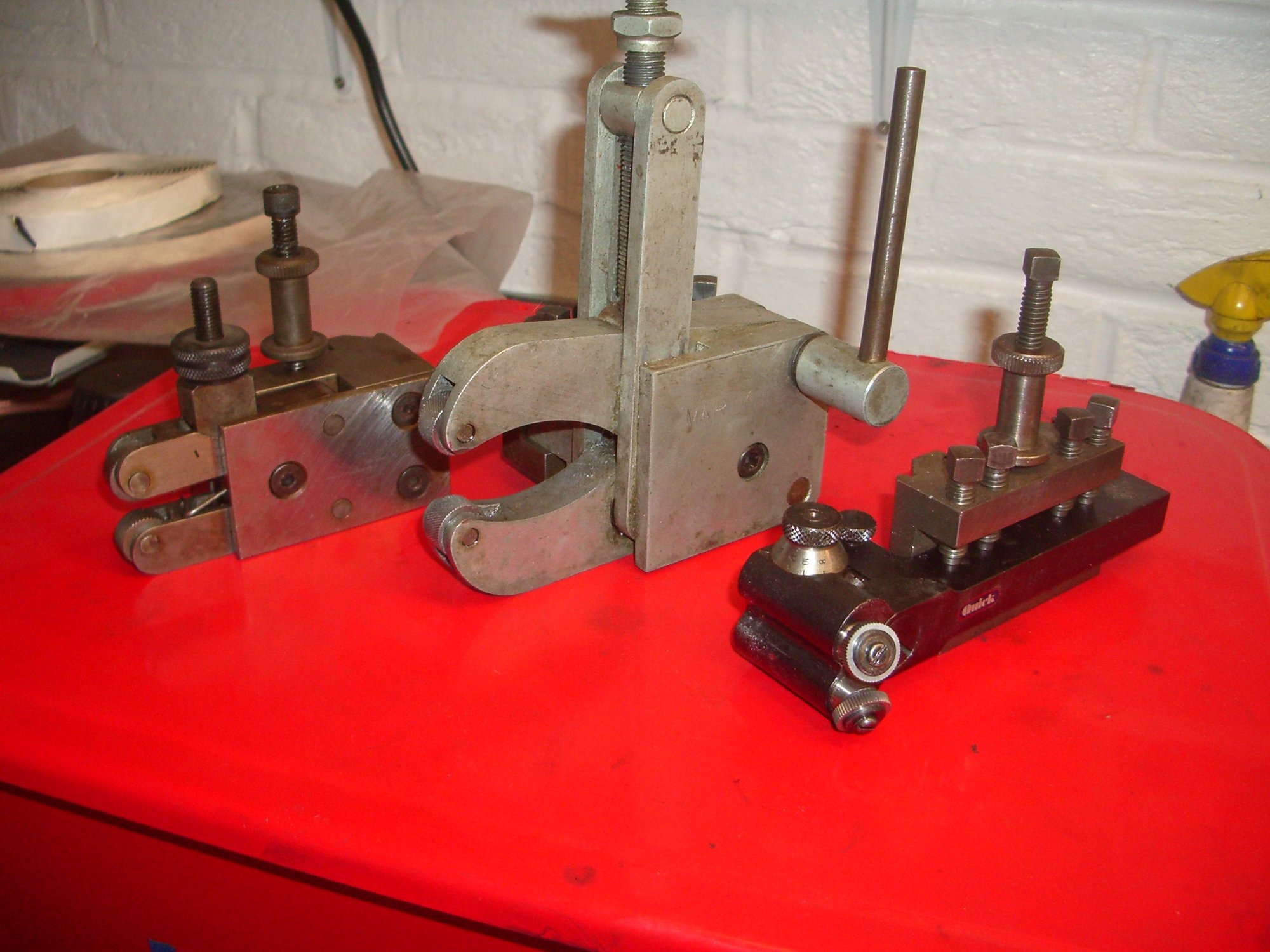

C citizen kane Member Messages 267 May 19, 2018 #21 Yes, tool on the right is a cutting tool, requires much less pressure than the the other two. More importantly it produces reliable and repeatable knurls.
8ob Member Messages 14,240 Location Nescient in the vale May 19, 2018 #22 hareng said: Been using this cheap tool for over 26 years, never fails to give a decent knurl. So far never ever seen a good knurl with the scissor type. Click to expand... I have something similar, only really gets used to knurl home made drifts but does produce the desired result. Bob
