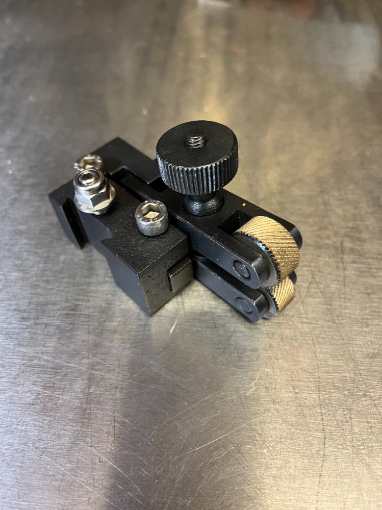

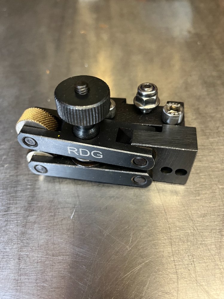

I've bought a Clarke CL250 mini lathe for use while the Harrison hides in the back of a TEU.

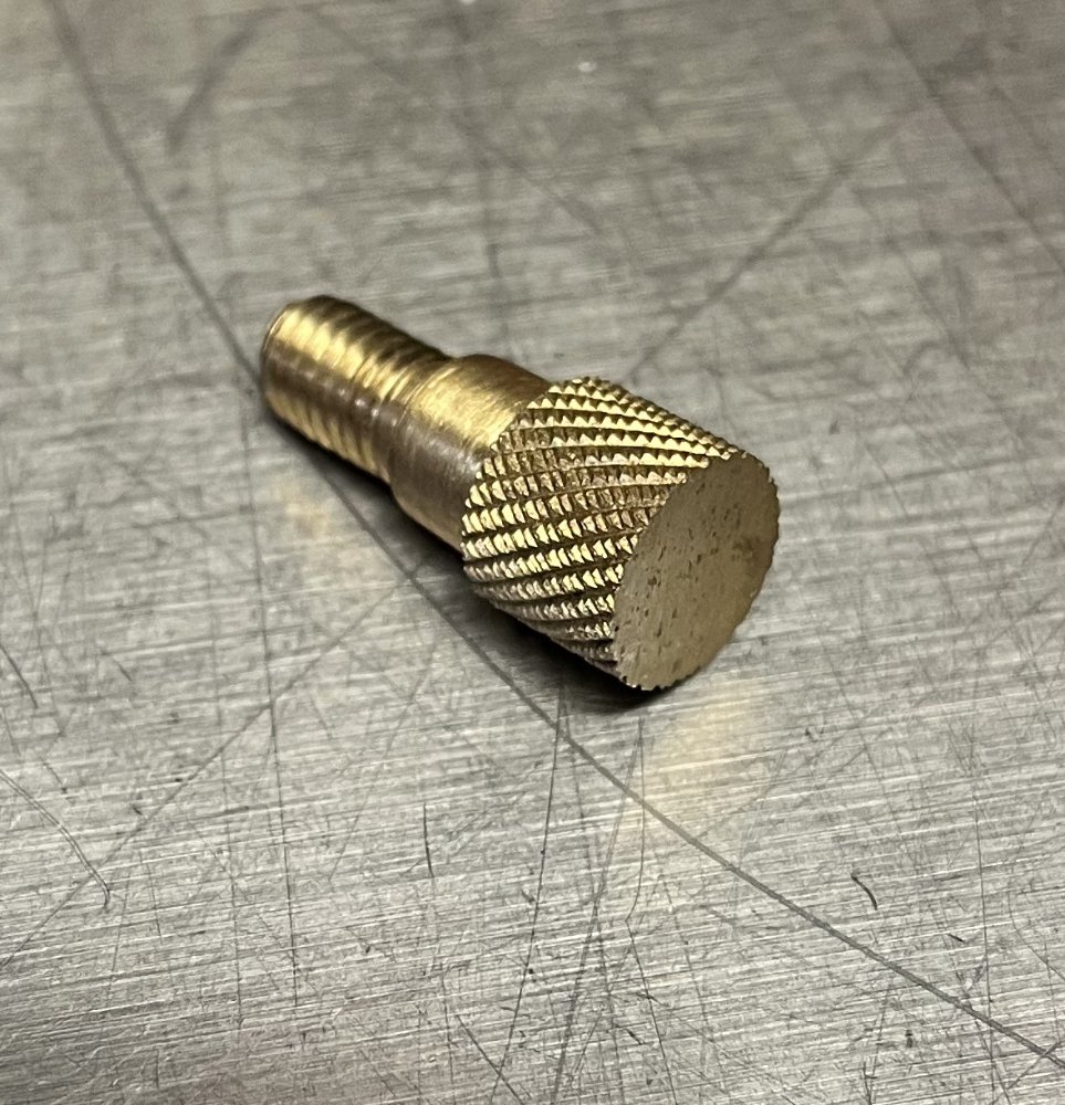

There's a few things I'd like to make, some of them involve knurling. The first one will be height adjusters for Dickson type toolholders. In short, will the lathe have the power to do it. I'd like there to be a reasonably high chance of success before I buy a knurling tool, I think my current ones will all be too big. It's got a 150W motor. The time it might take to do it isn't a problem.
The knurled portion is about 6mm wide on a bar diameter of about 20mm.
