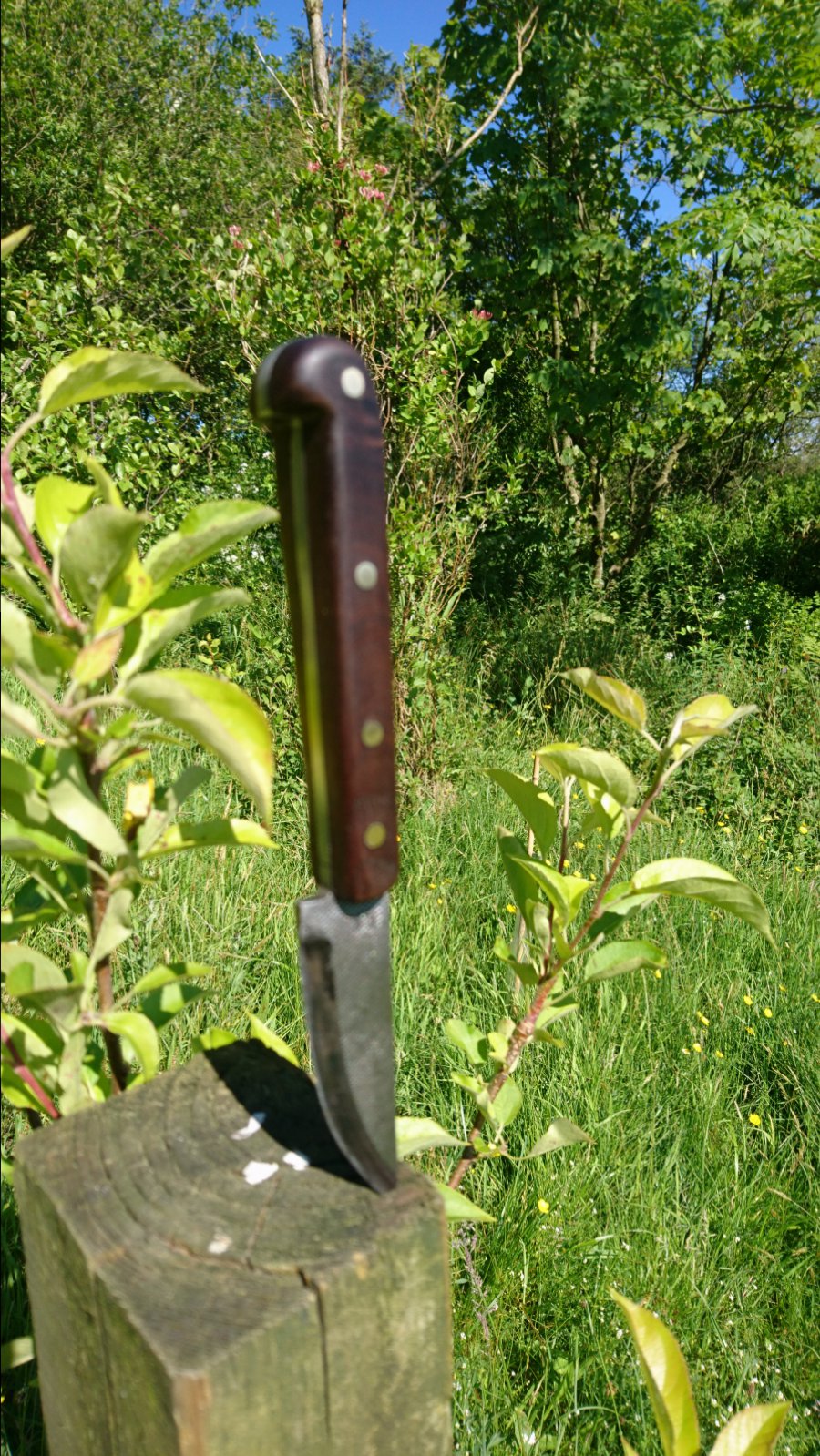

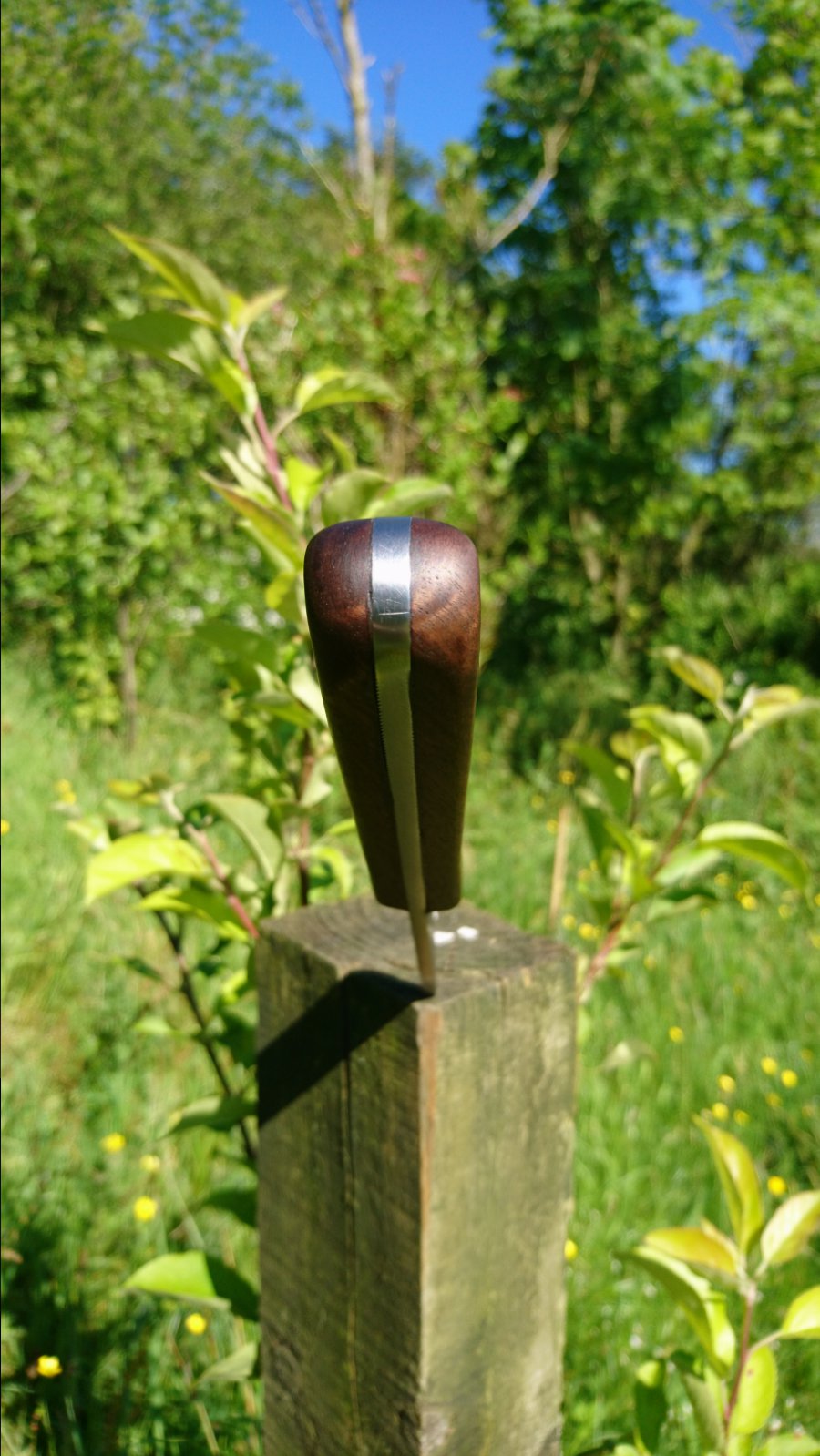

Can any part of the tang be annealed? Failing that attach a ring via a whipping sliver solder etc.Got given a diving survival knife by my dad to put a hole in it so it can be put on a leash.
I don't know what steel it is made of but it has blunttened 10 or so drill bits, hss cobalt and even spot weld hardened. And barely scatches the surface
Dive knives are generally done softer than most knives as they are used as a general tool for prying etc much more than a razor edge hunter.
