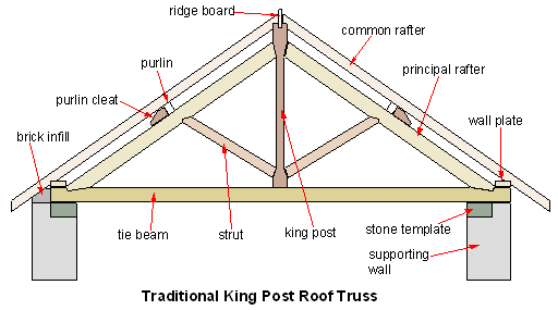

I've being putting a new loft hatch/ladder and while up in the loft i noticed one of the struts on the truss where it joins the principle rafter has a pretty big crack in it.Now the house was built in 1938 and i suspect it was cracked when it was first done the base of the king post was loose and used to move in high winds until i spiked it in about 6mnths ago so i suspect it was a friday afternoon job.
So i was thinking of plating up the truss in the area of the crack with a bit of 3/4" ply either side bolted through with a liberal thickness of epoxy.
Would this be the best way to proceed or are things best left well alone any thoughts/advice appreciated
