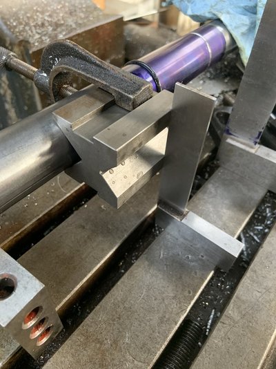

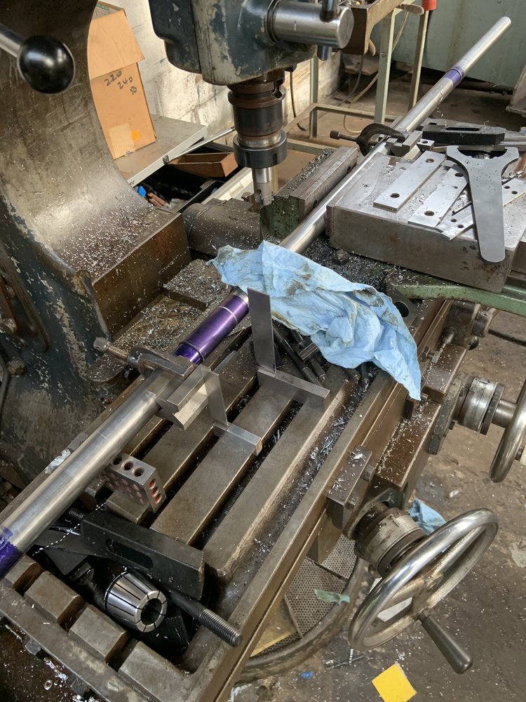

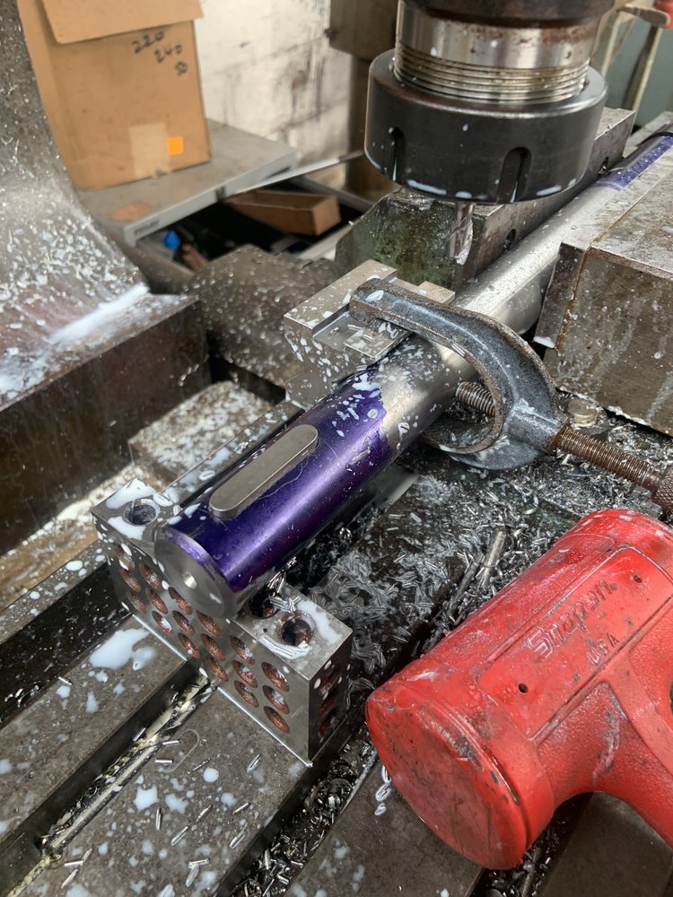

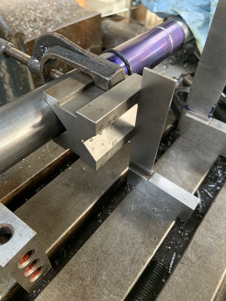

seen as i am being ignoredthis should do you
but for me without certain tools id be clocking in on v blocks fastened to it and clock that in on a long bar
as i could clock the flat part of the v blocks to the milling machine table
heres a point of process
