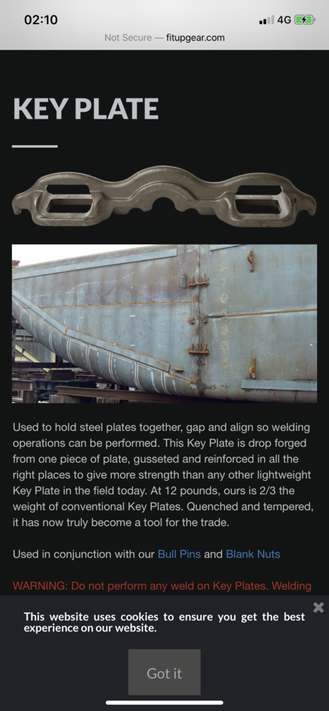

Aye I've plenty of dogs and wedges, the ability to dog a plate down and move it over with one tool though seemed like a good idea.
I mean it would probably be easy enough to fabricate something up to do the same job
If you weld a bolt to the end of the dog, and have a bit of heavy angle with a hole in, you can count that as one tool.Aye I've plenty of dogs and wedges, the ability to dog a plate down and move it over with one tool though seemed like a good idea.
...I've seen some fabricated ones.
