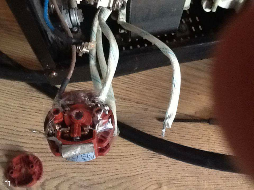

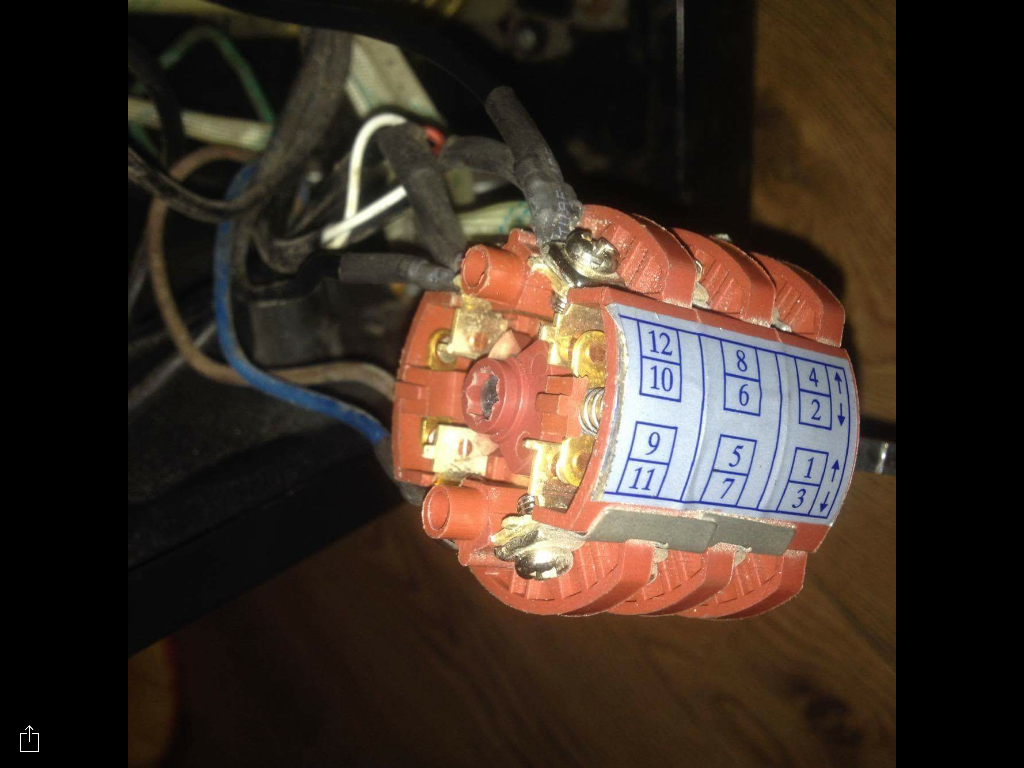

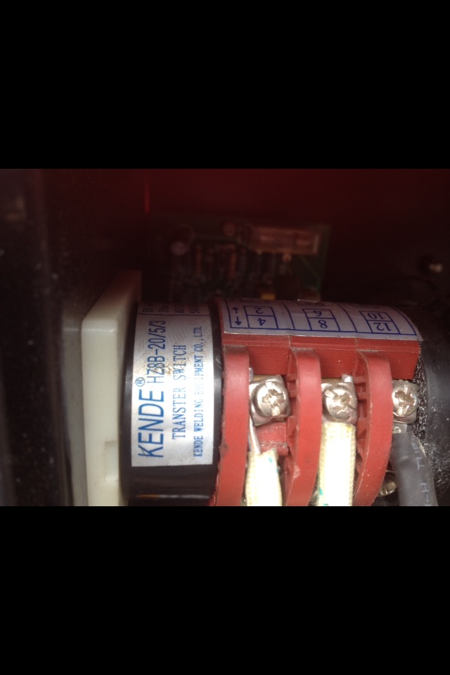

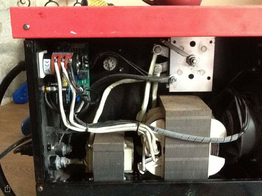

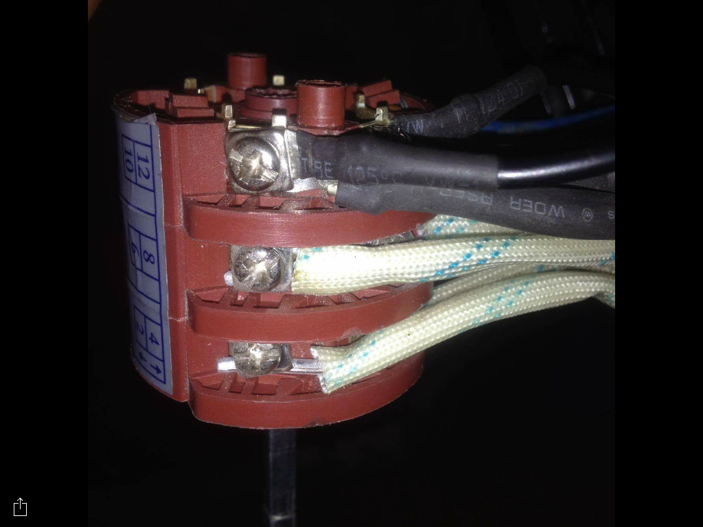

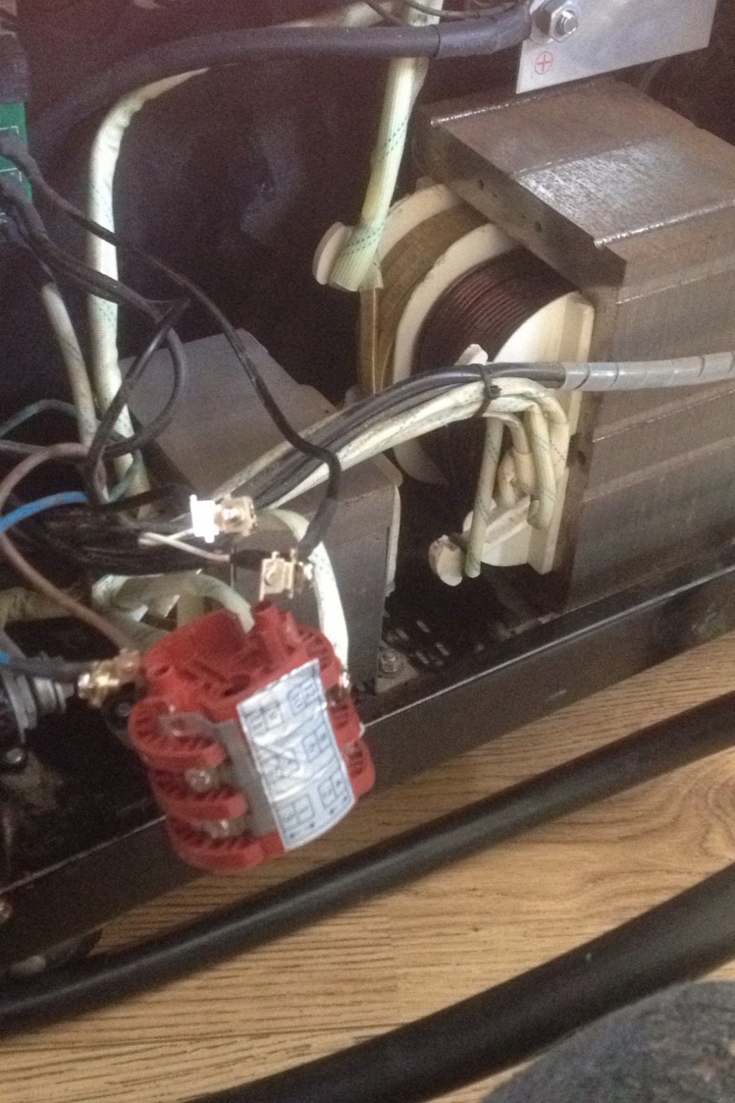

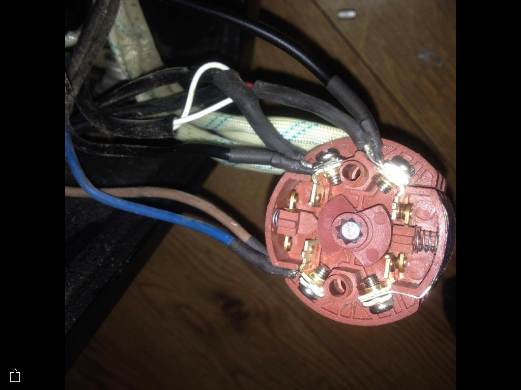

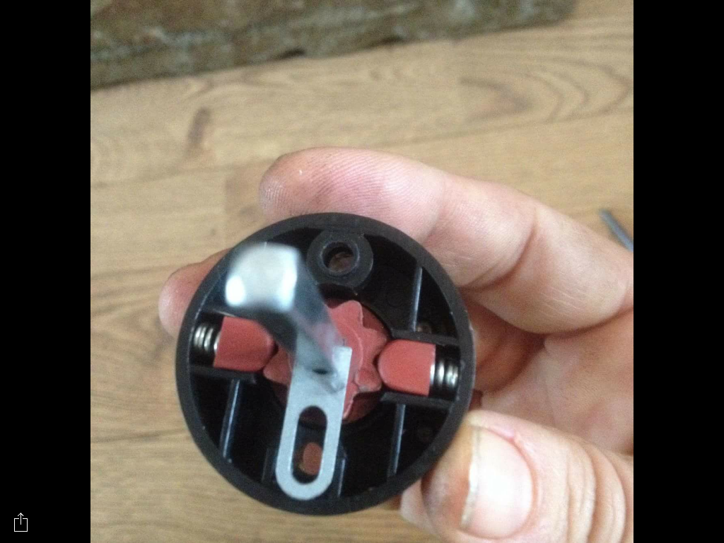

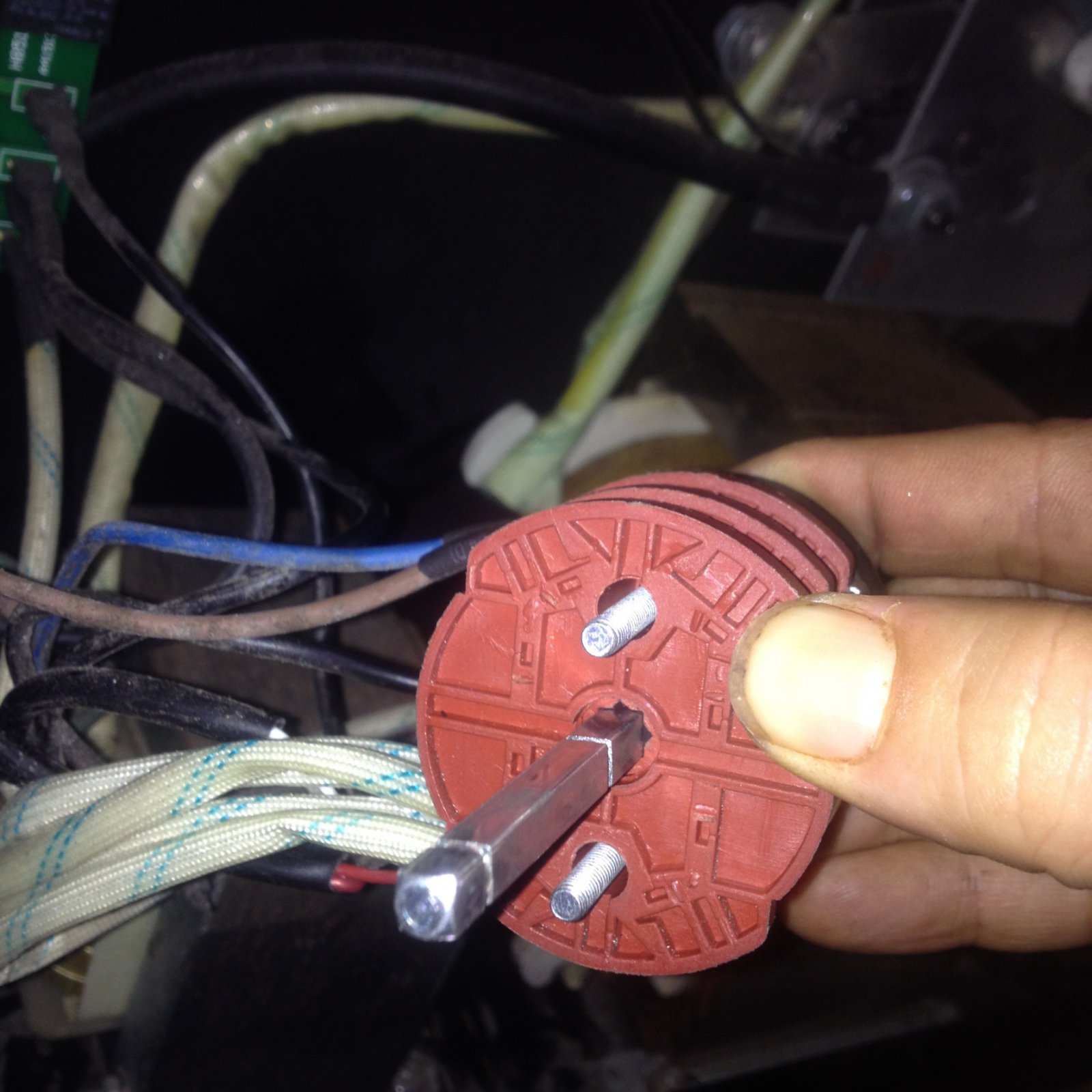

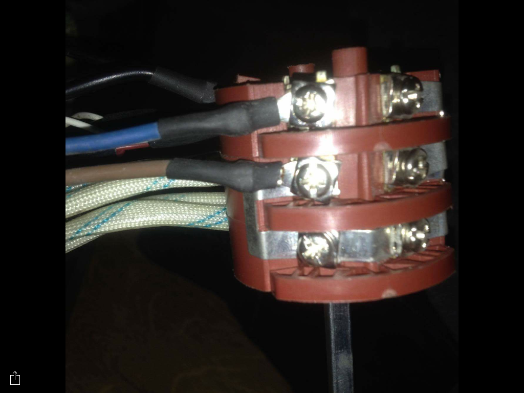

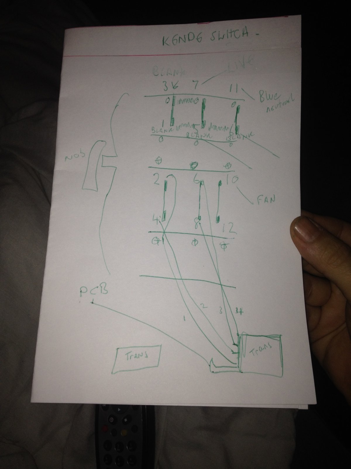

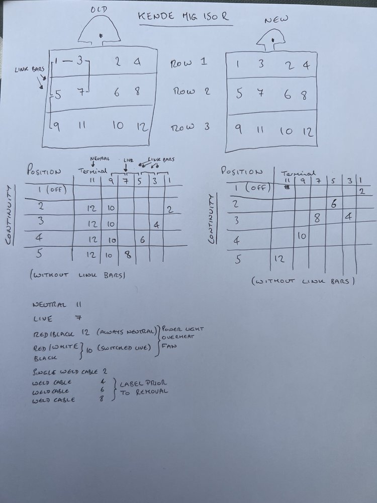

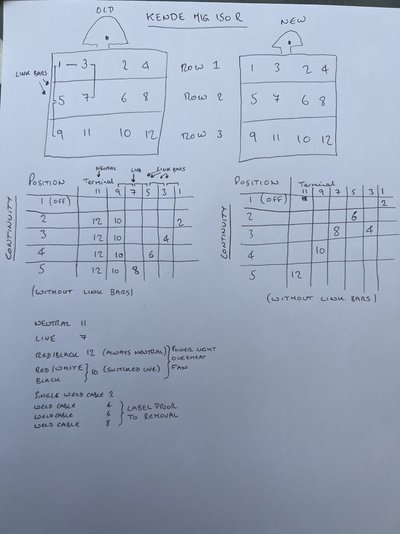

I have a Kende 150R and the voltage switch has failed. I have a new switch but am not sure it is wired up correctly. I want to check before I switch it on. Anyone have the same machine or know someone who has and could send me a photo of the wiring connections?
many thanks
Mark
