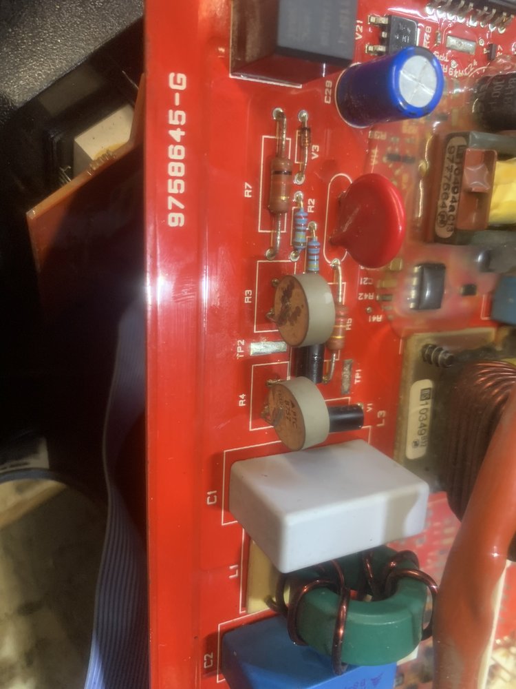

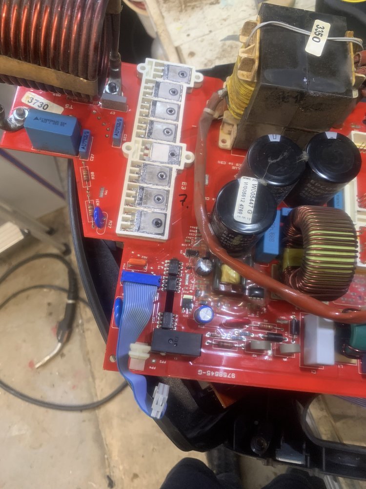

I tested the A001 board and found the voltages were all present and correct when first powered on so the 24v, 27v, 15v and 5v were there however they disappeared slowly as the welder powered down.

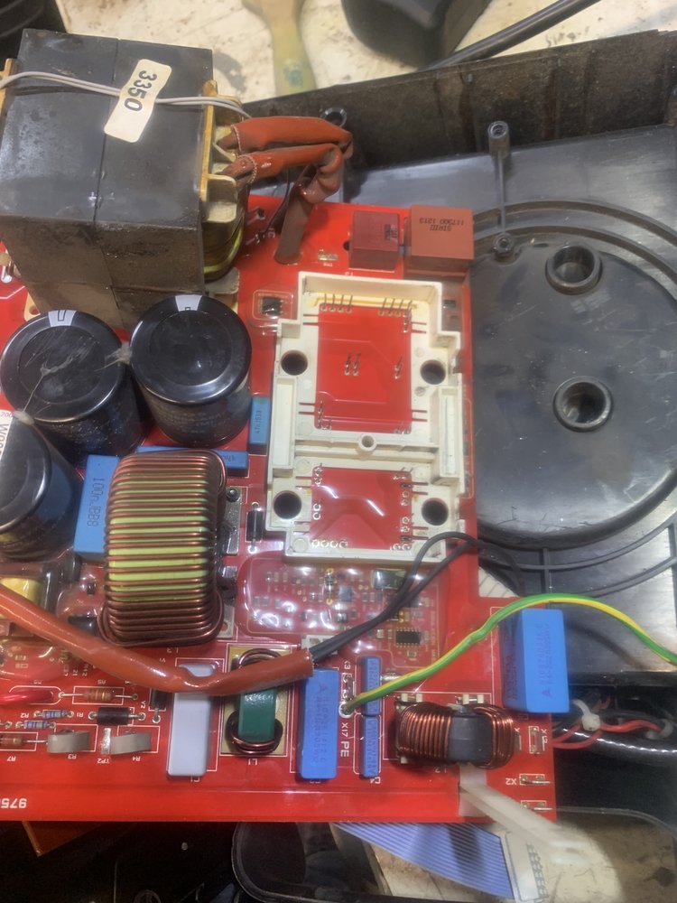

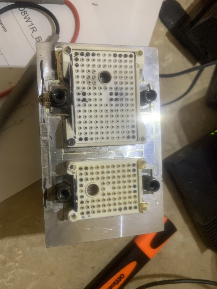

I could feel heat coming from the main Z0001 board and discovered two thermisters R3 and R4 were getting very hot and after measuring the ac voltage across them discovered that R3 was heating up the most and effectively shutting off power to the welder by going open circuit and upon cooling would allow power to get through. the power seems to go to two IGFETS in a casing under a heat sink.

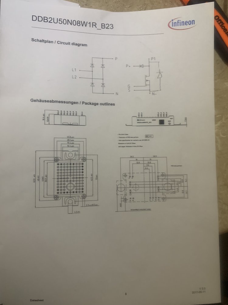

I took the IGFETS out and tried to test but was getting inconsistent readings when comparing to the Infineon circuit diagrams which I downloaded from the web.
I have reassembled the welder which still has the original fault. I spoke to Kemppi in Australia who were quite helpful but were unable to supply a service manual or circuit diagrams, they told me they normally just swap out the boards when they have this sort of problem the cost of a new board was over $1000 AUD. I would like to repair this and am looking for help or advice. I am a pensioner so don't have a lot of money to throw at this. I do have an electronics background so am not worried about doing the repairs myself.
