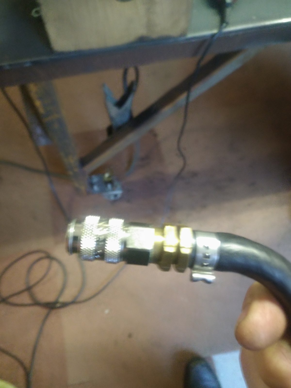

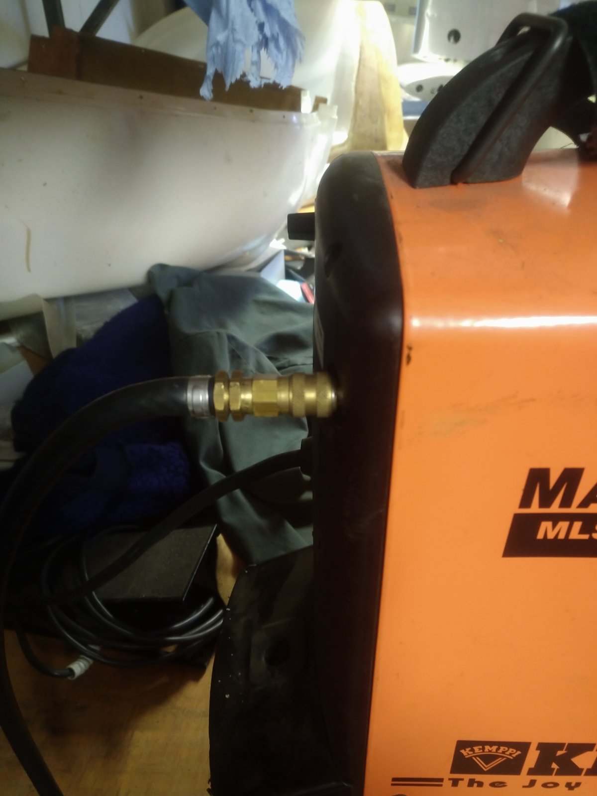

On the back of the mls2300Anyone know what Type Rectus fittings are on a Kemppi MLS. My hose to argon inlet is leaking

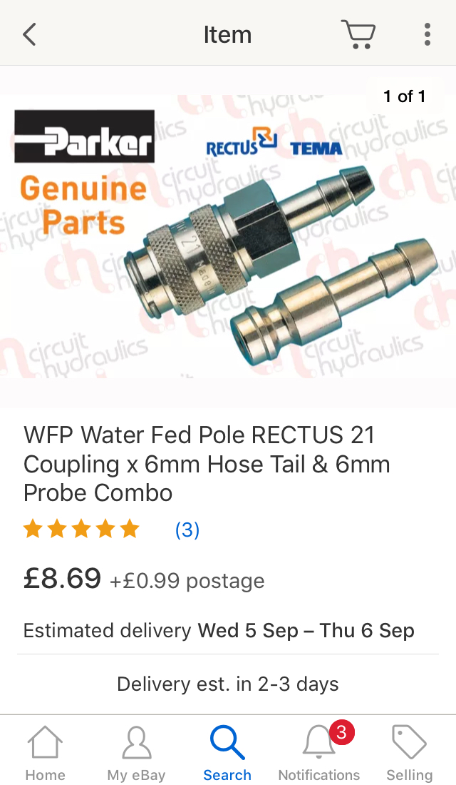

It’s standard rectus 21 male
If it’s smaller than the thread at the front then go with 1/8
Shox chuck up a picture of what you’re after.
Yeah the ones I had that went bad have no name.No name on it, Kemppi part. It's been leaking on and off for a while tbh. Gauge showed no pressure loss this morning.![]()
