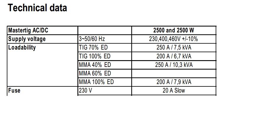

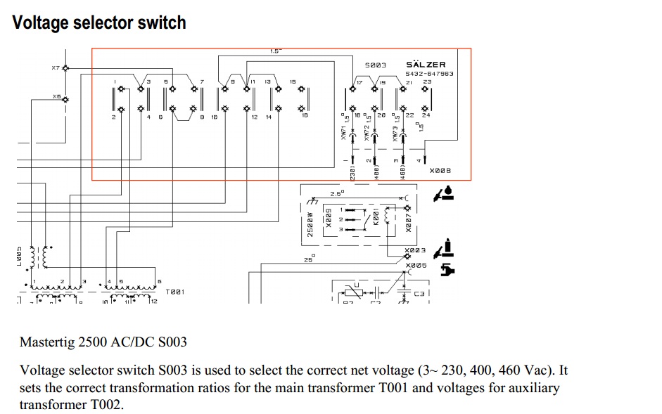

Hi chaps I have purchased a master tig 2300w it has a switch behind the control panel to switch to 240v which I have done I removed cover to wire in supply but it has only L1 L2 L3 connections for a 3 phase supply Does this mean it can only be 3phase ? Or do I connect L1 L2 and leave L3 disconnected Any help advise appreciated
