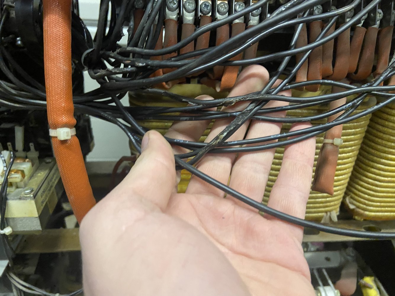

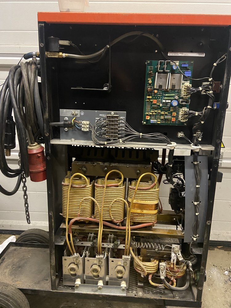

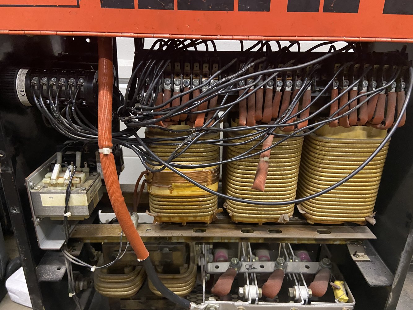

I have a similar problem with my Kempomat 250. There is no welding voltage/current but gas solenoid and wire feed still operates normally.
On closer inspection I noted that two wires between the course power setting knob and the primary winding on the transformer phase located closest to the front panel of the welder have molten insulation and one of the copper wires is actually completely melted off. Both overheated wires unsurprisingly lead to the same coil pair, which is the highest power primary circuit primary winding on the course power setting knob.
I have disconnected and measured all the coils on the failing phase and compared them to corresponding coils on another presumably healthy phase and they check out well. My thinking is however that even one shorted turn on the primary winding (which would not make a notable difference in measured total coil resistance) would create a one turn shorted "ring" around the transformer core which when induced by the magnetic field of the transformer would create a huge load and therefore start melting the primary feed wires. This rather catastrophic failure mode would probably render the transformer useless so I would much prefer the problem to be with the switches where I may be able to make some repairs or a workaround and am therefore curious to investigate this further before giving up, but I do not fully understand the reasoning of eddie49 how a failed switch would cause one primary coil to get over loaded or shorted. If eddie49 reads this, could you please elaborate a bit?
Anyone else here that have experienced a failed power setting switch cause burned primary wiring? The cases of failed switches I have read about online have only caused that setting to become inoperative, caused by the switch no longer being able to power that coil.
Also, I am curious if the repaired switch on Nielsie 's machine solved his problem. One thing I noted from the picture of his transformer is that the black wiring going between the switches and the transformer looks like it has been re-routed at some point. From the Kemppi factory these wires are neatly bundled, organized and tucked above the transformer, at least they are on my machine.
The circuit drawing that eddie49 is referring to is helpful but the resolution is unfortunately so low that it is impossible for me to see the numbering of the leads which would be very helpful in further trouble shooting. Does someone here have a circuit diagram with higher resolution to share or even better a service manual for the Kempomat 250?
If the worst case scenario is true and the transformer is shot, does anyone here have a Kempomat 250 with broken switches or broken electronic board etc. but with a healthy transformer that would be interested in selling it to me? Any ideas on where to find a replacement transformer would be appreciated. I may even be able to use one phase from another shorted transformer, as long as it not shorted on the same phase. I then need the first phase winding which has a sensor winding of some sort that makes it slightly different from the two other phases.
Thankful for any advice or input on how to save this old but otherwise great machine!
