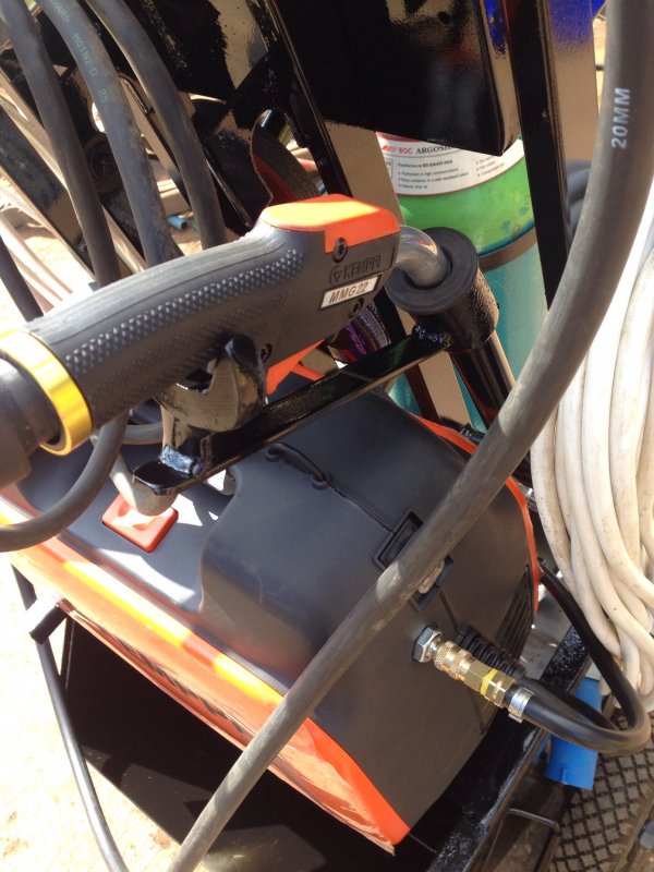

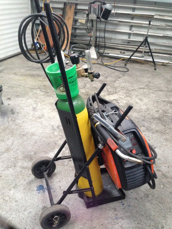

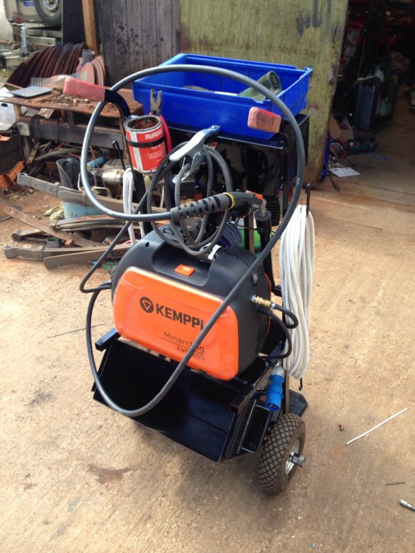

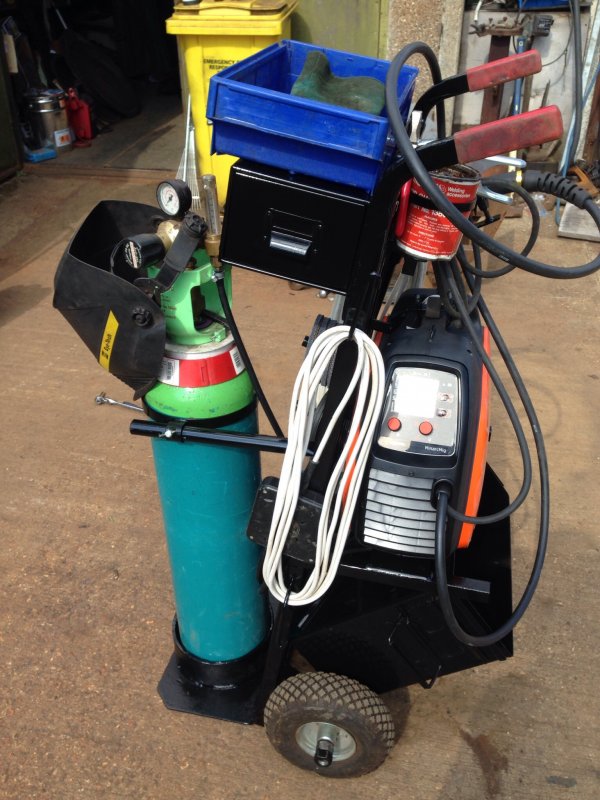

I thought I would share this as it may be of use for some ideas as most of the welding trolleys made are for the workshop. I made this out of an old sack barrow and some bits laying about and changed the wheels for pneumatic one,the only reason so I can drag it out in the yard easily. I also hard wired the trolley and it includes an extention lead to run grinders so no more knotted cables, not sure how long it will stay this tidy tho
