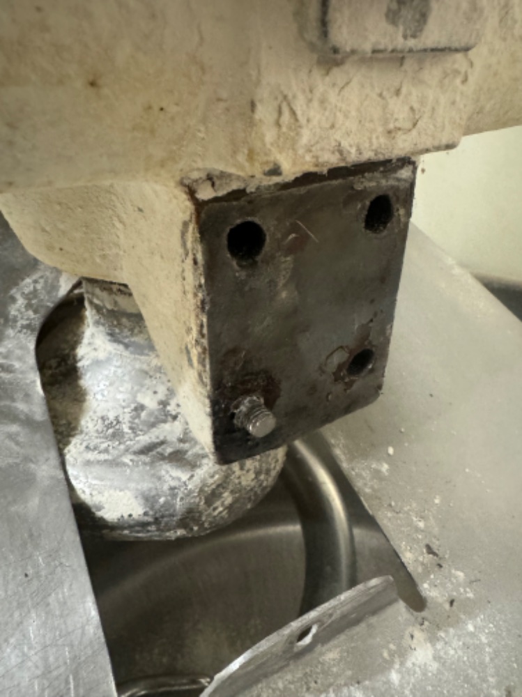

Currently considering how to open up the shagged holes with a 14.75mm drill.
Will have to turn it on the lathe to make the drill a reduced shank.
I could use a piece of steel plate and mount the rotabroach as I have one hole which still has some good threads. But I'd also need to buy a chuck adapter.
Machine is irreplaceable and already been helicoiled once so needs to be cock on.
Won't last mate. This mixer does 150kg of dough at a time with a 15hp motor.On cast iron I'd just fill with epoxy. Gaffa tape if it's a vertical surface to stop it running out.
Once it's cured locate the center, pilot drill, then a counter-sink until you've a good mm or so into metal. Drill bit should follow in ok from that.
Thin Wall m10 is a 14mm external thread, Thick Wall is m16
These four M10 bolts are where the bowl scraper attaches. All the power of the mixer and weight of the dough pushing against it.
Ah I see what you're saying good ideaNo, just use the epoxy to fill the hole so you can re-drill it.
Then tap and fit an insert.
I instantly thought of epoxy as well. Metal filled like JB Weld. Perhaps even glue in the helicolis to stop them vibrating loose.No, just use the epoxy to fill the hole so you can re-drill it.
Tried green loctite last time. Didn't provide a permanent solution it seemsI instantly thought of epoxy as well. Metal filled like JB Weld. Perhaps even glue in the helicolis to stop them vibrating loose.
These helicoils have lasted two years so they do work. I just don't think they're the right tool for the job in this application. Soft cast iron with bendy stainless bolts that then shear once they've work hardened.That is where I am - stepped studs made on lathe - drill go bigger with thread.
Or make your own "keenserts" up on lathe - M16 or M18 outer and just loctite it all together.

The casting is so large you'll never get the heat into it to TIG braze.Thats 3yrs... Which is enough for a new expensive car - let alone a few repair bolts in a "dough mixer"
What about filling the holes up with TIG braze and drilling and tapping them. All least if it all fails in another 3yrs - you can rework it...!
