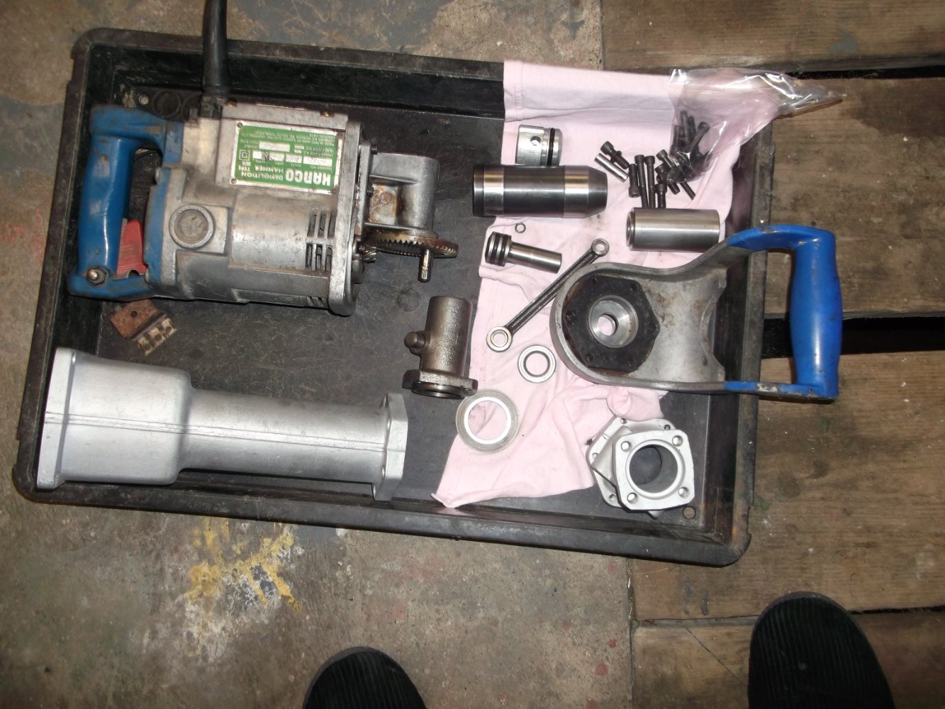

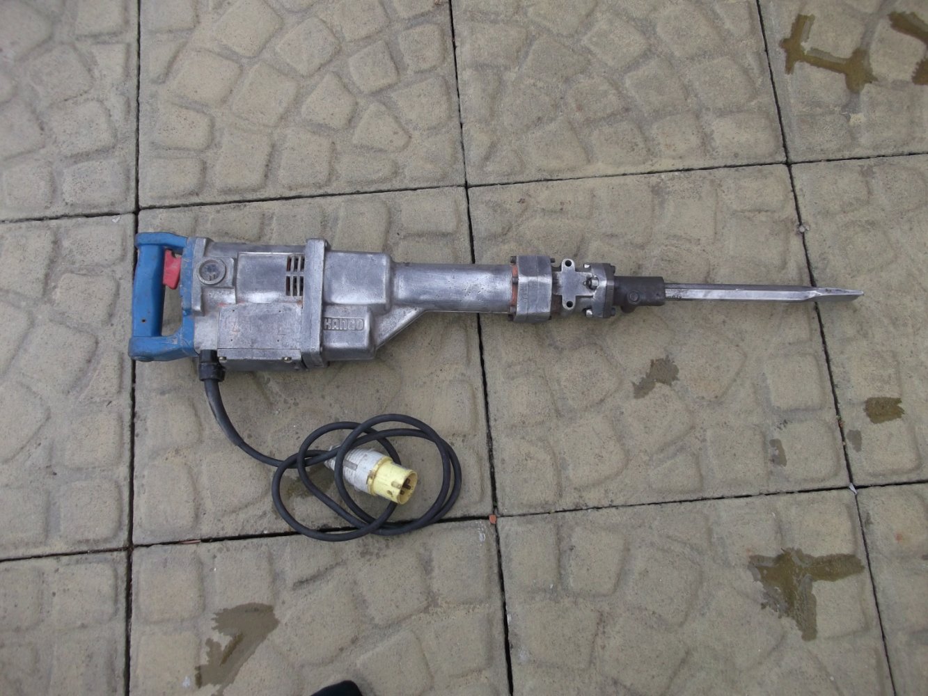

borrowed my mate it for a couple of weeks and needed it back to take to bits to see where everything went on my other one thats been in bits for donkeys years
to be honest i dunno how it was still working .the flex strain sleeve was bust wire hanging out and just taped up hal;f the screws were missing the chissel holder was just hanging on with loose bolts and stripped threads along with hardly any grease in it and the piston o rings were hard and one broken

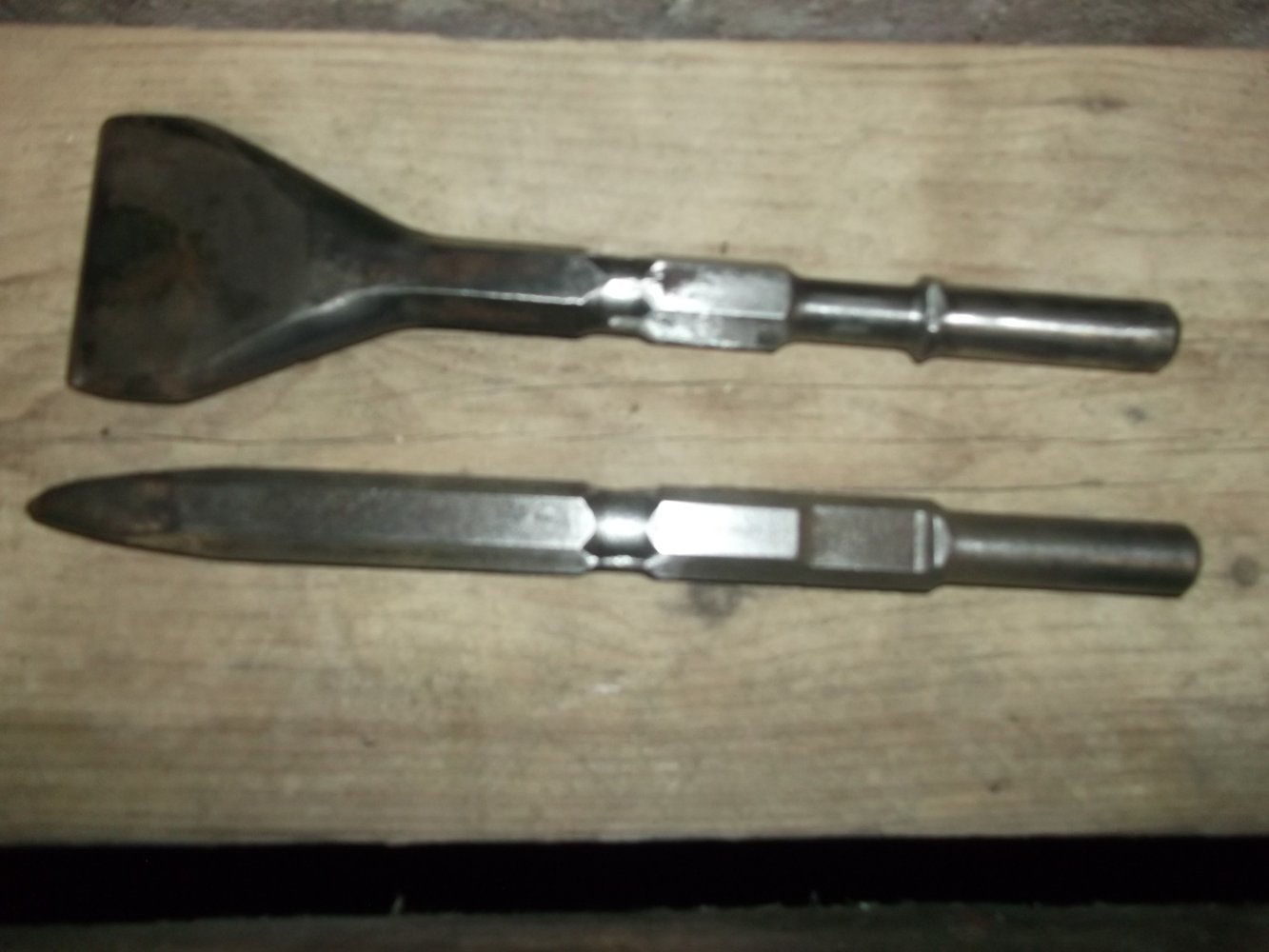

replaced all the missing screws renewed the nuts and bolts using locktite to stop it falling to pieces new flex restraint greased it all up and a kind member knighty gave me 5 chisels for it and even delivered them for me
so all up and running now just have to put the other back together now . waiting for some c clips for it and a couple of cap screws and a new plug
