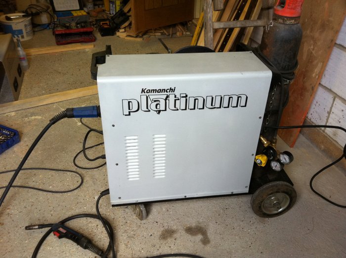

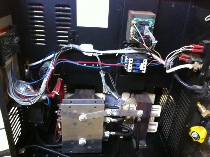

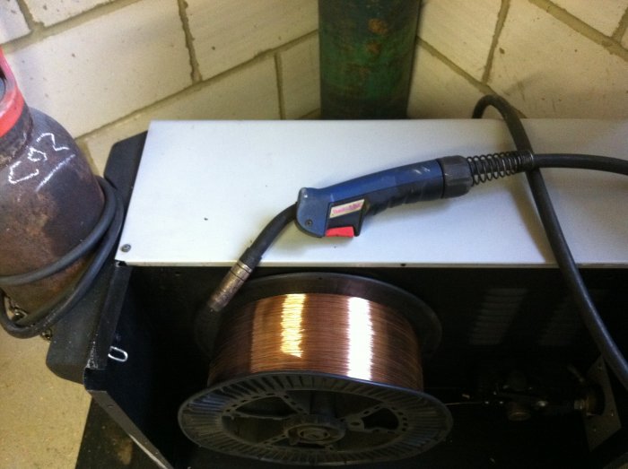

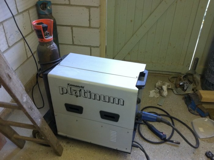

Hi all brought this the other day dont laugh £100 inc wire regulator and cheapie auto mask cant find much about it .

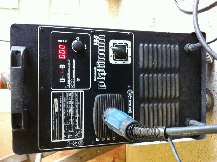

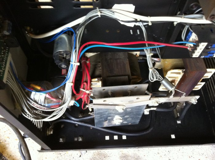

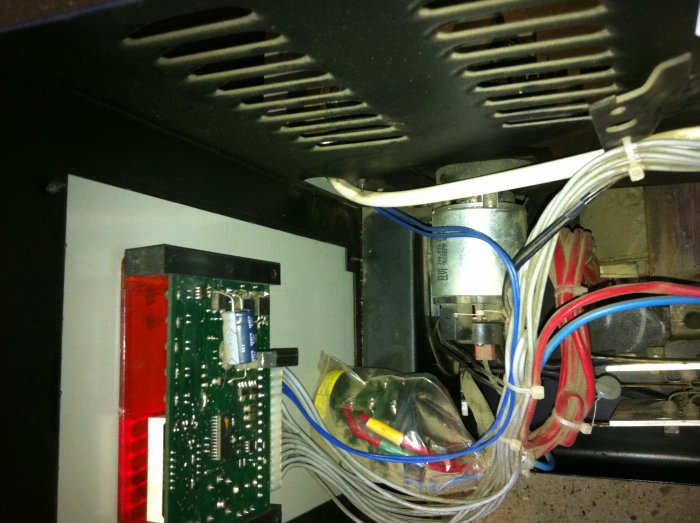

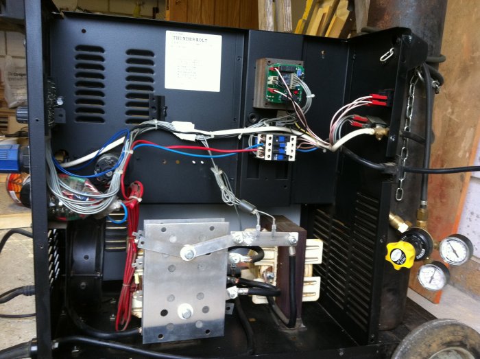

The encoder was loose it must of had a knock and the rotary switch was away from the pcb but i managed to refix the metal clips it and it is all functioning ok transformer is copper wound but thats all i know about it not sure of amps etc.

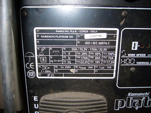

States 170amp @ 20% And 25amp @ 15.2v to 170amp 22.5v
I measured the voltage between earth and tip of torch with wire feed loosened and trigger pressed and it varied with the eight setting control knob 28v on 1 to 48v on 8
