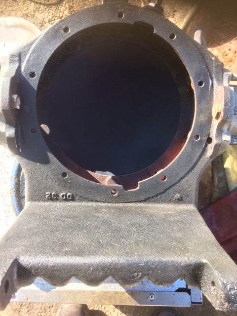

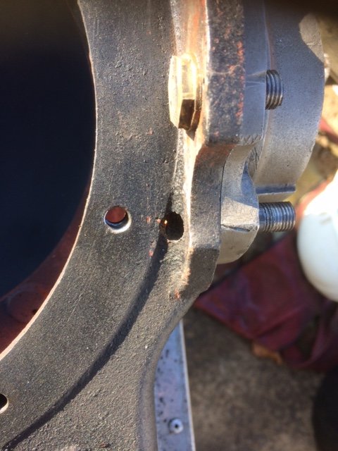

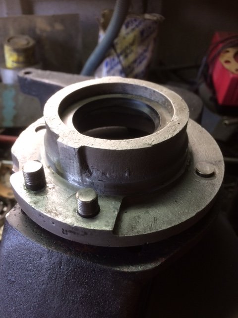

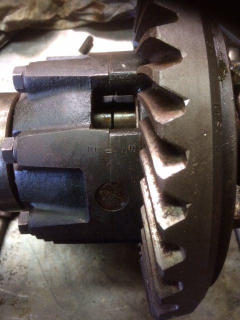

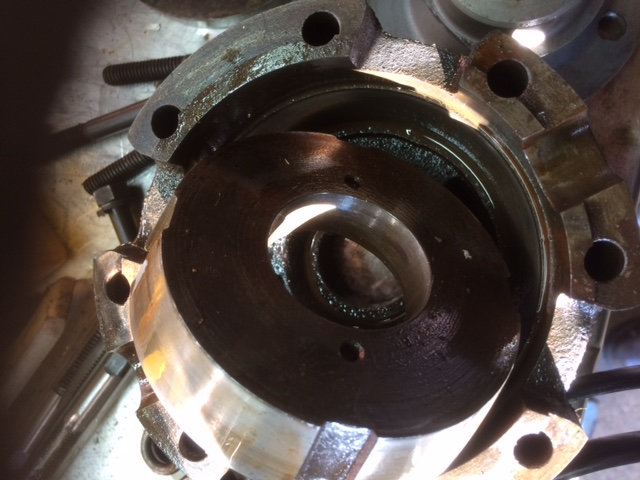

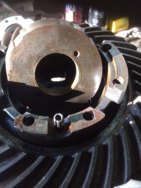

Morning all, Houston i have a problem. I have been sorting out this butchered magnesium diff case for a 1956 lotus (big surprise there) It was taped originally in BSF threads. which have had a brute on them so i have helli coiled to repair them and made a load of studs. I do not like winding bolts in and out of alloy casings i always fit studs when ever i can, But i noticed this hole where it has been drilled deeper to try and repair damaged threads in the past. I am looking for advice on repairing it should i try and thread and plug of rough it up with a dremel and Devcon it. The repair is needed on the third picture.
