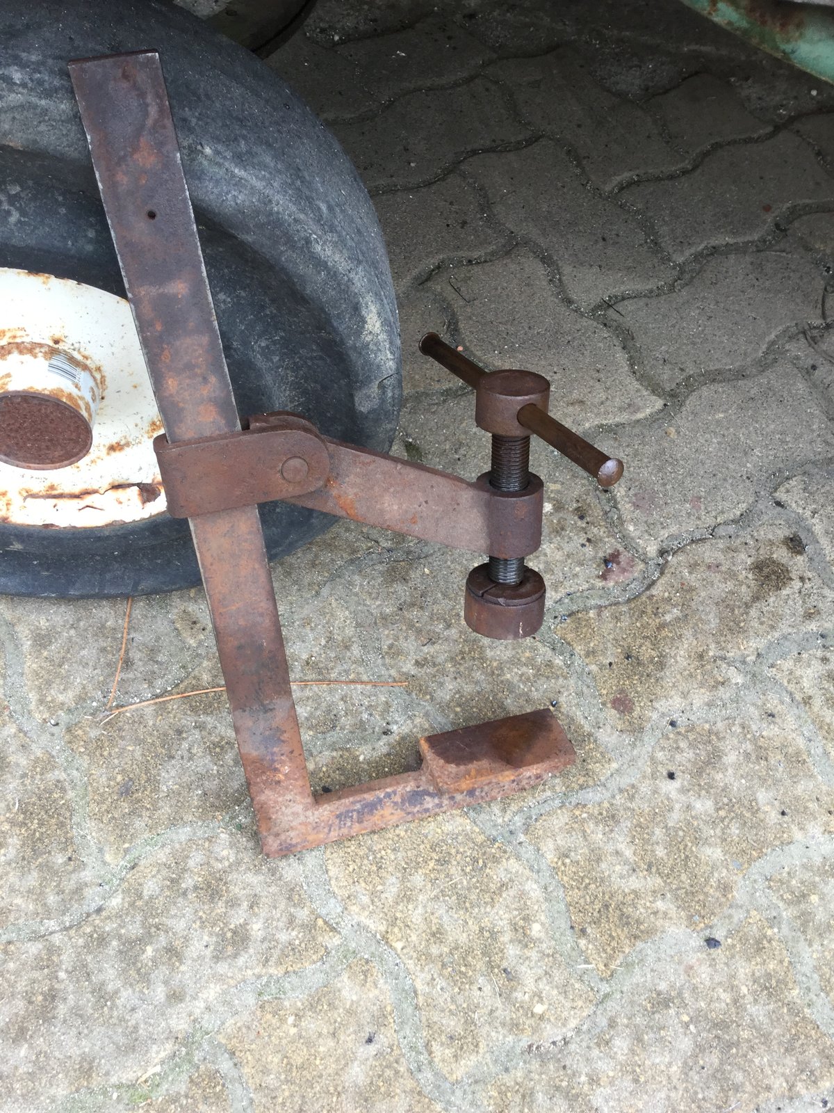

found 4 of these at a car boot....home made but just lovely.......
been wanting somthing similar for ages but just made do.......
the 4@ £20..bargain
for anyone who wants to copy them
body is from 10mm plate,
height 500mm,
width to center of screw 180mm,
thread 22mm dia....

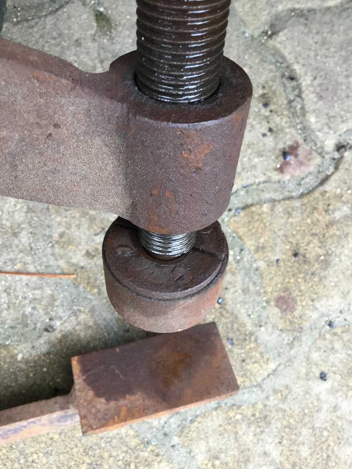

u'll see that the horse shoe collers retain the screw ball......(4 screws).......
and a 10 degree down angle on the arm.....
