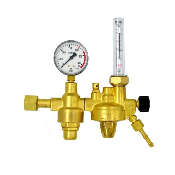

Hi,
I've acquired this and wanted some expert knowledge of its usage.
W252-8061 2RBArg-0,15R
Regulator type - 2RBArg/KW-0.15R / W252-8063
Gas type - Argon / Carbon dioxide
Thread intake - W 21.8 x 1/14″
Nominal inlet pressure bar [MPa] - 200 (20)
Rotameter pitch range [dm3/min] [m3/h] - 5 – 20 (0.3 – 1.2)
Output pressure bar [MPa] - 1.5 ± 0.07 (0.15 ± 0.007)
Thread/Hose nozzle [mm] - G 1/4 6.3
I've currently got an argon shield tank (I can't remember the letter #) I'll check if needed, it's on the BOC Volk deal.
Would this work, with the flow tube on that mix or is it for pure argon?
There's nothing I can find in English, there is a Polish Product Data Sheet here.
