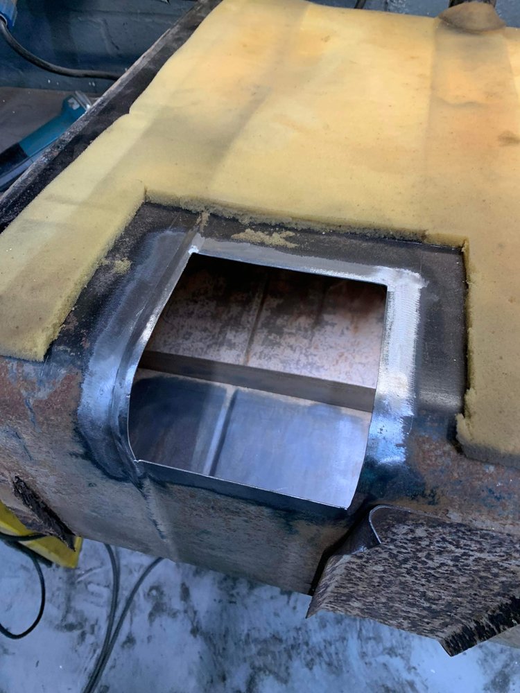

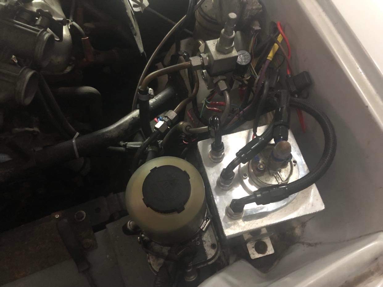

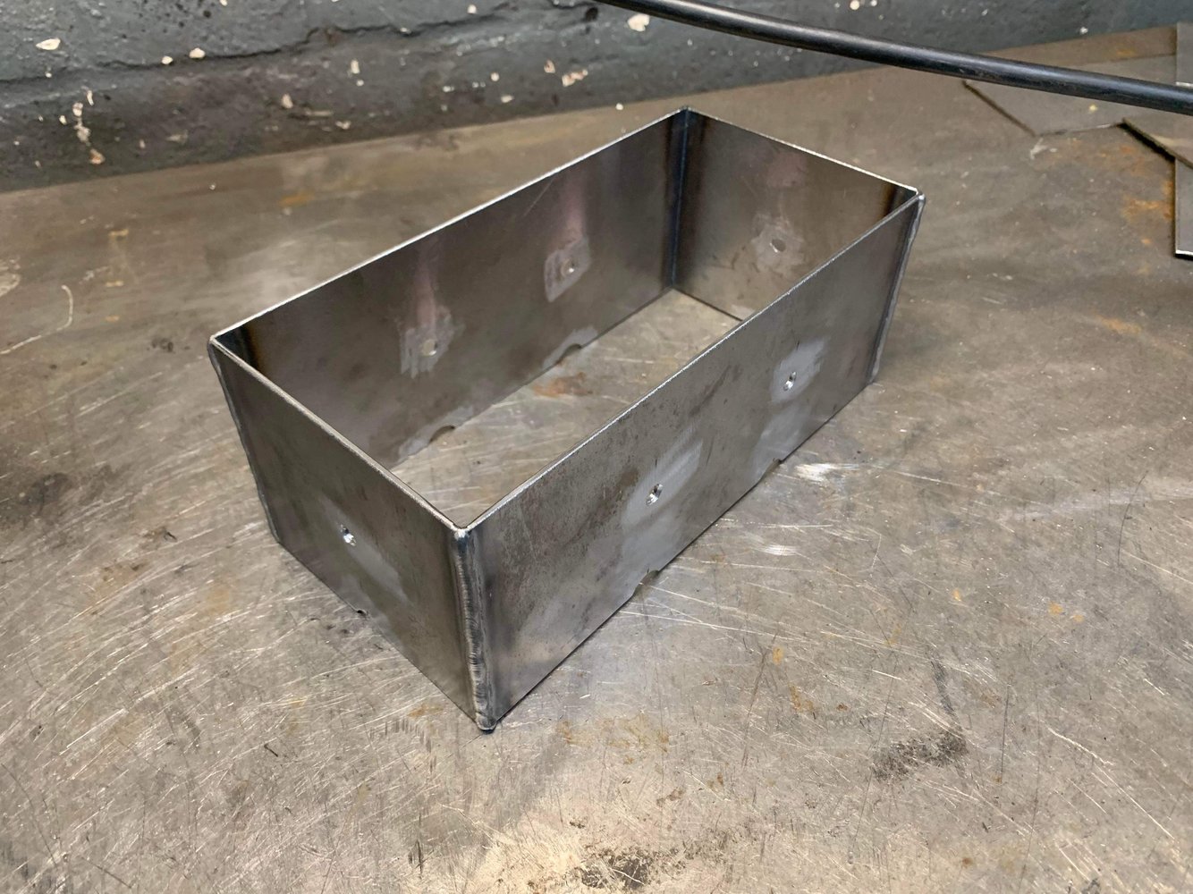

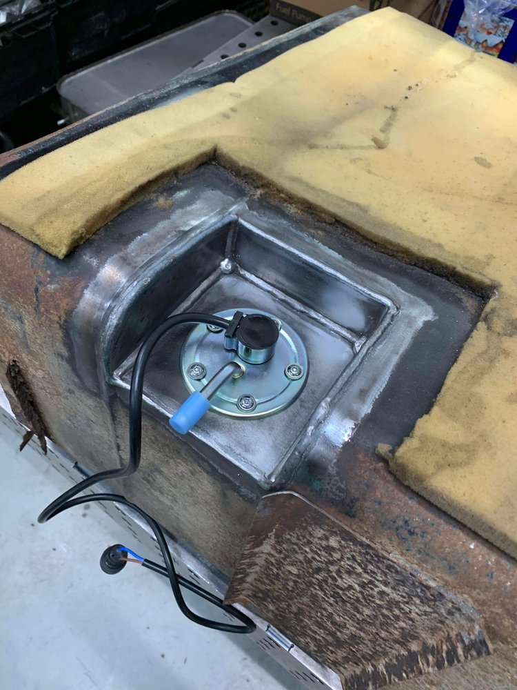

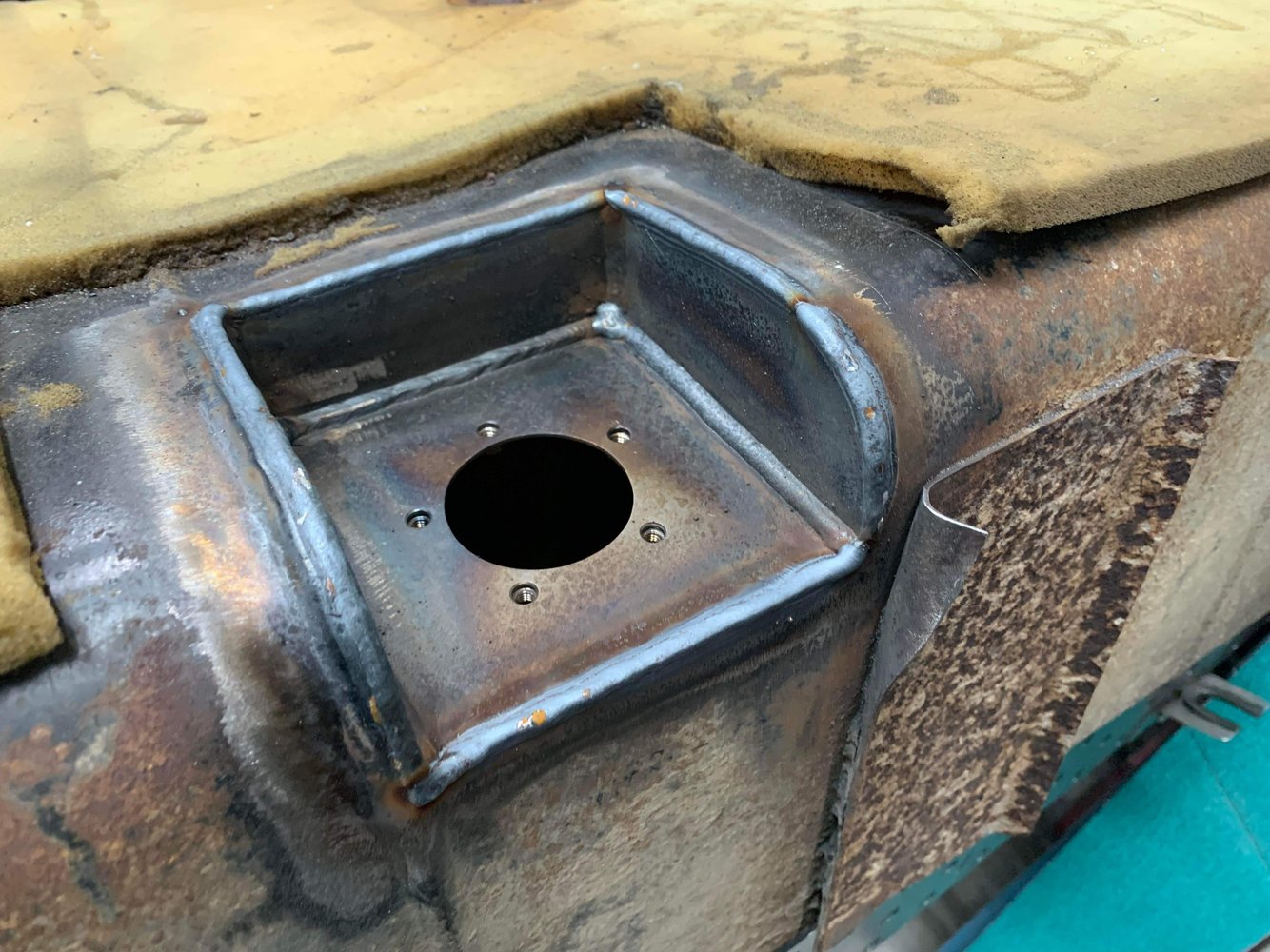

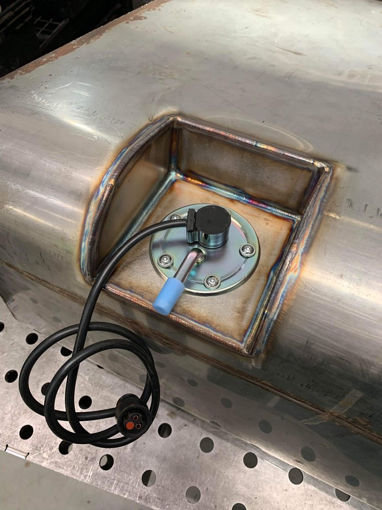

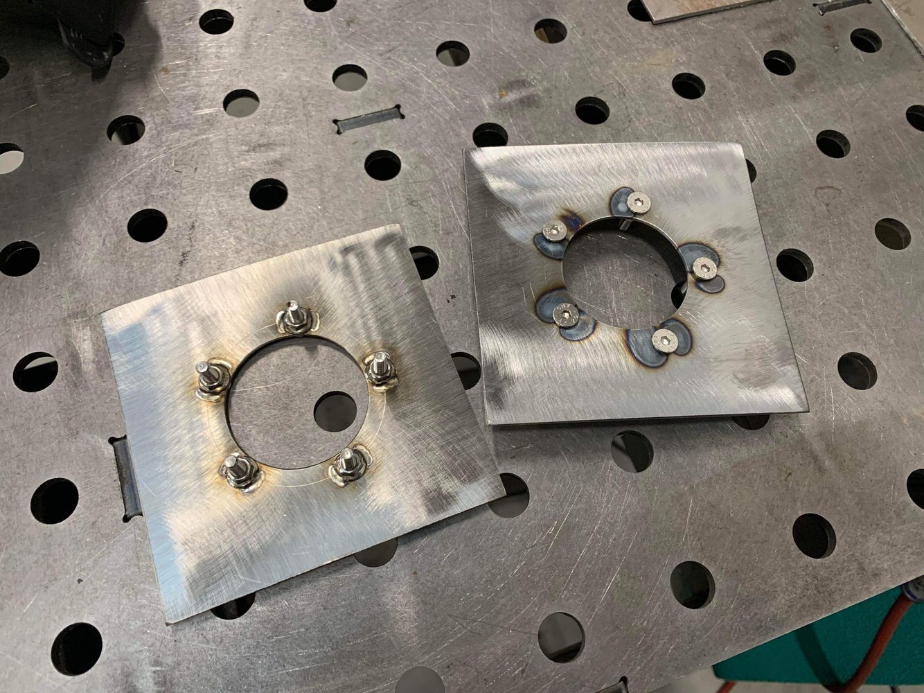

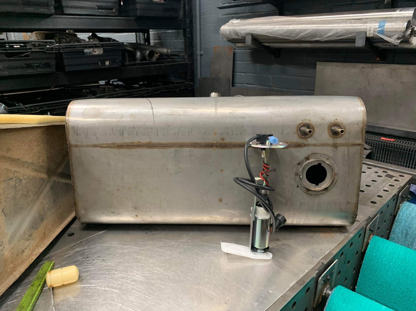

This was done for 2.9i conversions to two Scimitars in at the moment. They are to replace a terrible swirl tank installation on both cars, one of which is here..

Just be careful your cork gasket uses a nitrile binder, or you'll be back to square one again.Nice work on the tank
these pumps often come with a metal sealing ring coated in green gunk. if you are fitting the pump with one of these then I suggest you take it out and throw it away and replace it with an original cork gasket. Because
1. it will stand a better chance of sealing
2. it won't drop loads of bits of green gunk into your fuel tank
The last one I fitted returned quite quickly with a complaint about fuel smells and when I investigated I found the bits of green stuff floating in the tank
It does. The return feed is the other side of the tank.I thought an EFI installation would require a return pipe as well as the feed pipe coming out of the pump.
Out of curiosity, what is so terrible about that setup?
A) It stops the spare wheel being stowed in its factory position.
B) Having all that fuel system next to the engine is a fire risk.
C) It is expensive and looks appalling.
Mind you it is not as bad as the other car... All that swirl tank and pumps assembly is inside the car, with pipes running in and out of the body!
You don’t need a return, a few slightly more modern fuel injected engines don’t come with one from factory (rover k series turbo as an example off the top of my head) they have a vacuum controlled regulator just before the fuel rail, which surprised me…I thought an EFI installation would require a return pipe as well as the feed pipe coming out of the pump.
another reason for this is a high pressure pump on the engine itself feeds a rail that regulates back to the pumps feed pipe hence no need for a returnNice work, looks like a neat install.
