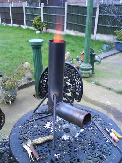

U ukracer Forum Supporter Messages 17,916 Feb 25, 2016 #1 "made a rocket stove today and its very efficient. It just burns small sticks and makes a lot of heat. Going to make a grill to hold a pan tomorrow." The guy on facebook posted the above with the pic below. Is this really a rocket stove??
BrokenBiker Forum Supporter Messages 13,153 Location Newport, South Wales Feb 25, 2016 #2 i would suppose so, pack the sticks in from the top, light from the bottom. combustion will drag air in through the bottom and intensify the burn. very simple design, i like it
B bump Electricity is great! Messages 1,595 Location Leicestershire / Northamptonshire boarder Feb 25, 2016 #3 In a manner of speaking yes. The design below is more common for cooking. Insulation being the key.
gaz1 Member Messages 20,663 Location westyorkshire Feb 25, 2016 #4 theres 3 types fed at the side fed in a j tube fed in a batch box feeding a fire often gets to be a pain a batch box method or a bigger area where the fire can get high enough heat is better 15 - 20 mins from cold from hot its faster to cook upon straight up type vortex type heart shape all have secondary air in the mix for cooking 2 pans on it both oven and hob to cook on steel destroys itself after a while
