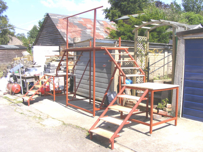

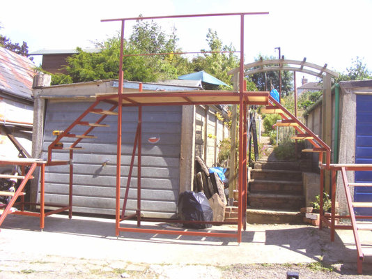

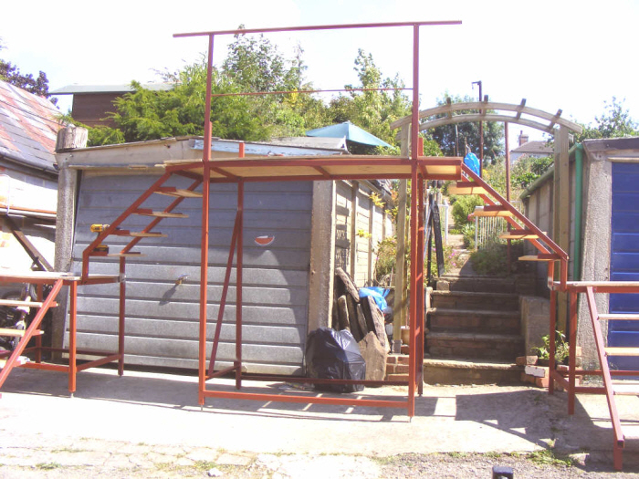

Just finished my latest project.
Its the central part of a stage set for a production of the secret garden.
Each flight of steps is 1 unit, the 2 smaller square frames are 3 foot square, and the central large frame is made of a front and back frame with bolt in bracing so it can be dismantled for storage, the hand rail is bolt on and continues on both sides and down the first level steps. Each point of ground contact has an adjustable foot and it is built to be level on a stage that slopes to the front.
It is made from 40x40x3 box and 40x40x2.5 angle with 18mm ply for steps and floor and was transported on and in my Landy LWB county
Out of interest, anyone got a rough idea what this would or "should" be charged out at? It has taken me a week of random hours but never kept a track
 Ignoring the £200 ish cost of steel
