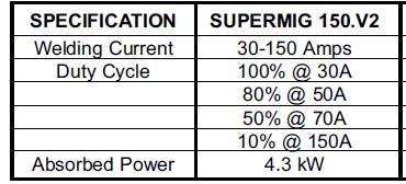

And I was trying to use the Power and Speed Calculator

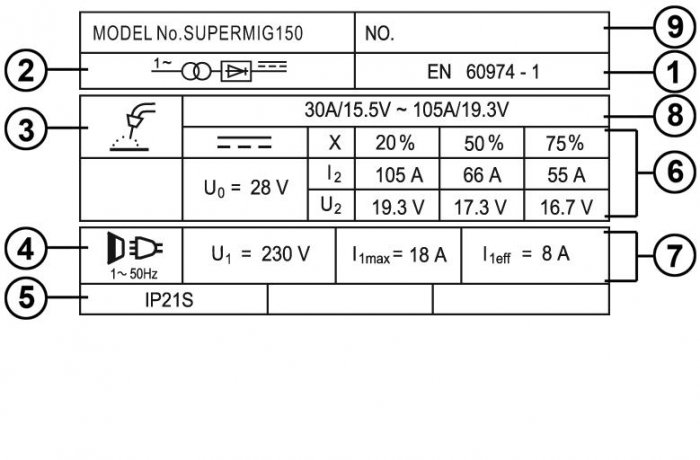

The problem is that the instructions say it is 30-150A but the data plate seems to suggest 105A max.
Number 8 in this image? Anyone know what the real figure is?
