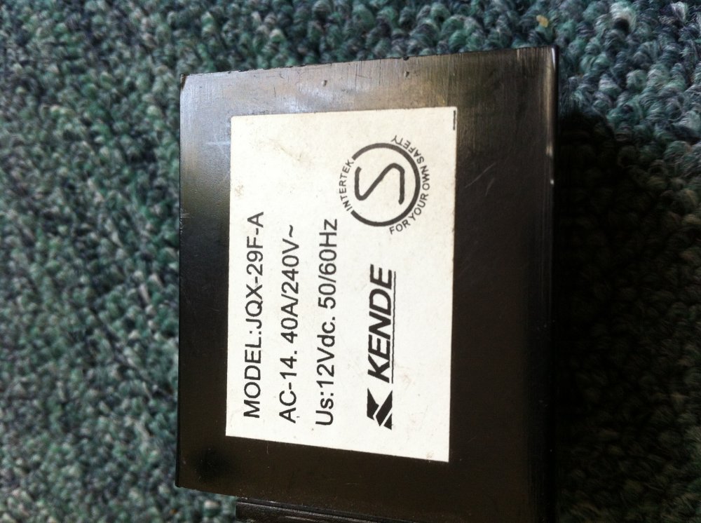

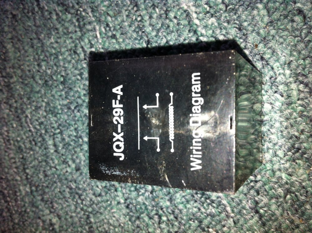

the frequency probably relates to the AC being switched. Just badly writtenInteresting label. States dc then 50/60hz.

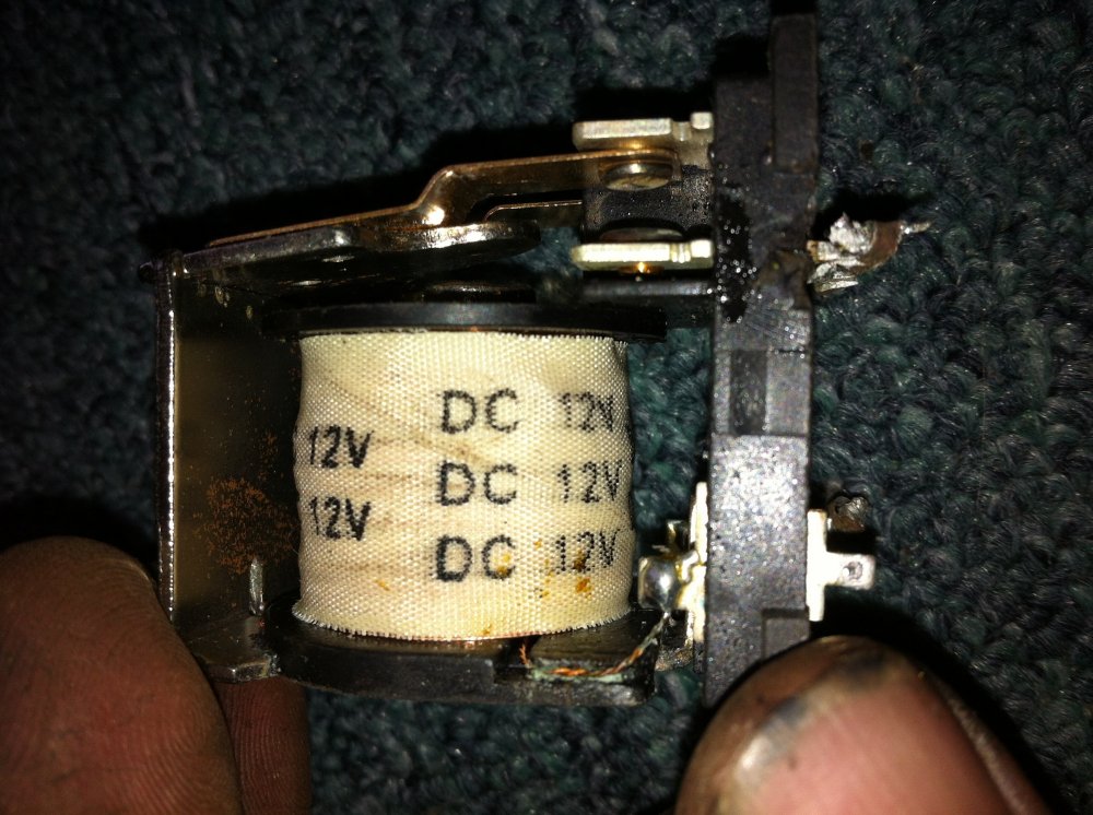

+1Just a boggers 12V relay. The 40A contacts are the issue, you would be best getting an automotive relay to replace that.
just a normal relay that uses 12V dc to activate it and will switch up to 240V 40A.
what is it off?
