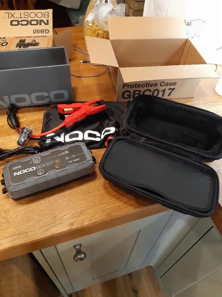

Noco GB40 or go home
On the bus, one assumes, if the car won't start.
