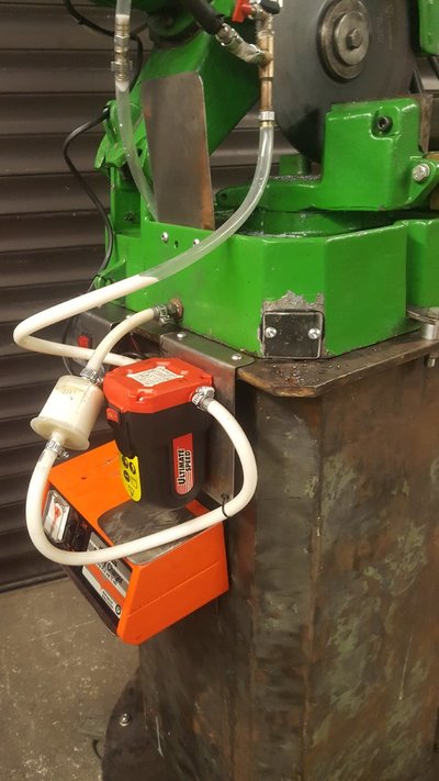

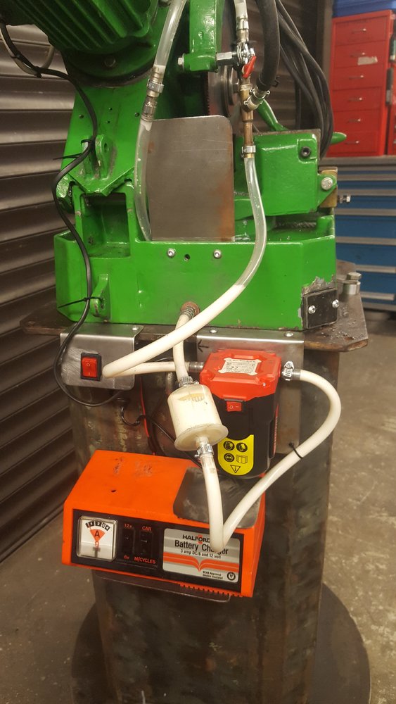

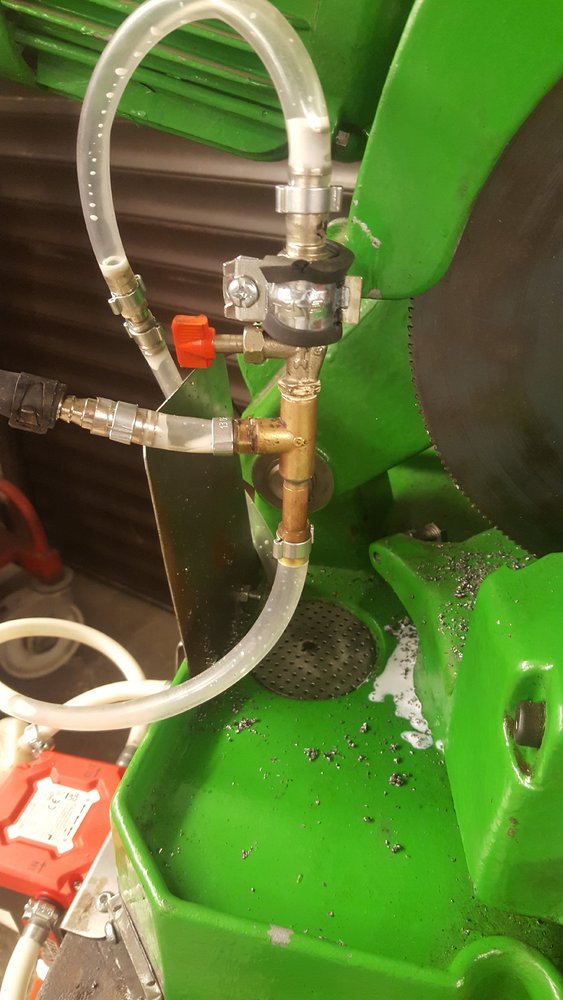

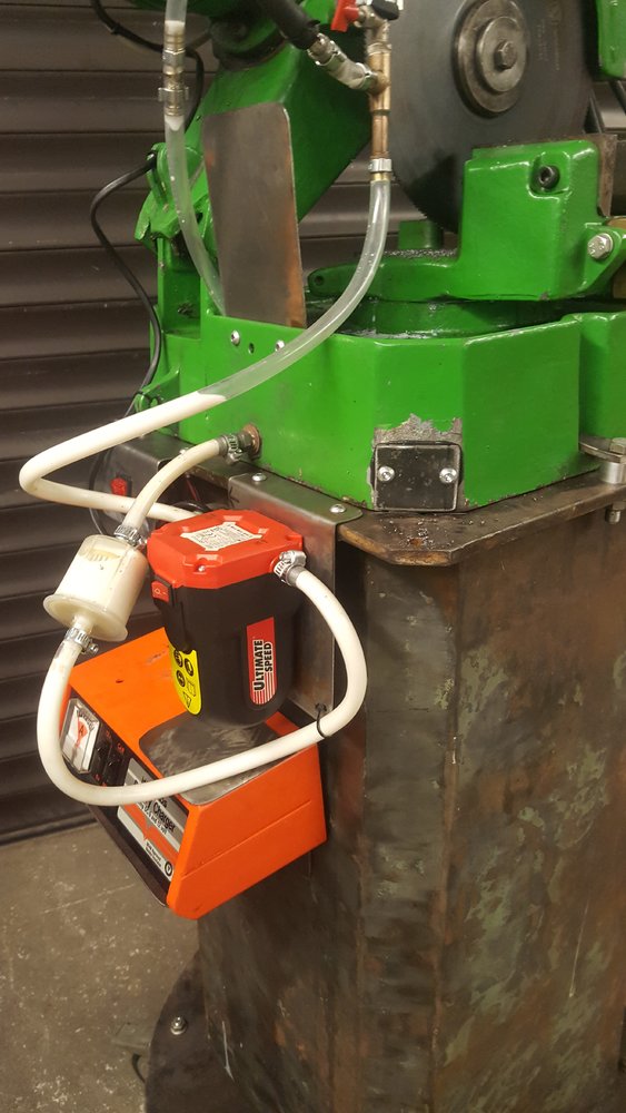

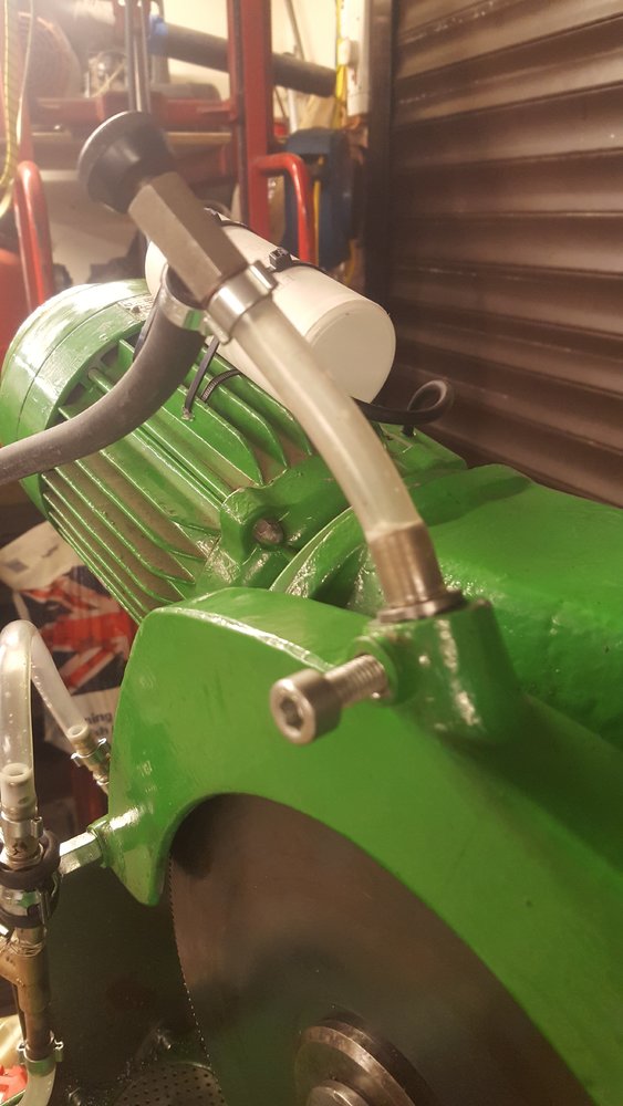

Thanks for the feedback. I wouldn't expect corrosion to be much of an issue in my case as I use soluble cutting oil.I have emptied a car rad with one of mine to avoid the mess when taking the bottom hose off. Ran some waste oil through afterwards so it wasnt sat with water in it. Still working fine a couple of years on
