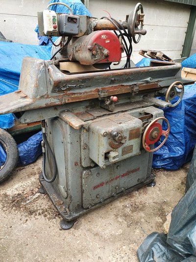

Just collected a 540P in exceptionally good condition. Chap said it was running fine and I could see it working. I was late picking it up by which time he had sold his rotary phase convertor and other stuff. I trust him very genuine chap.
Collect myself as he couldn't palletise for me.
When I first powered it up seemed fine. I heard the hydraulics bubbling away but I realised the spindle and power head feed were reversed so I quickly knocked it off.
Swapped 2 wires around as normal.
Spindle runs incredibly smoothly and the correct way. The power rise and fall head works fine.
But now when you start the hydraulic pump there is a nasty clang type sound and nothing more.
Any ideas anyone?
It is chain driven so maybe that has jumped off? Or maybe one phase is down although my lead/socket works fine on my other machines.
Could he have wired it in a strange way? I thought a rotary phase convertor just gave out normal 3 phase?
Strangely there are 2 isolator switches on the side of the cabinet. Neither seem to do anything - runs with them on or off.
Cheers
