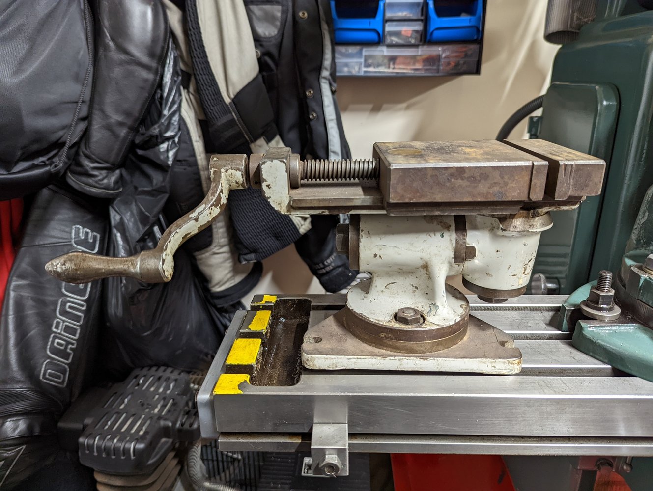

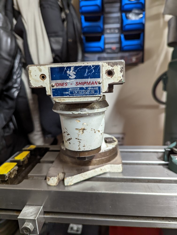

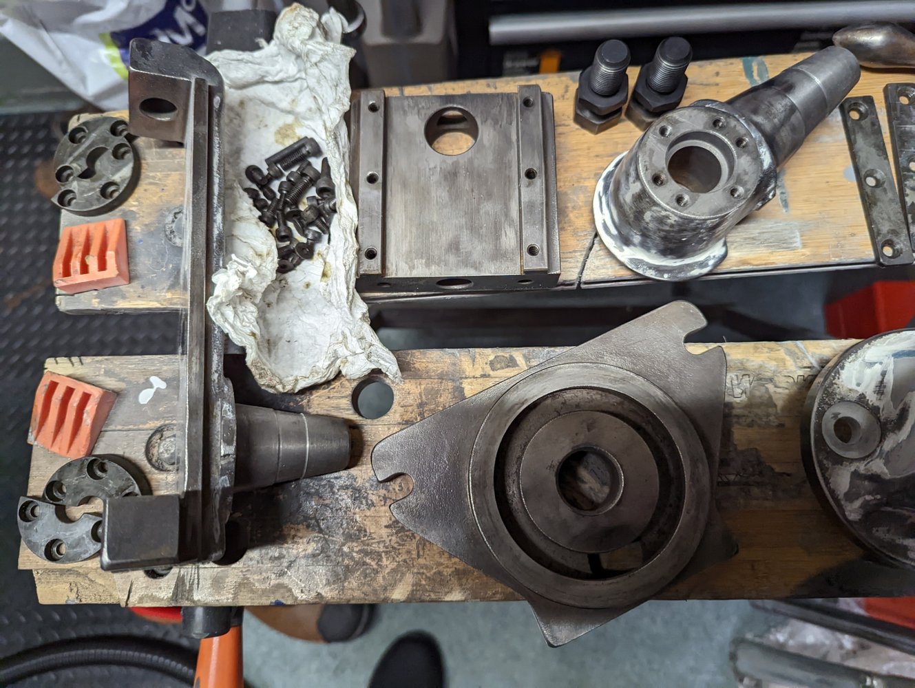

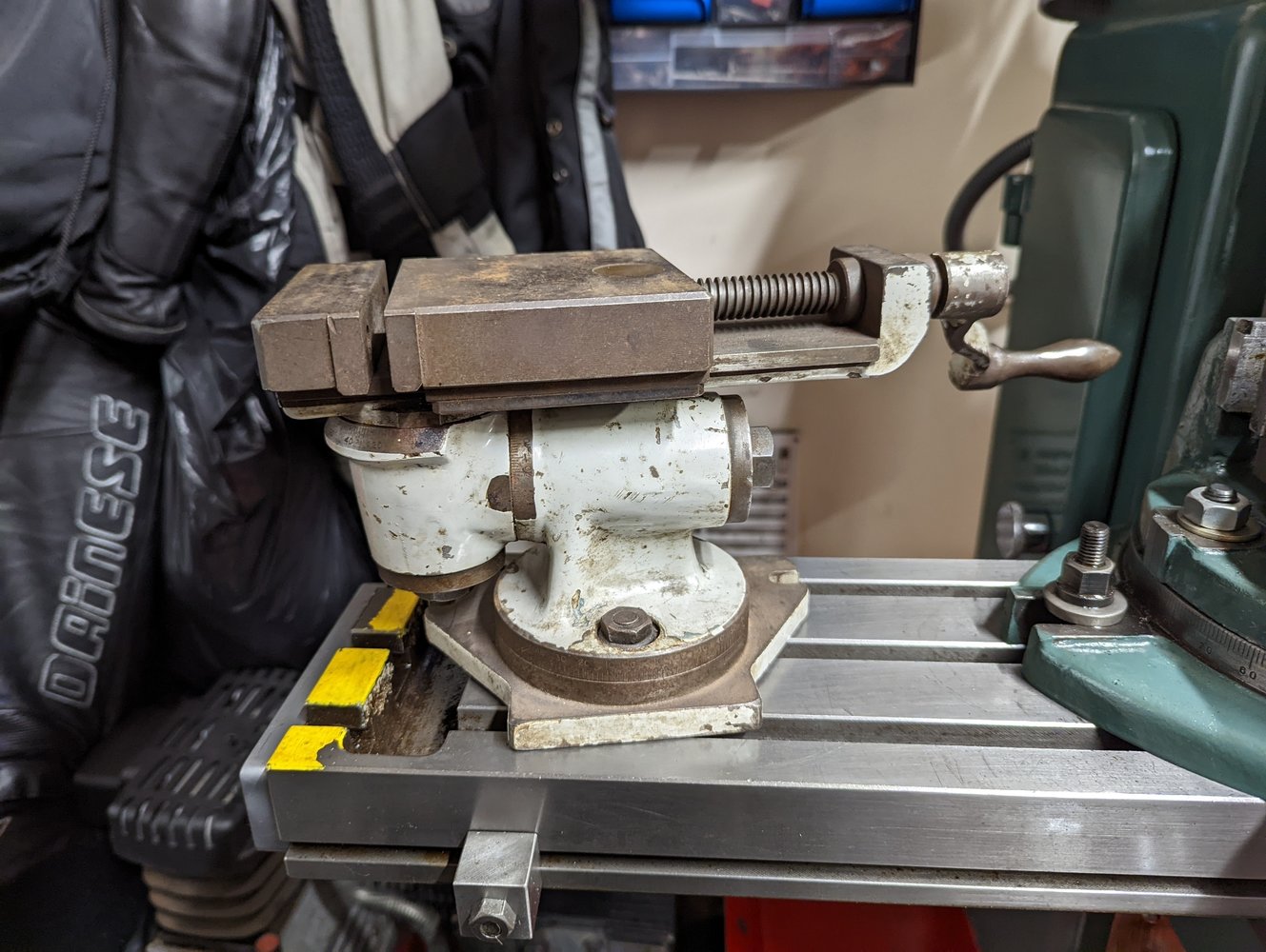

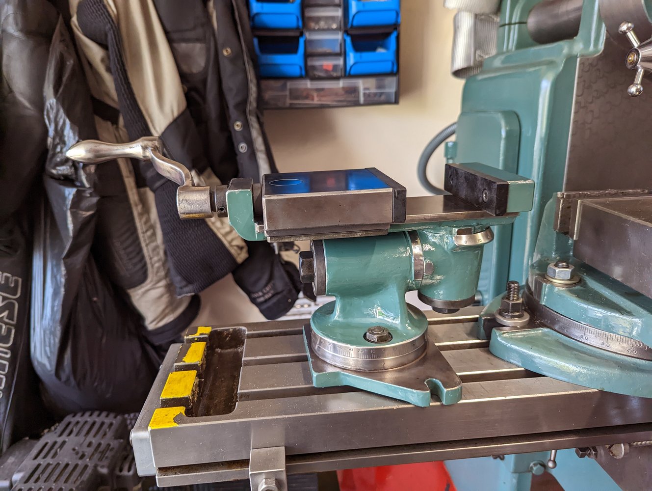

I recently acquired a small vice in pretty good condition, I suspect originally of a surface grinder. I am hoping it will be fine for light cuts on my mill as the locking tapers are quite substancial.
Some minor surface rust from coolant I expect.

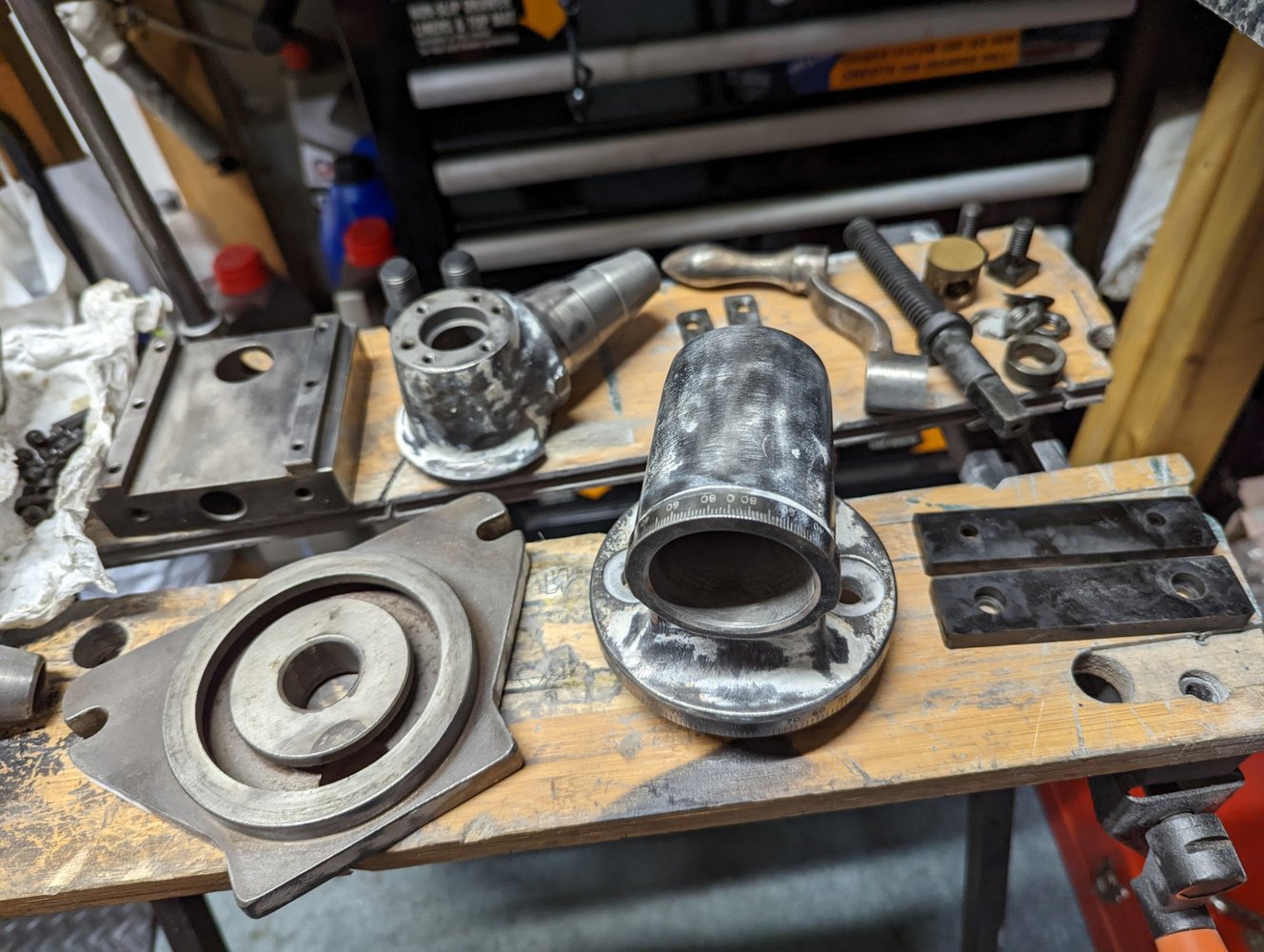

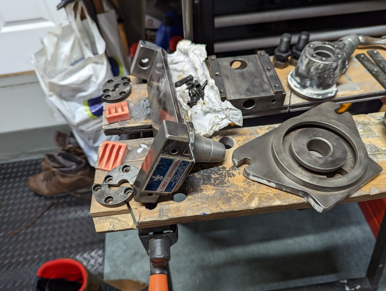

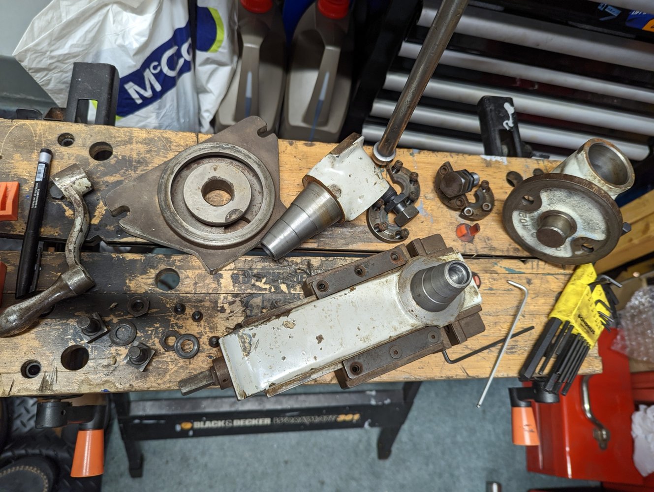

Strip down reaveled some rust staining of swiveling joints:

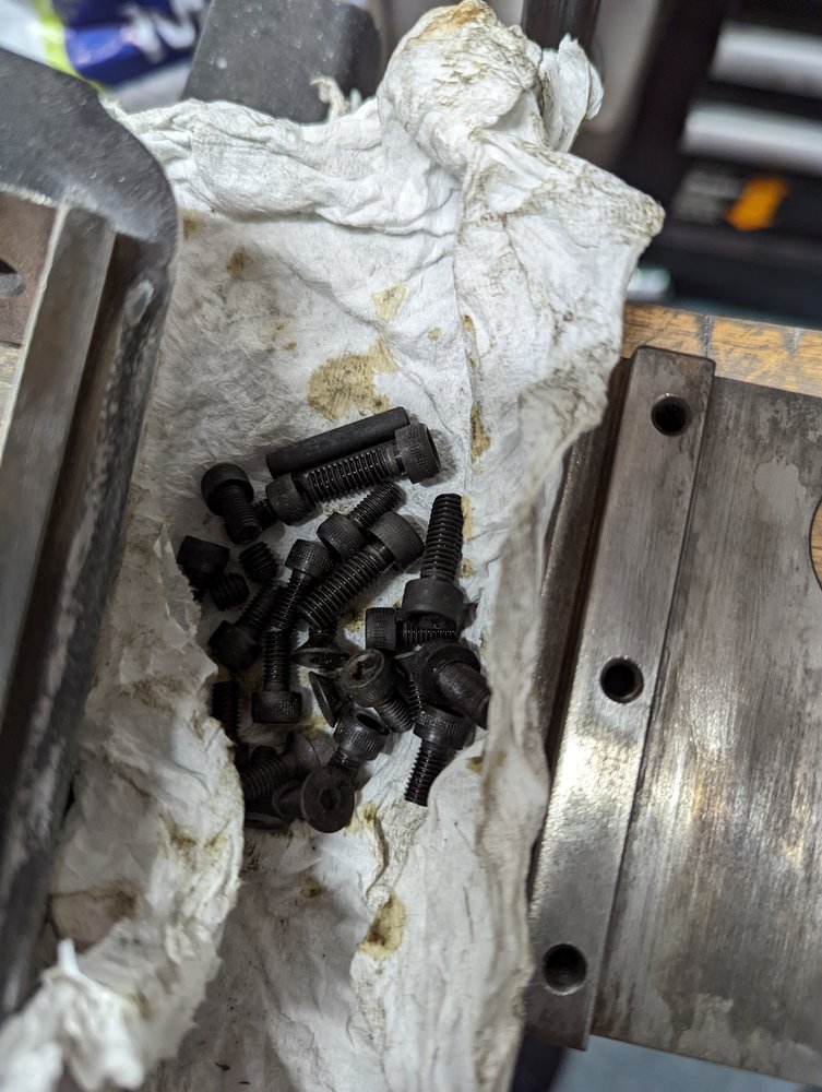

Cleaned up fasteners in hot evaporust:
started cleaning up parts:

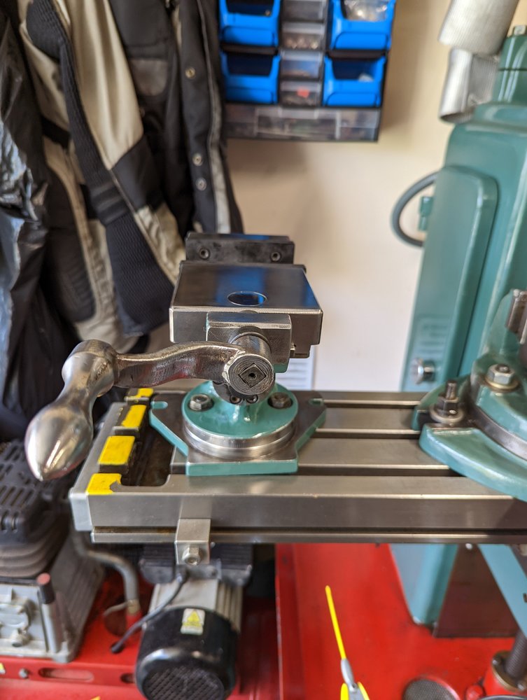

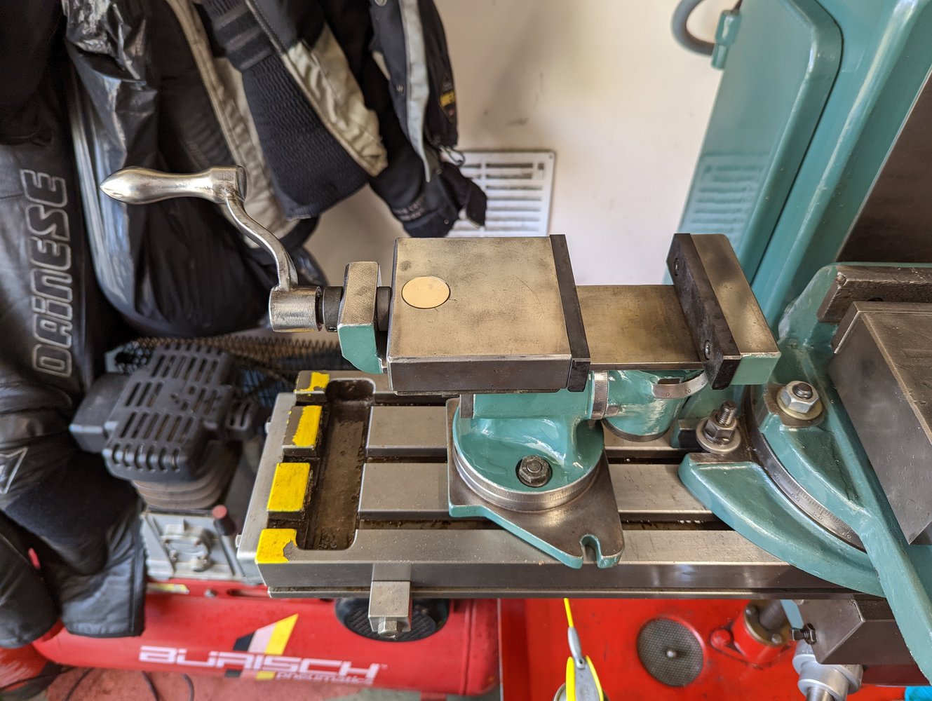

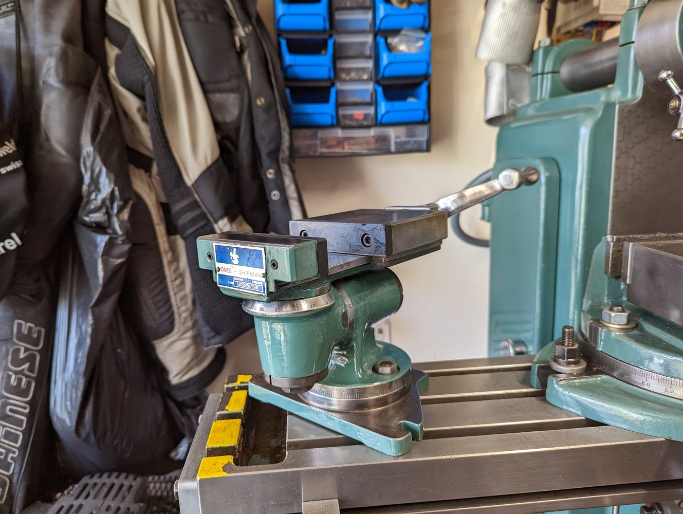

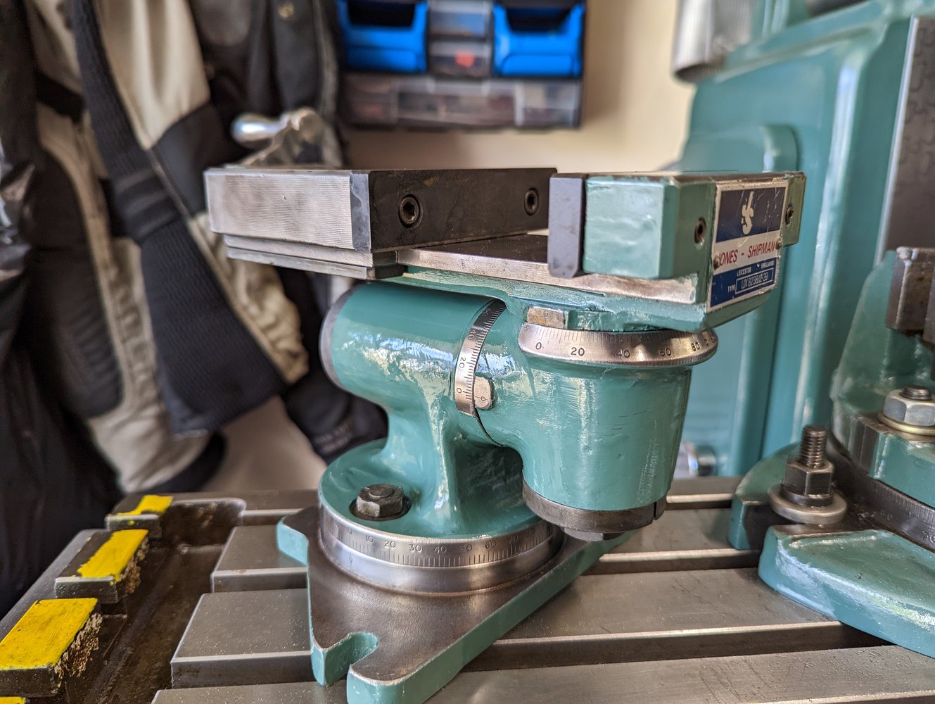

Overall pretty good condition, when cleaning off old paint I see it was originally blue, though am tempted to go with Tom Senior green.
