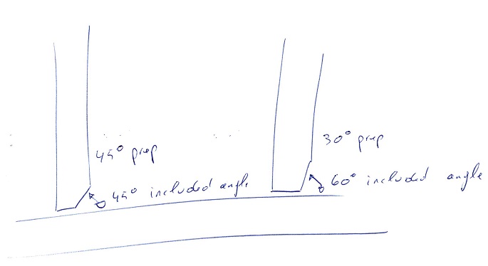

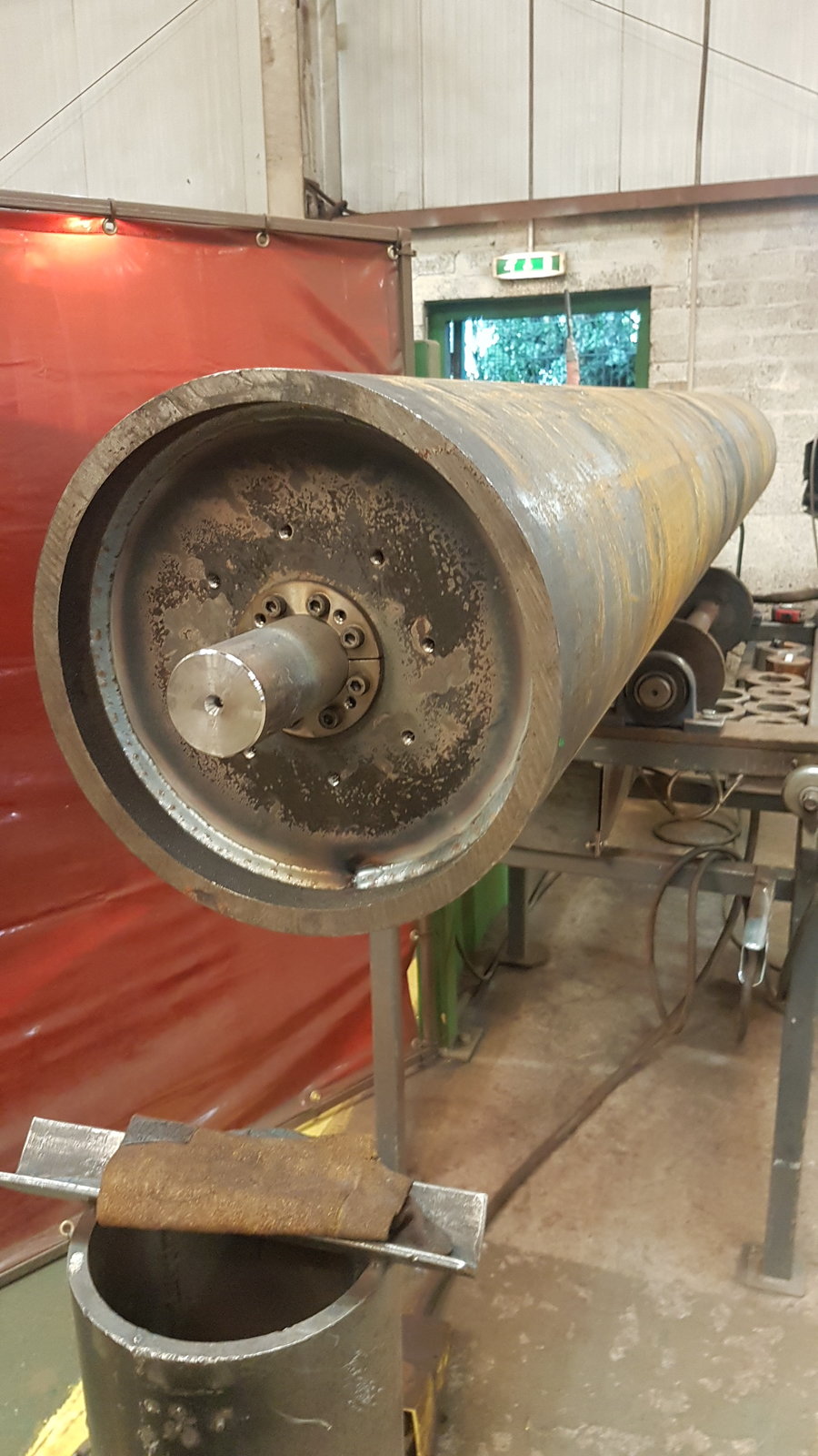

Hi Guys, could someone please help clear something up.
If you have a 10mm thick circular plate of say 300mm diameter, with a 5mm 45° chamfer on the side, to be welded inside a pipe of the same diameter and thickness, (plate sitting in a couple of inches and totally accessible as pipe will be vertical and plate horizontal), what type of joint is that? And what would the ranges be for someone tested to it as per ISO 9606-1.
Thanks very much guys for the feedback.
