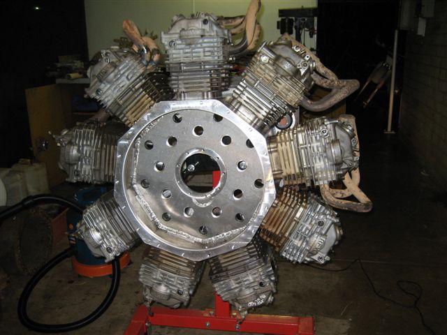

Please don't shoot me down in flames here, as I'm going to do it anyway.
I'm currently trying to join two single cylinder, horizontal crankshaft lawnmower engines to make a 360 degree twin. I've got the joining of the two blocks sorted, however I'm still a little worried about joining the cranks together.
My current thoughts are to bore a 10mm hole, about 20mm deep into each crank and to press fit a piece of 10mm silver steel rod to hold the two in alignment, and then the weld round the journal, before turning and grinding back to size.
I think this should work ok, although I realise that this will put the crank out of true and that I would then need to straighten it, which I am sure I can do, using a DTI and a little brute force. The centre of the cranks can be held by a centre main bearing if necessary, however, if possible not, as it would make my life much easier.
This engine obviously won't have a hard life, as it is really being done to prove that it can be done.
Any thoughts on the above issue.

, what about making up a thick steel sleeve that fits over both crank ends and putting press fit pins through them.
