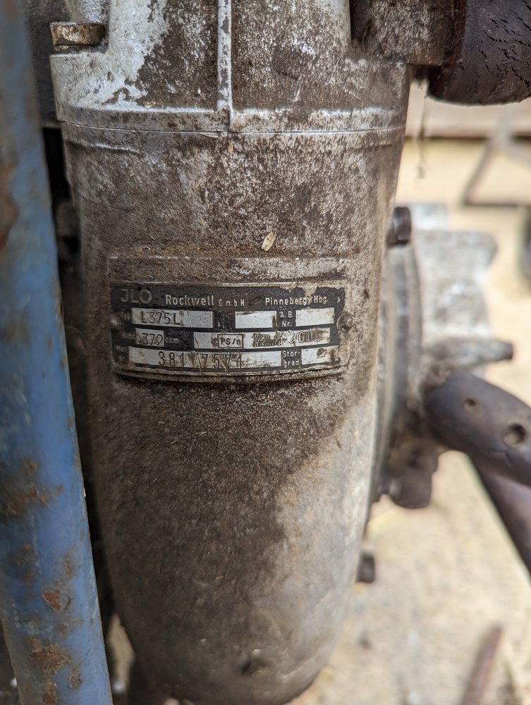

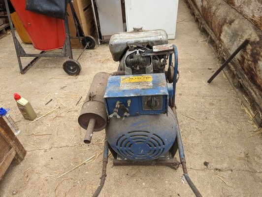

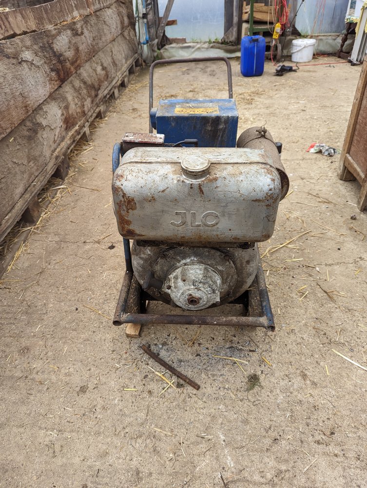

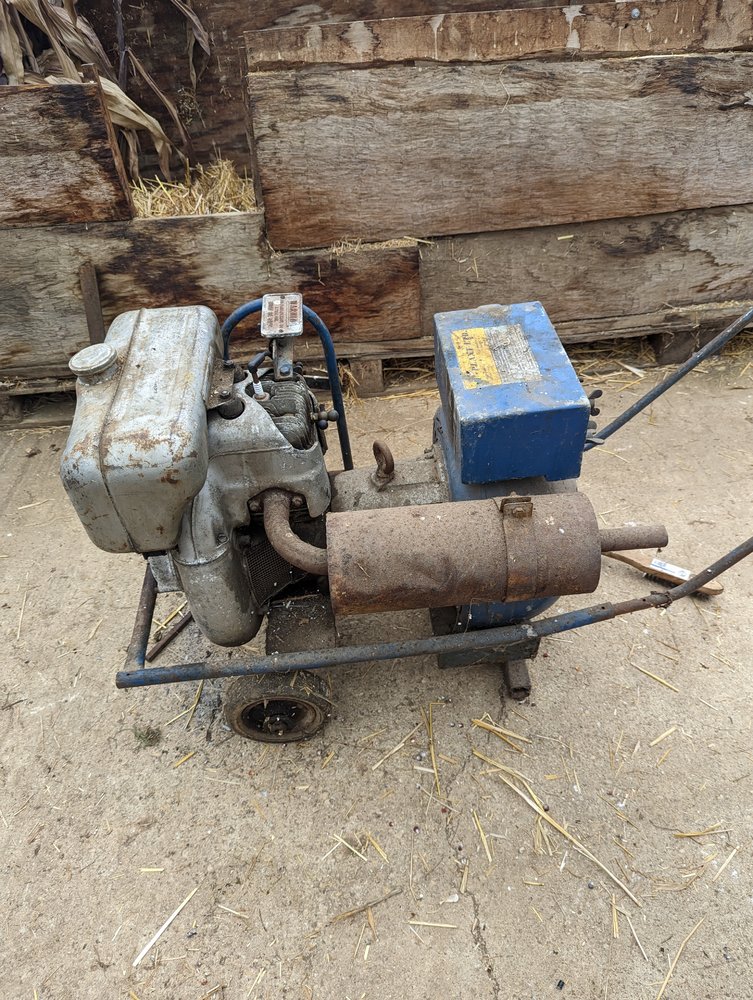

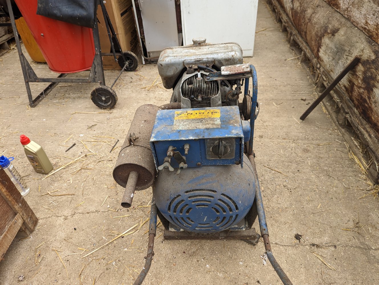

I have an OLD mighty midget with a 2 stroke jlo Rockwell l372l engine. It had no spark - coil was bad. There are no spares, so I rewound it. It now has spark, but given that it is a pig to pull start - the compression is insane (and yes, the decompression valve is open) I want to check the points and timing.
I would be really grateful for any specs (point gap, plug gap, timing) for the engine.
Thanks
