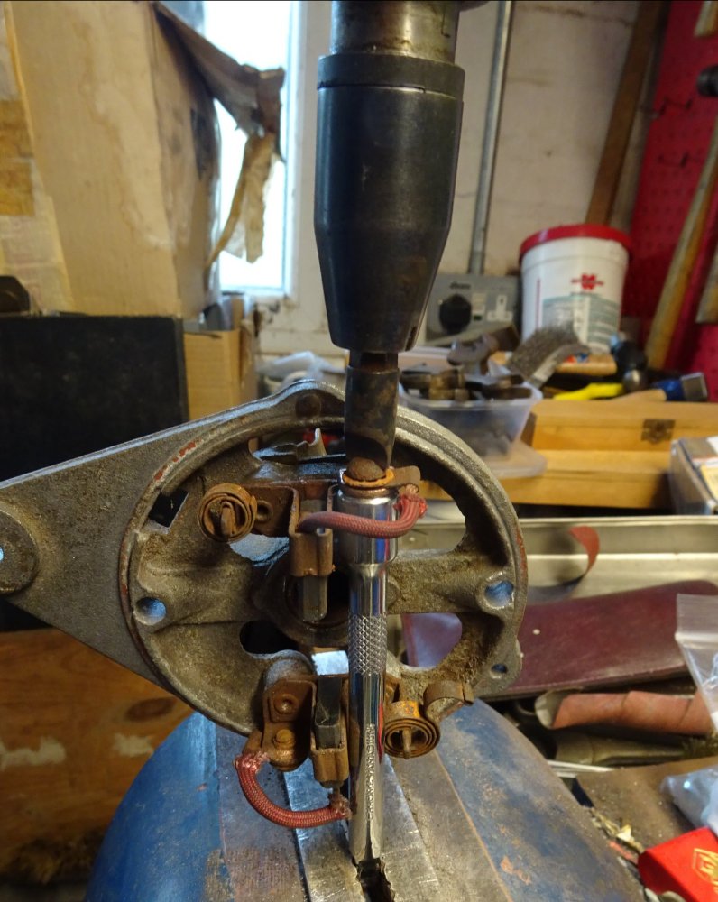

Another tool you didn't know you neededis a Shake N Break which uses an air hammer to provide the percussive force while while you control the rotation with the side bar.

I made one of those out of a broken Pozi screwdriver & a air chisel bit, it worked ok, until I broke the shaft of the screwdriver.Another tool you didn't know you neededis a Shake N Break which uses an air hammer to provide the percussive force while while you control the rotation with the side bar.
