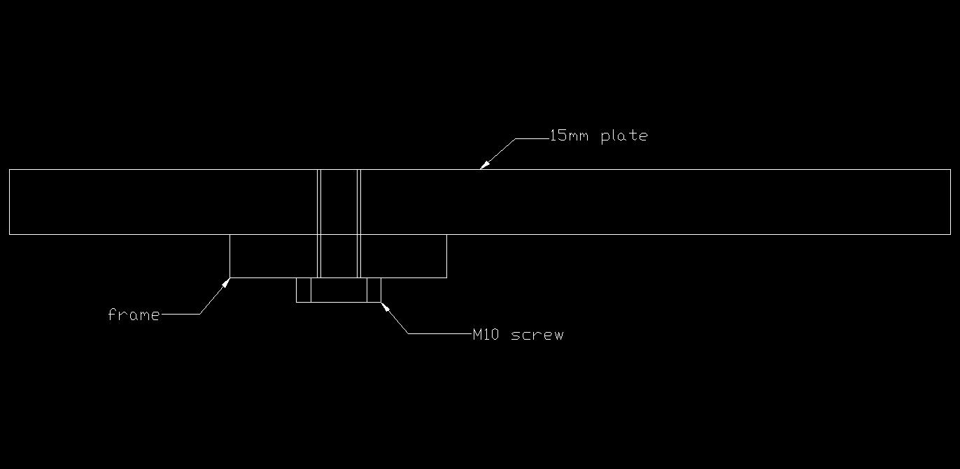

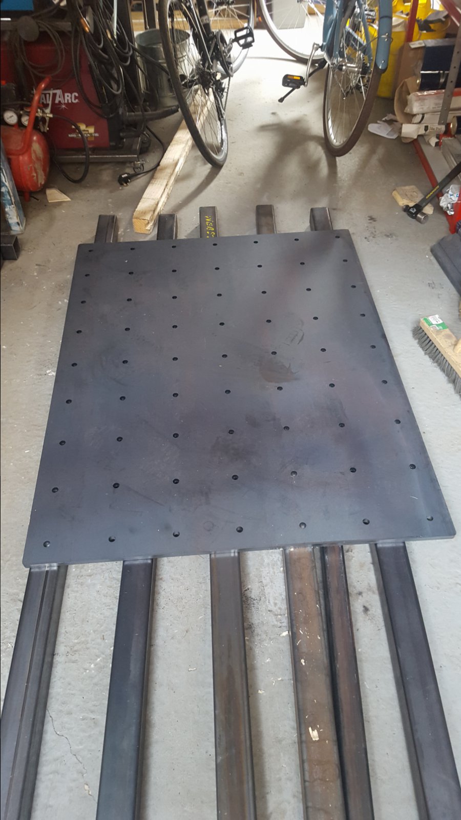

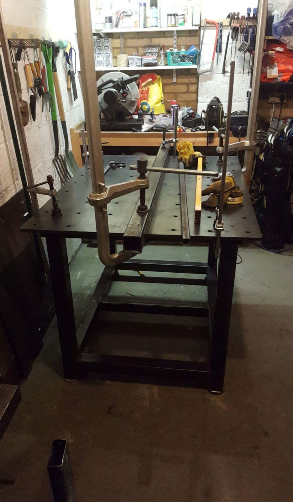

So I took the plunge today and decided I was going to get a bench top cut. Nothing fancy, but I think practical for my uses. 1m ×1.3m 15mm thick. Went with a grid pattern, 150mm from centre to centre of 16mm holes. That way I'm hoping to incorporate some stronghand tooling. Going to make the framework with a mix of 100×50 and 50× 50 5mm box. Thinking of bolting plate directly to the frame. Thought I'd put this on here as know a few people have made these, just looking for some general advice and pointers.
Thanks.
