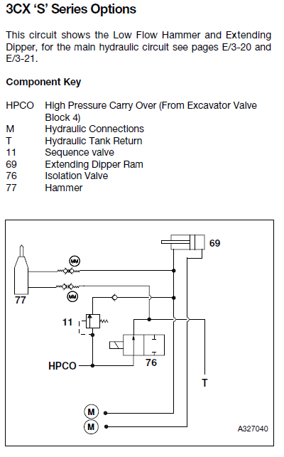

1990 JCB 3CX grey cab
no auxiliary hydraulcs on the back... I'm going to have a load of tough old concreat to break up
I was going to get a pecker for my 1.5ton digger... but after using the 3cx a bit I'd rather get a pecker for that for the extra power
anyone have experience of adding auxiliary hydraulics?
I've read around online, there's a lot of people mentioning it but they're all sparse on details
some saying put a pin in the extender boom and use the hudraulics from that... but another random mention of adding a solonoid to the hudraulic pump and tee it into the extender boom hydraulics - I think (guess) whay they're really going it just using the hoses for the extender boom
anoter mention says using the stabaliser jack hudraiulics, putting a rope around the leaver and hang it down so it's foot opperated
I think (again guess) there won't be enough flow to a lot of the hydraulics? - factory fit auxiliary hydraulics have a second dedecated pump just for them
I'm a bit lost here... maybe wasting my time... guess it's one of those things if it was easy everyone would do it and there would be a lot of info out there?
