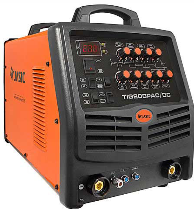

Hi Guys,
I have a jasic welder like in he attached image. The display has started to play up, it reads between 0 and 380ish, but is only a 200a welder. I measured the tig welding current using a clamp meter, and the display seems to show exactly 1.9 times the actual welding current. These displays seem common on a lot of welders, but I cant seem to find any information on this issue. I opened up the welder and there are several trim potentiometers in there, i didn't want to go adjusting them before talking to you guys. Does any one have a fix for this issue?
Cheers
