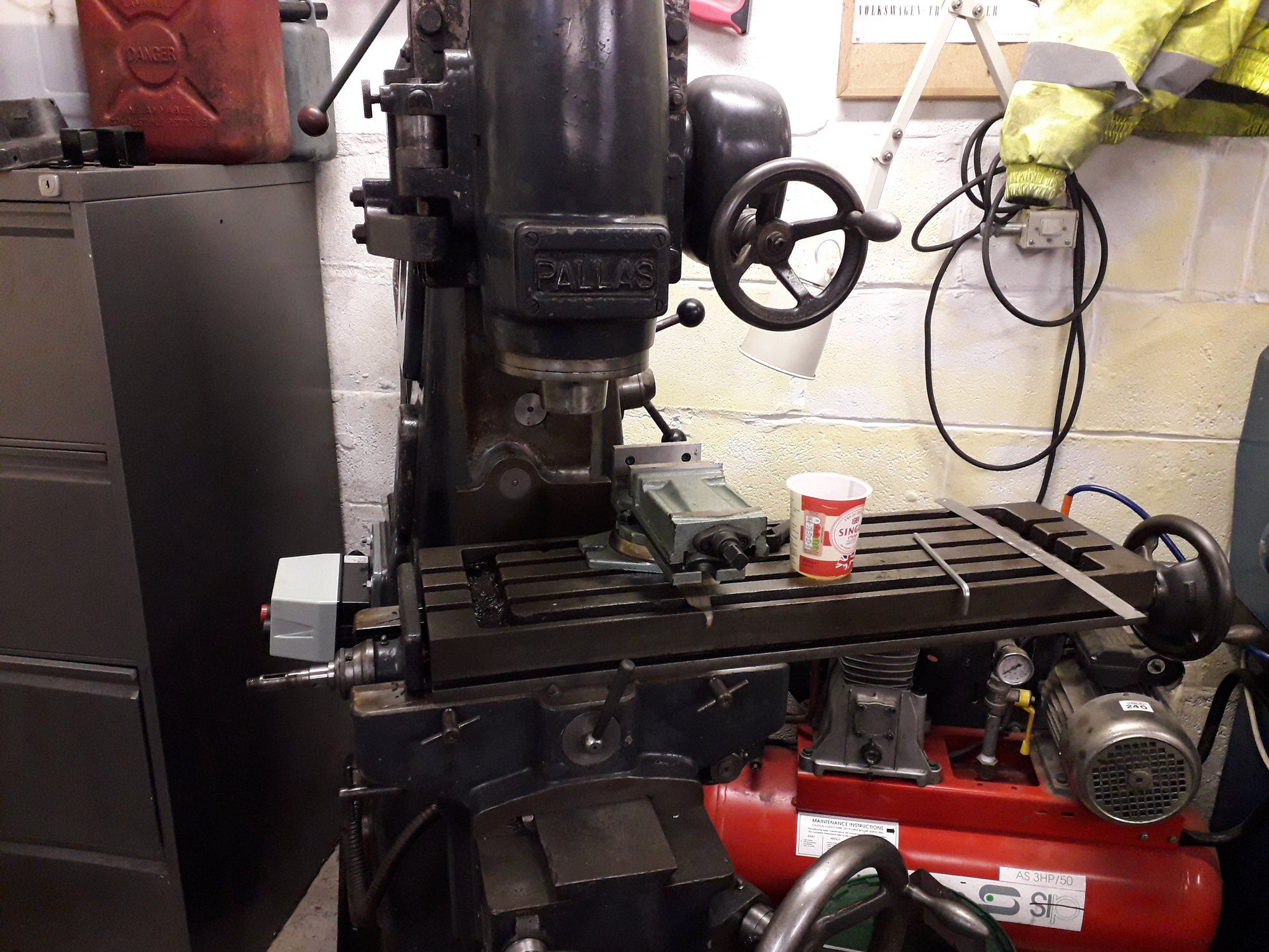

Hi. I have messed up....
While testing the oil pump on my Elliot Pallas V1 mill, I had the motor running and forgot the table indexing lever was depressed.
While I was busy watching the pump, the table traversed until it locked. I didnt have the stops in place.
1st I knew was when the motor tripped.
The table is now jammed solid.
Someone else must have been daft enough to do this so any ideas how to move the table in the opposite direction?

thought I had bust it. put some good pressure on the hand wheel and whacked the end of the table with a rawhide hammer and it freed off thank god
