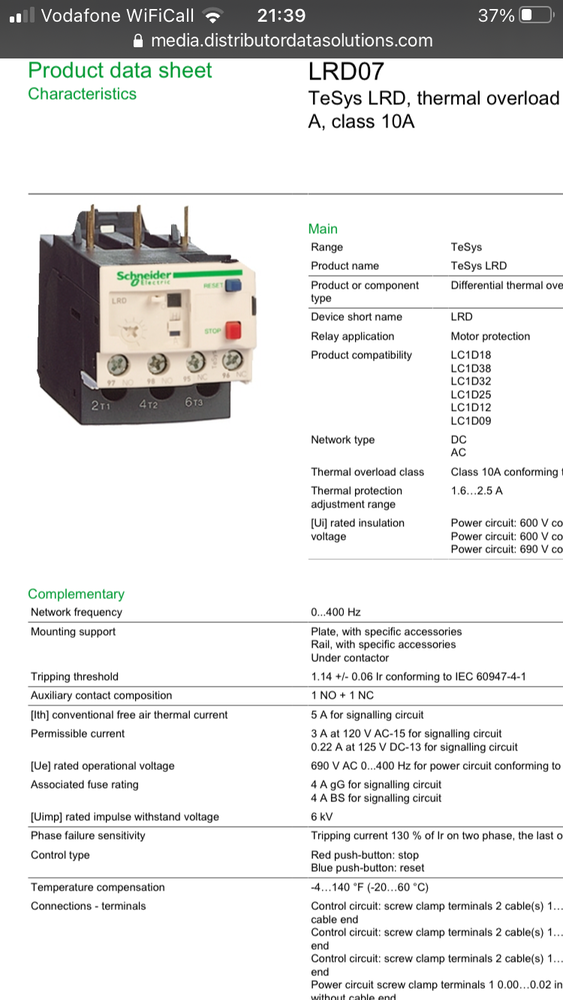

So I've ordered two Schneider Electric LC1D09BD Contactors to use with my 24v Power Supply.
What thermal overload do I need to protect the (old and expensive to replace) motors.
The spindle motor is 420V 3~, 0.95hp and draws 1.64A according to the rating plate.
I think this is what i need?
https://cpc.farnell.com/schneider-e...-5a/dp/MC02116?ost=lrd+07&autoc=lrd07&pm=true
The hydraulic motor is a bit smaller, i need to check the rating.
