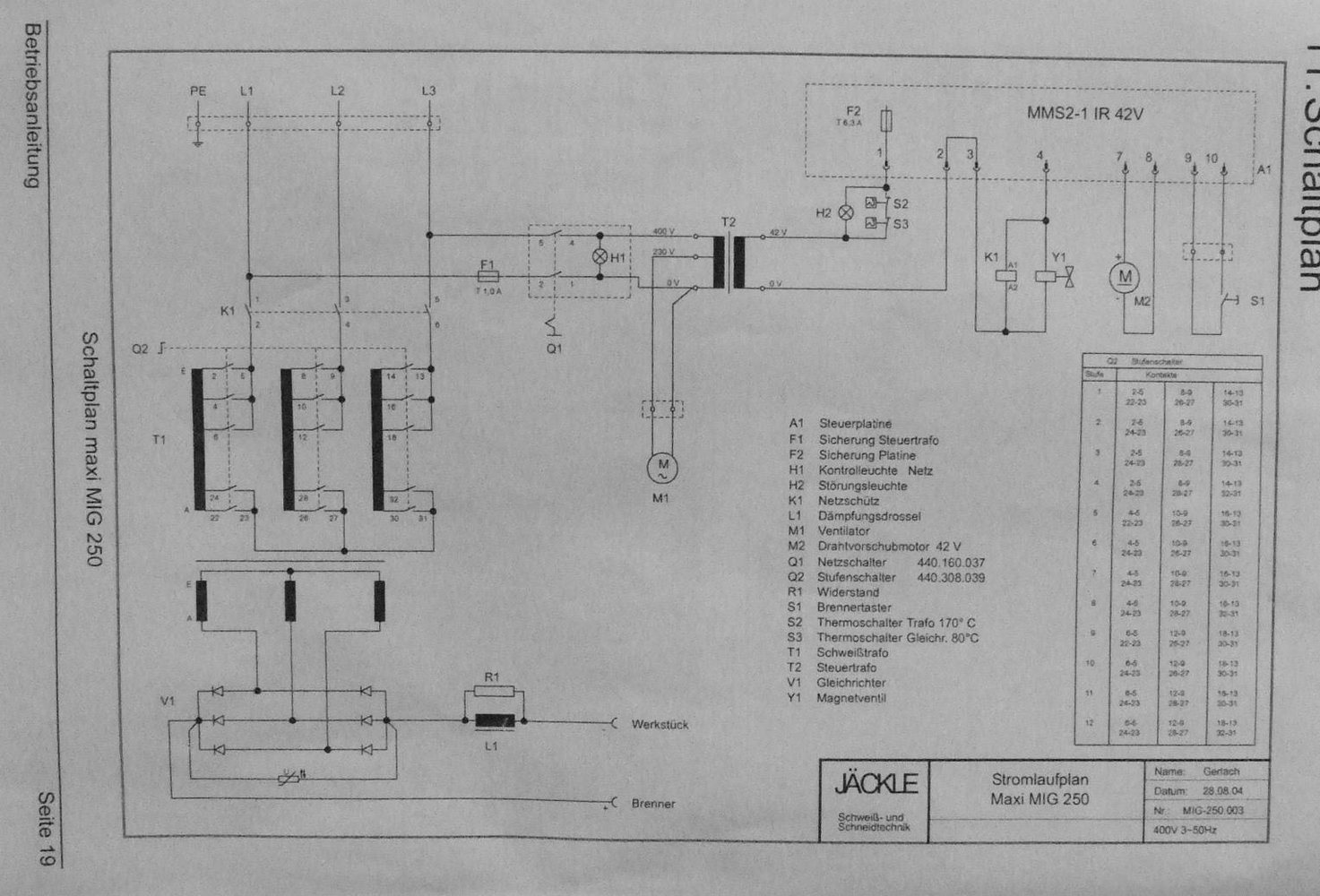

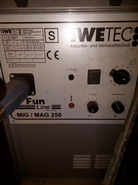

N Nix2 Member Messages 142 Location Poland Feb 5, 2024 #1 Hello, I have such a device under repair, I am looking for an electrical diagram... Maybe someone has already encountered this device? Regards !
H Hutcho Forum Supporter Messages 663 Location Derby Feb 5, 2024 #2 If no joy - post a pic off its insides just incase it’s the same as something else

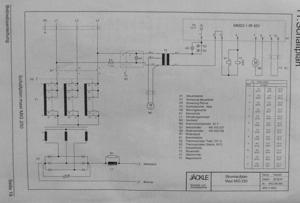

K koleslim New Member Messages 1 Location Polska Feb 6, 2024 #3 Nix2 said: Cześć, Mam takie urządzenie w naprawie, poszukuję schematu elektrycznego... Może ktoś już spotkał się z tym urządzeniem? Pozdrowienia ! View attachment 436708 Click to expand...
E eddie49 Member Messages 4,872 Location Reading, Berkshire Feb 6, 2024 #4 koleslim said: View attachment 436834 Click to expand... Witamy ! That was quick...!
