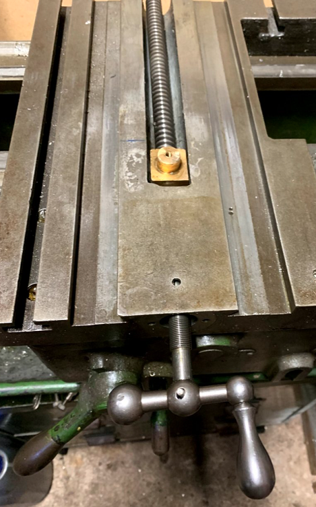

You sure? Looks like 4 screws to me, two in the T slot on the left (facing the lathe as if you're using it), two on the right.Sorry - I may be getting terminology wrong, but the whole lump (apron and saddle?) appears to be a single cast unit
The carriage is the whole lump. Comprising the saddle and the apron.the whole lump (apron and saddle?
There are caphead screws in the teeways which suggests that it isn't one piece? Sorry someone beat me to it. I'm sure a leadscrew and nut plus gear can be organised for you on the forum? What size and pitch is the leadscrew? Remember to remove both power shafts before you drop the apron.So.... mixed news...

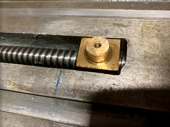

On the upside I reckon we have a diagnosis, which is that the transfer gear from the feedscrew to the cross slide screw has stripped (at least) a couple of teeth.
Continuing the (relatively) good news, the screw is straight and the brass nut seems undamaged.
Have a look at this (short! 50 seconds...) video to see the problem. The transfer gear is in permanent contact with the cross slide screw so it jars when winding in and out.
I reckon the only sensible short term fix is to remove the transfer gear entirely so that the cross slide rotates freely, at least until I can find a replacement (if possible for a 1930s lathe)
