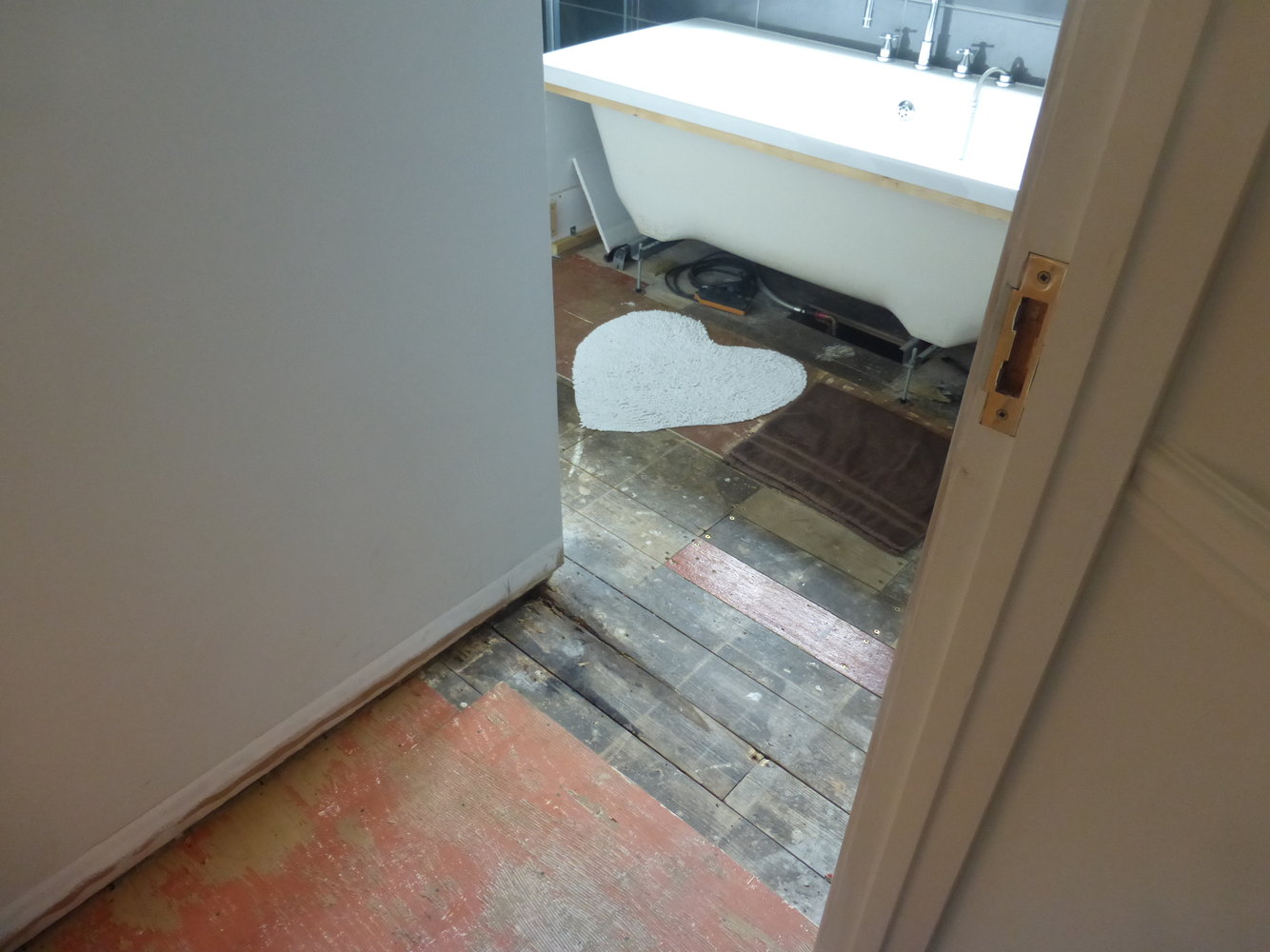

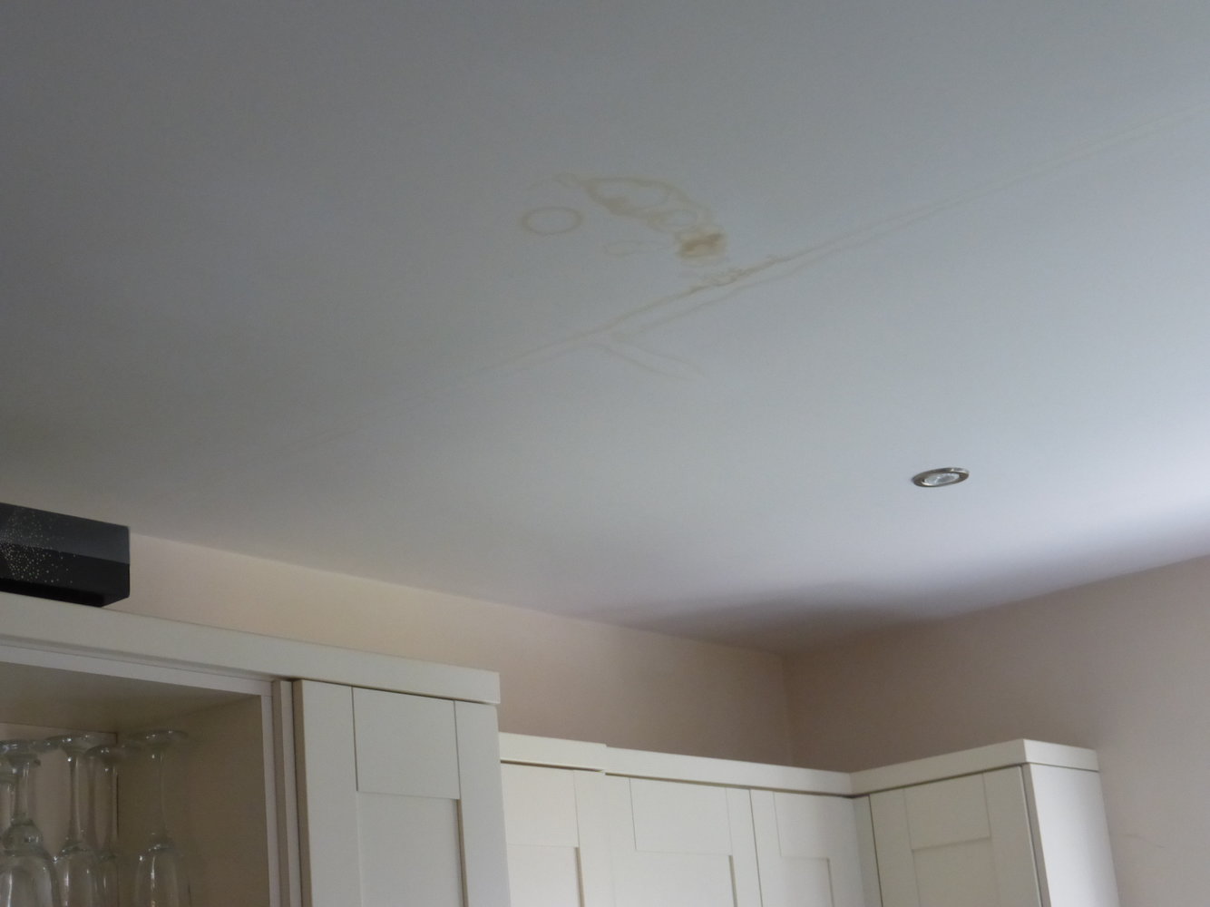

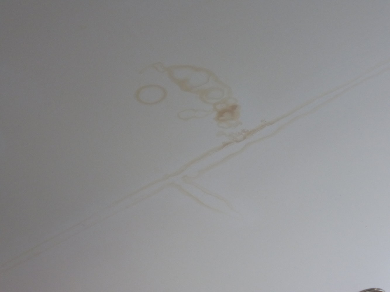

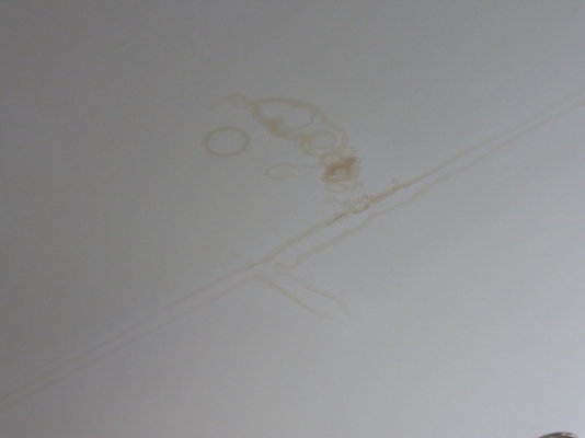

Well can we guess where this is going , quite a few weeks back the missus spots what looks like a water mark on the ceiling so I pencil mark it as tracking along a board joint and it's a lowered ceiling . then about 3-4 weeks ago the the shower hose came off the 3 way valve under the bath and the now enlarged stains I thought were just that drying out , but on tuesday more fresh water stains !
So two ceilings or one floor

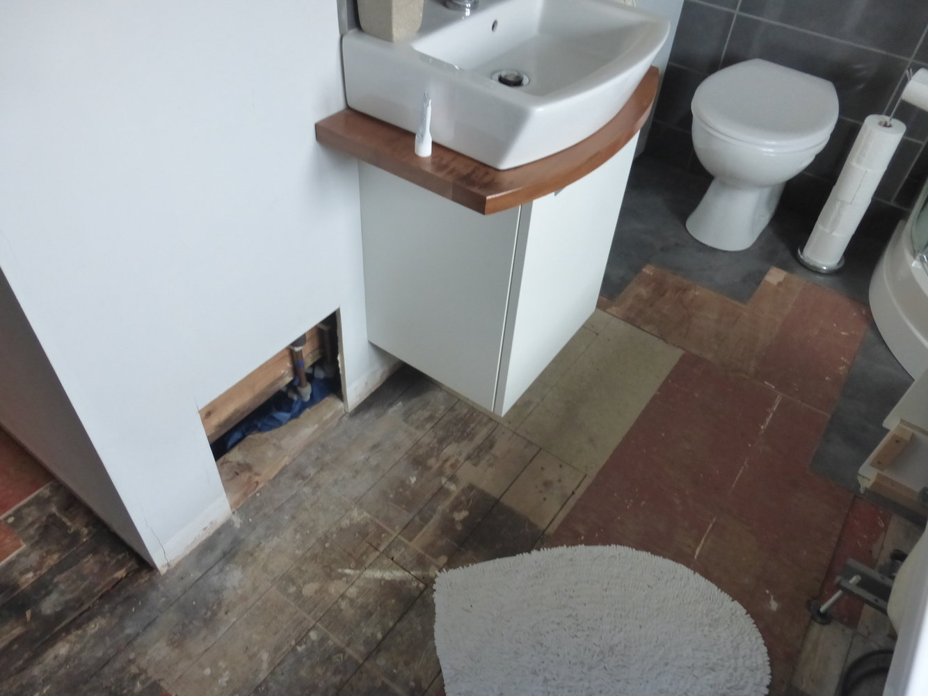

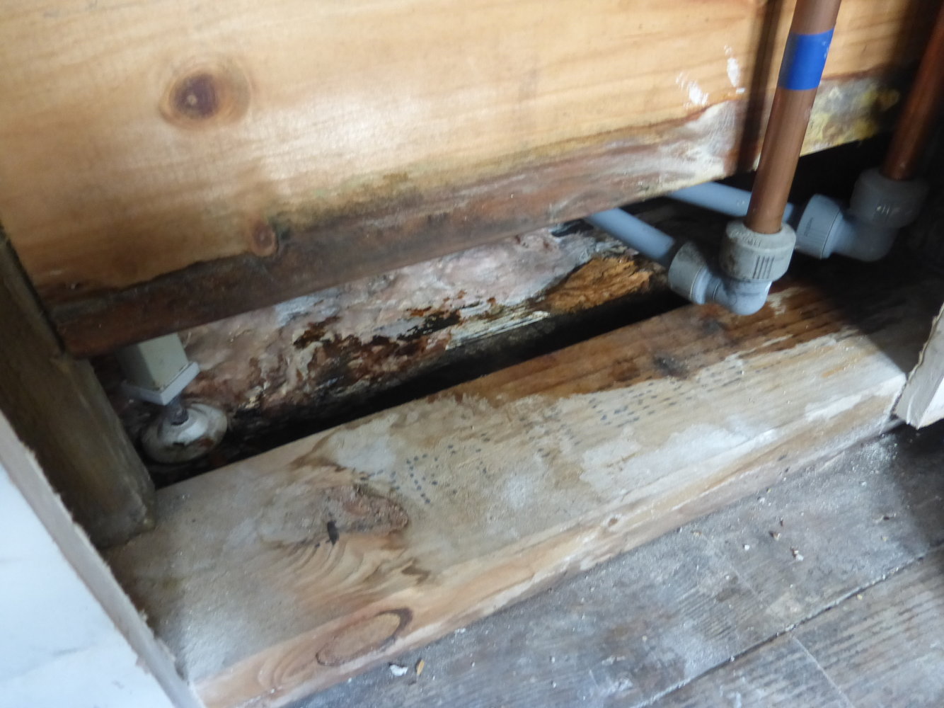

well the floor lost so I take the day off wednesday and start ripping stuff out , I built most the extension about 18 years ago so a pretty good idea where everything is , me nice kardeen flooring and ply wood up and low and behold
those lovely wet /rotten floor boards at the corner are basically the back of the ensuite shower and around the corner
Now that's been leaking some time
I'm surprised the shower leg hasn't gone through the floor , well the good news is there ain't none

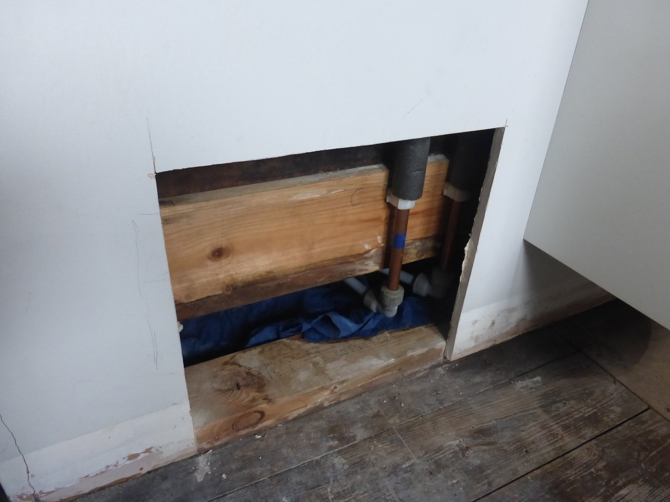

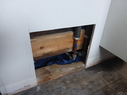

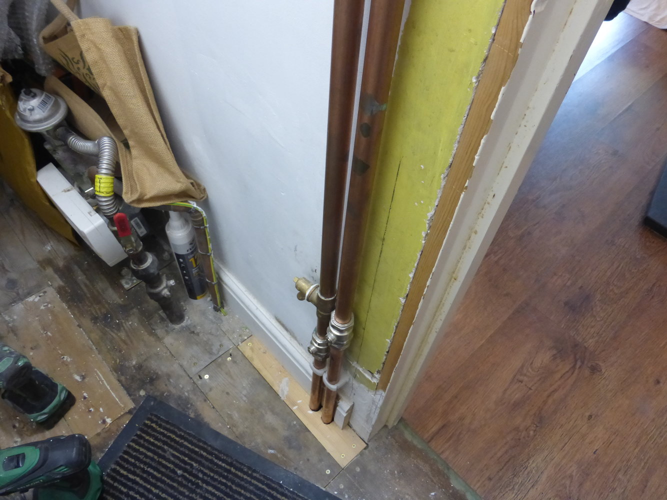

I'm going to have to rip out the ensuite and start again . I hated those fecking textured tiles anyhow . Because I'd ripped stuff about I did take the time to do a bit of an upgrade to the central heating , the flow and return downstairs is all 22mm but had 15mm risers to upstairs and was some what restricting the rads so two new risers and along the landing in 22mm
Two full bore iso valves and a drain I can now drain just the upstairs if needs be , the ensuite isn't going to be a killer as sanitry shower tray and glass can all be saved so boarding plastering tiling , I'm gonna be a busy man , We became mortgage free on the 28th of last month and i thought what am I going to spend the spare money on

its just finally found it's way down on to the dropped ceiling .
