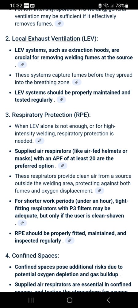

In answer to the original question.
Ultimately there is no truly safe activity, and what level of risk and exposure you are comfortable with is a decision you have to make for yourself.
All welding will involve some amount of exposure to welding fume, and grinding dust.
TIG tends to be at the very clean end of the spectrum, and requires smaller workpieces, which need to be scrupulously clean, so generally involves much less fume, and somewhat less grinding.
This makes is generally at the low end of the risk spectrum for welding activities.
However, as TIG is generally used for aluminium where long term exposure is linked to Alzheimer's, and stainless steel (which contains sensitising heavy metals like Nickel and Chromium), and certain post welding cleaning processes require the use of various chemicals there's still some risk.
There's a hierarchy of how to mitigate that risk:
- Designing your workflow to minimise release of materials (e.g. machining weld prep on a lathe or mill rather than grinding),
- Reducing potential for exposure by capturing fume or dust at source (using LEV in a cabinet for grinding activities, and LEV arms, or built in torch extraction for welding fume),
- Controlling exposure with RPE and PPE (PAPR welding hoods, dust masks, overalls or welding jackets that are strictly for the work area),
- Good industrial hygiene (laundering PPE regularly, cleaning up dust before it accumulates, proper hand washing when leaving the work area, before eating or before using the toilet).
