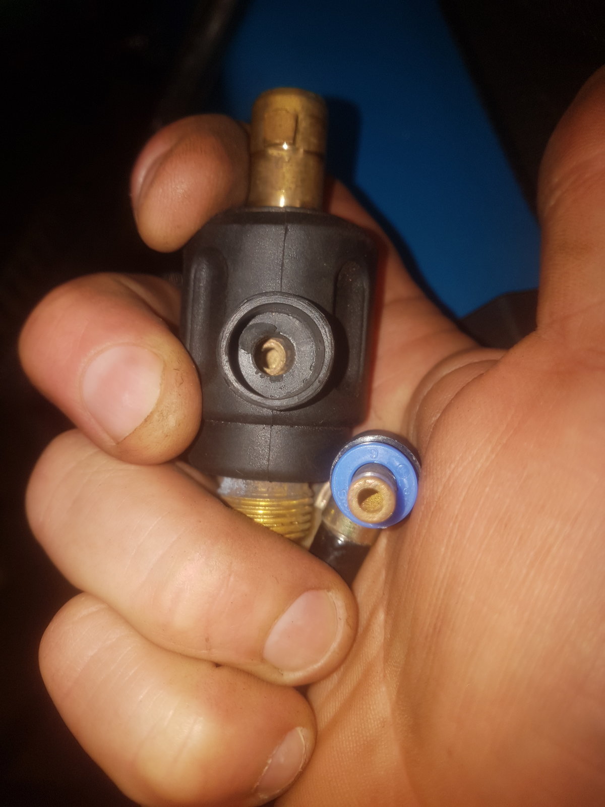

Looks like it should have an o-ring on it. No mechanical lock?
no no o ring it is gas tite but just porley made I think the small copper pipe was glued in
Makes no difference it’s still the same part. When you get your water cooled torch you will have 3 lines.
Power/water return (usually red)
Water out or feed (usually blue)
Gas (usually black)
when swapping between gas and air cooled torches would you have a different dinse adaptor? ( so not to contaminate the gas one with coolant then)?
Well yes but my question would be why would you want to go back to gas cooled
I’d take the lot personally but that’s just me. I Can’t stand gas cooled set ups.
