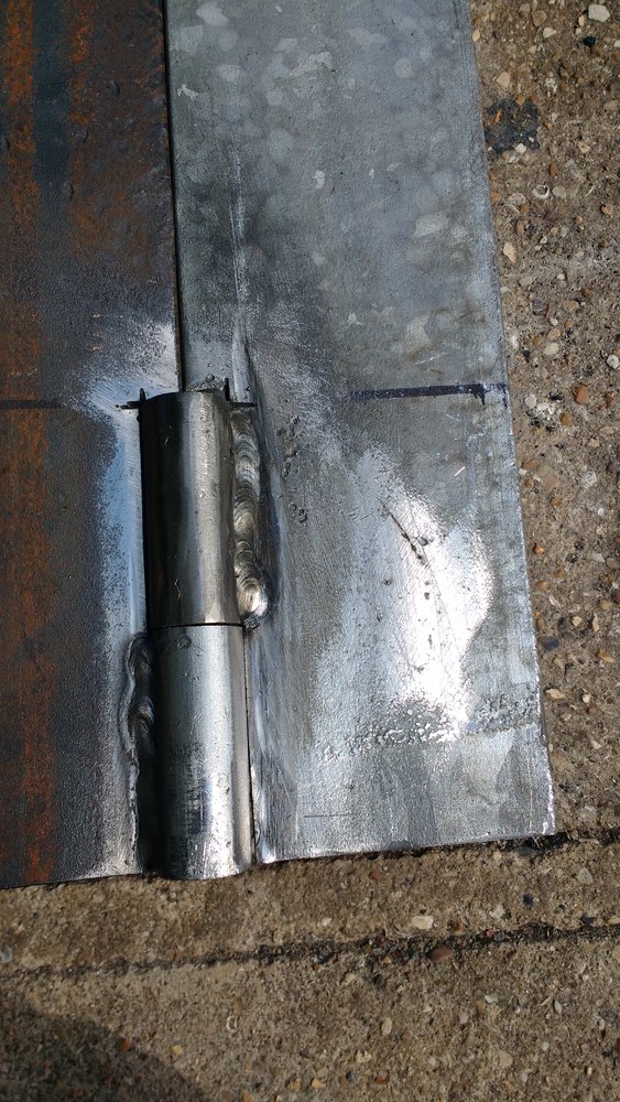

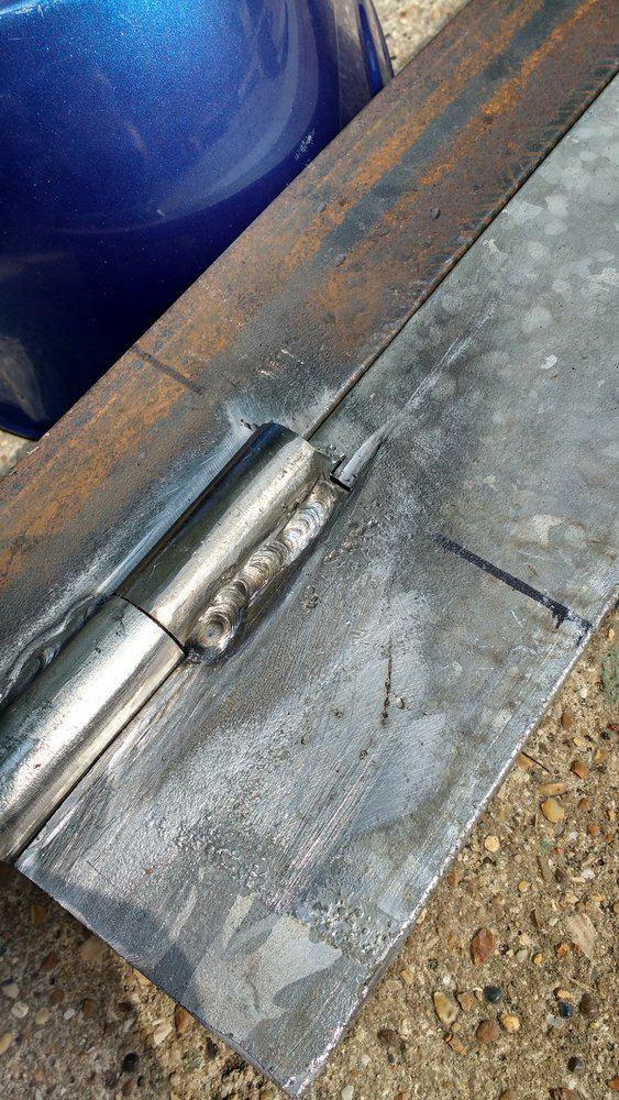

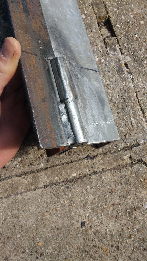

Finally a welding mask I can see out of, a IFL WH9801. I can see! Shade set on 9.5.
2.5mm 6013 Superon rods been stored in a dry cupboard for ever then a handful sat atop the oil boiler for 24 hours.
Parweld XTS162 set on 85A. Dropped from 90A as it seemed to eat the rods a bit quick!
Any comments appreciated, especially how to keep a straight line!
