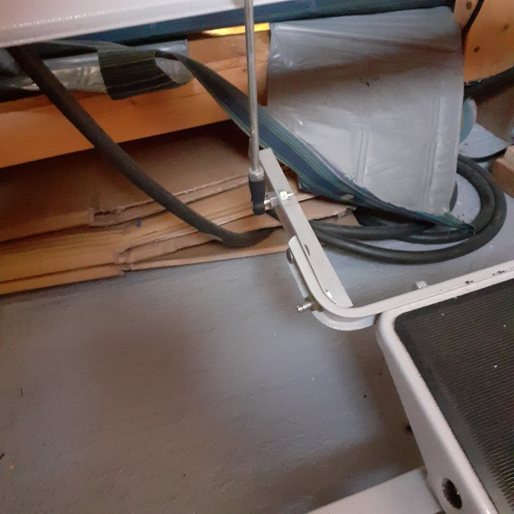

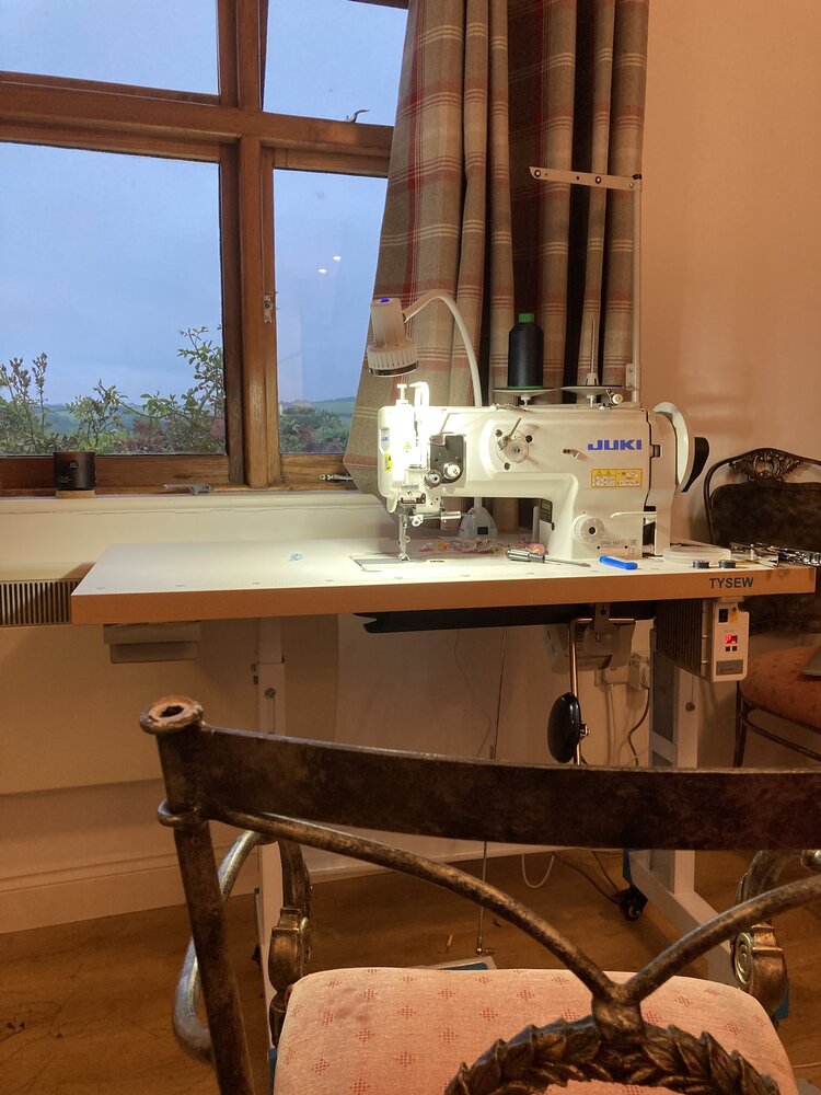

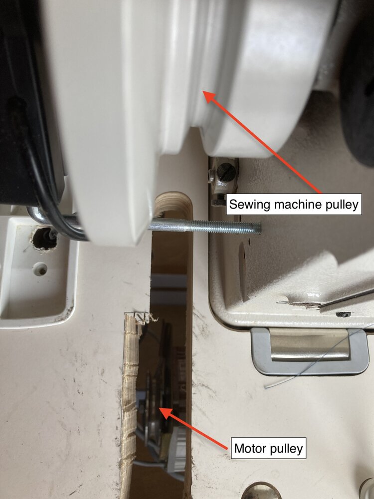

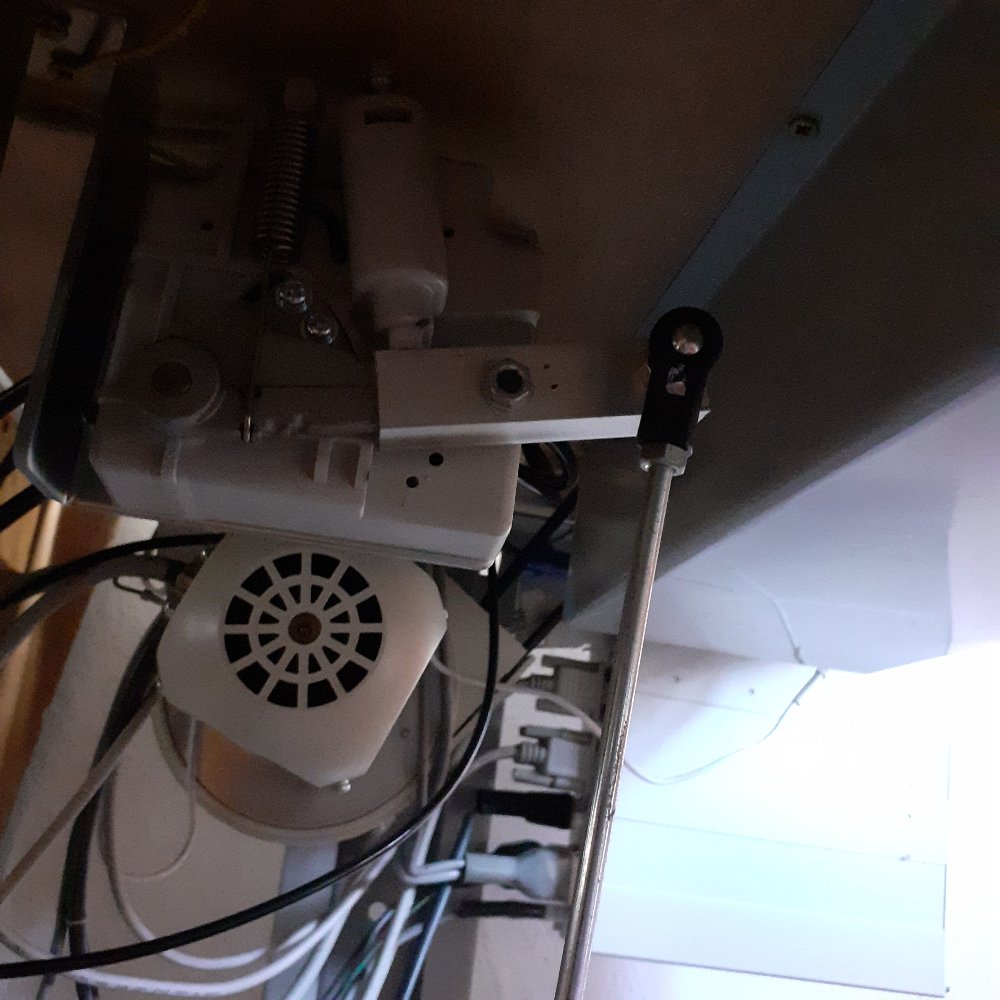

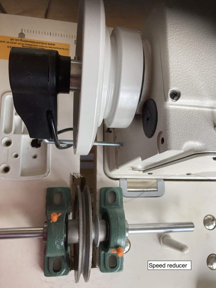

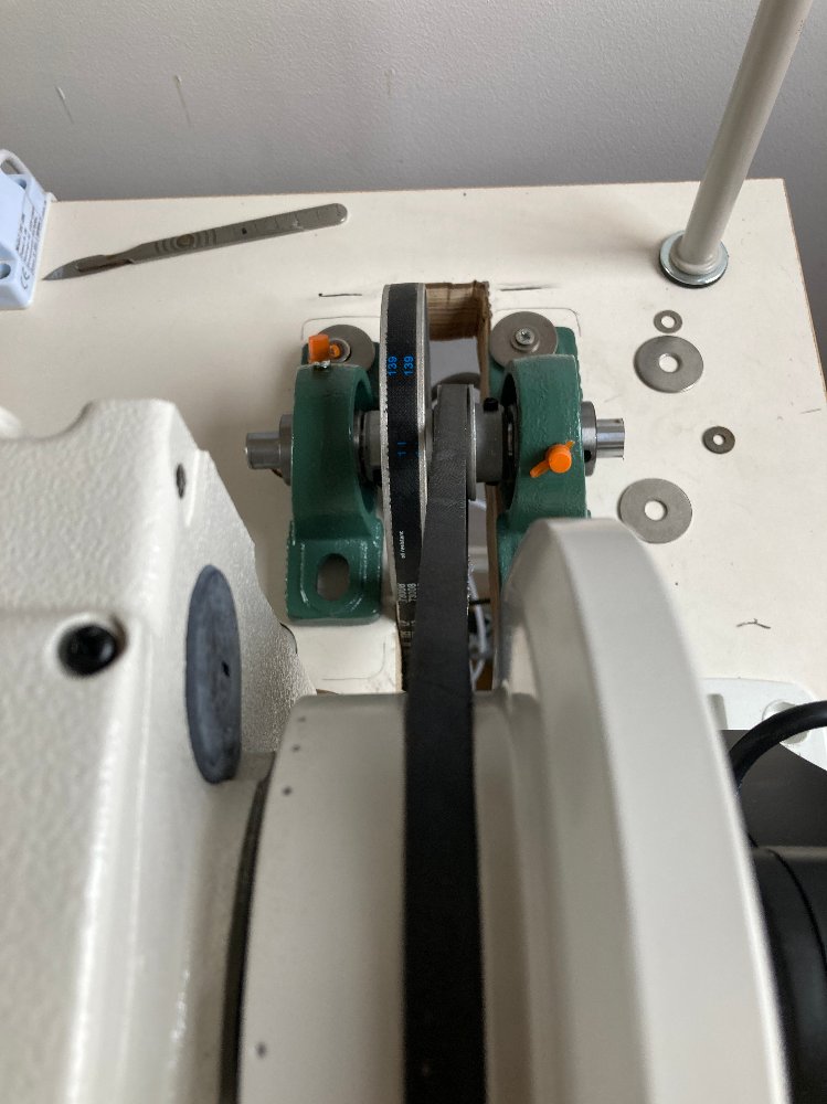

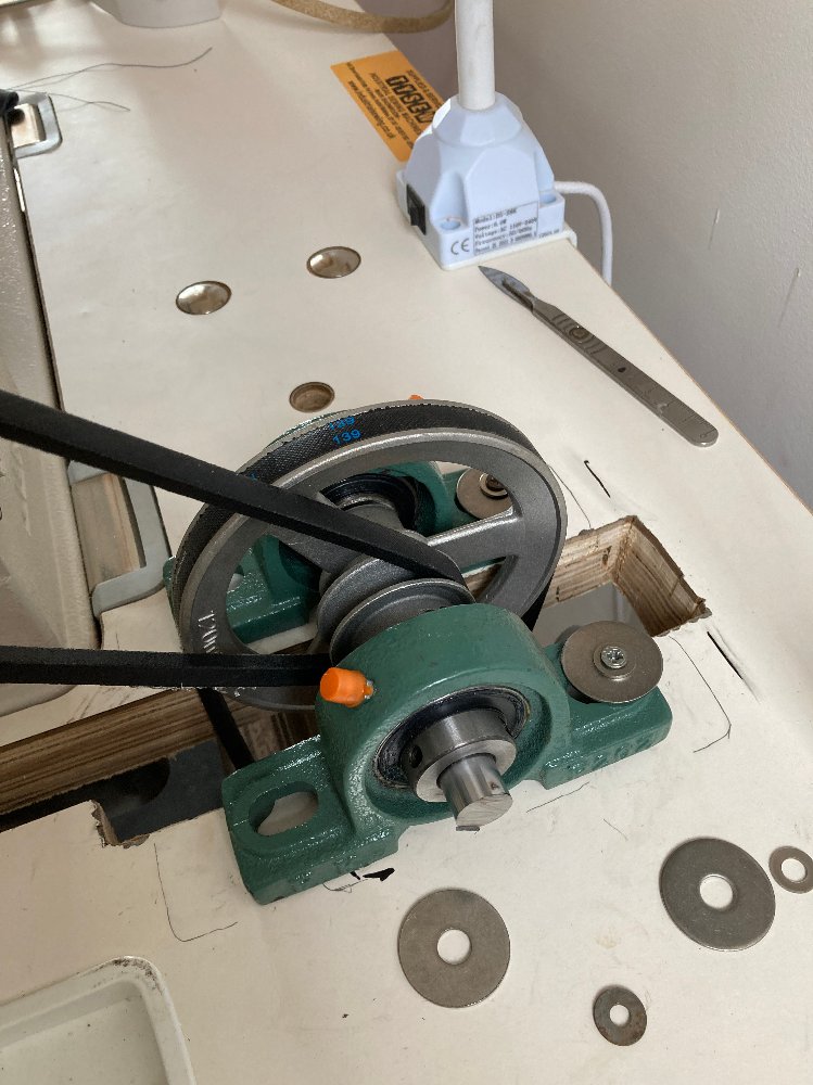

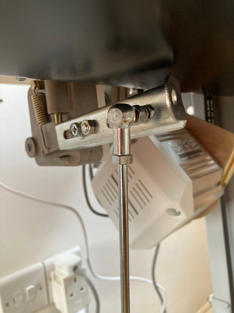

I am currently re-upholstering my 1950's Jensen. I have an industrial sewing machine (Image 1) and would like to slow the machine down to make some complicated sewing easier. I have made a speed reducer (a 45mm and 120mm pulley mounted on a pair of pillow block bearings) to sit between the motor (below the table - Image 2) and the sewing machine. There will be one belt from the motor to the speed reducer and a second one from the reducer to the machine (Image 3). I can only adjust the motor position (on its pivot) to tension the first belt I need to be able to adjust the lateral position of the speed reducer to adjust the tension of the second belt (from the reducer to the sewing machine).
Apart from drilling several different sets of 4 holes to mount the reducer bearing blocks is there a simple way of constructing something that will allow me to move and lock down the reducer in different positions to get the correct belt tension.
