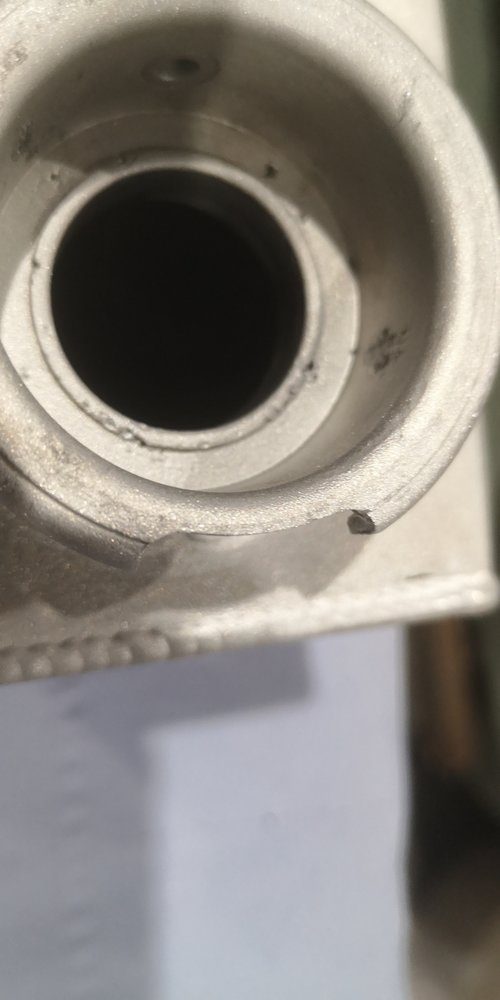

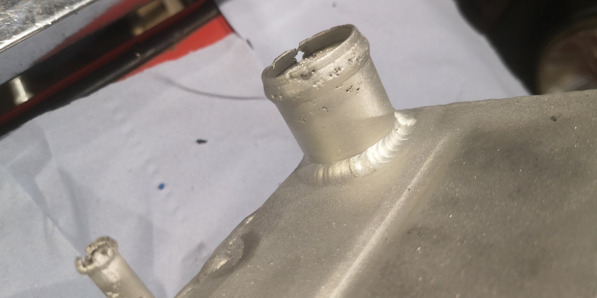

Ive got an aftermarket header tank ive taken off the car while i do some work. As the paint was flaking off, i thought id run it through the aqua blaster to clean it up and key it a bit to repaint.
However as you can see from the pics, its not all that well.
Given its only 4 years old, this level of corrosion suggests to me it might not be an appropiate material for a header tank. Been running blue antifreeze at 50% for the duration.
Thoughts anyone?
(yes, that crap welding near the pipe outlet. A repair i had to do in a rush as the original weld wasnt holding pressure. My first ever attemt at alloy welding though)
Thoughts anyone?
It does appear to have suffered in a relatively short time. I think I would be looking for a replacement possibly a standard plastic header tank, not so bling but proven to work.
