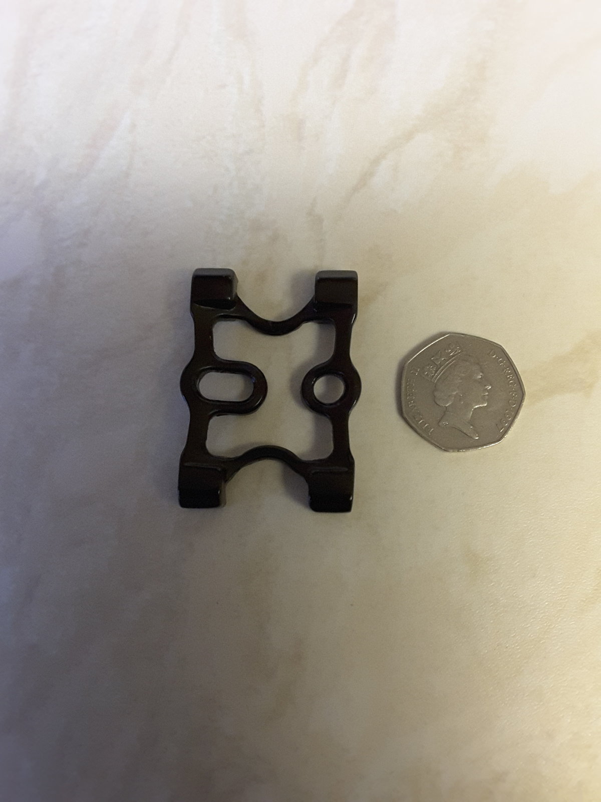

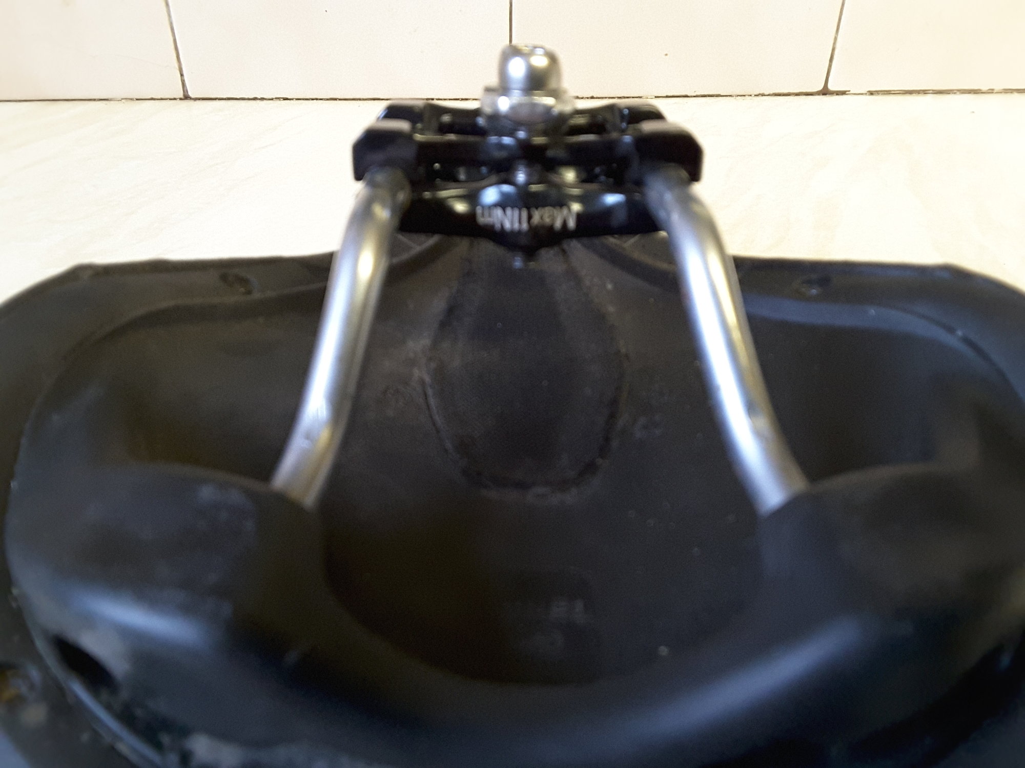

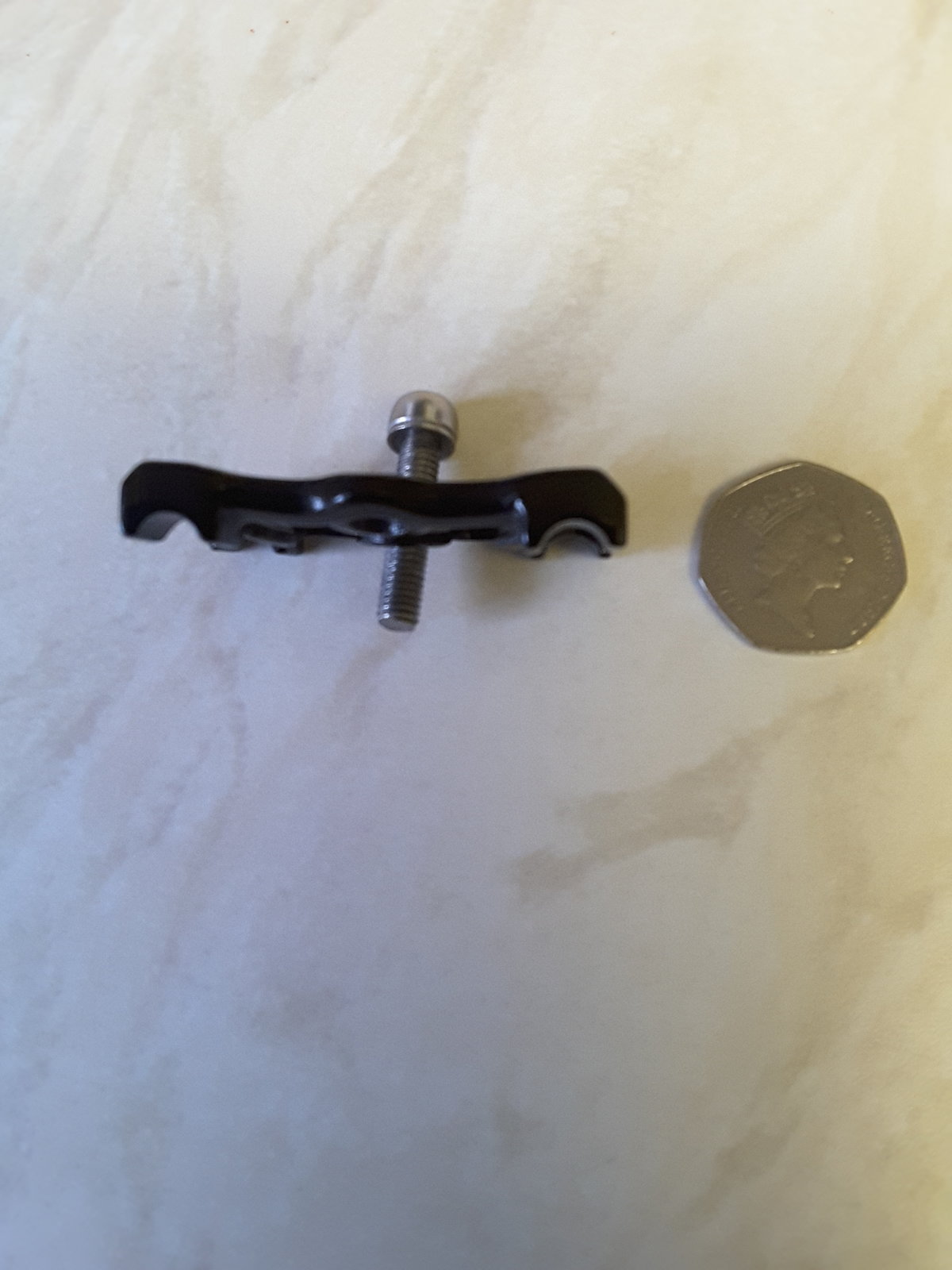

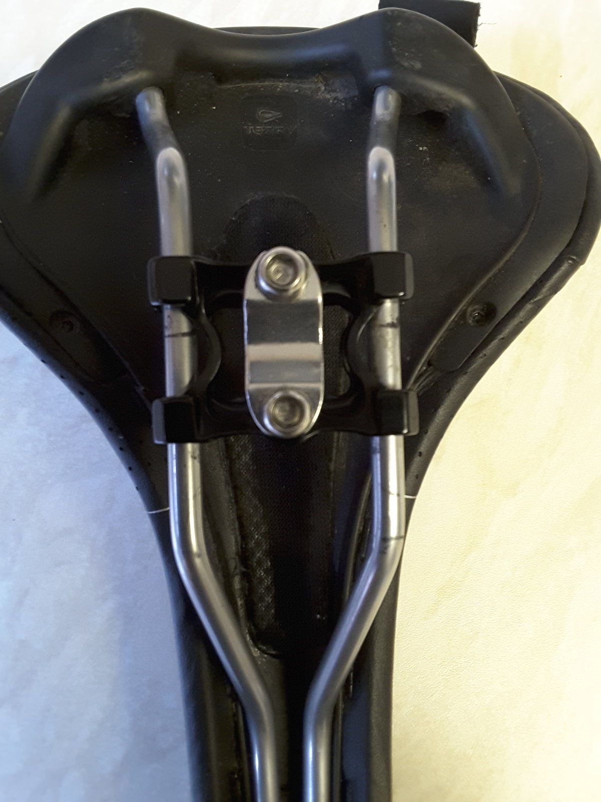

I want to make this saddle clamp from steel so that it is stronger than the original aluminium one.
At the narrowest point it is approx 4.5 x 4.5 mm, and quite weak, especially considering there is constant motion of 11 stone swaying about on the saddle. It is all that holds the saddle to the carbon seat post.
The original has already snapped. Whoever fitted it to the saddle probably over tightened it, or did not screw the little allen screws up evenly etc.
Fitting the replacement aluminium one (in the pics) is probably a waste of time.
So, simple question: Is small dia steel tube available and where from?
My intention will be to saw the tube in half length ways & weld to a bit of steel plate. Holes drilled and it should be sorted. Thanks.

The spare fabbed one made of steel will be light enough to carry in the bike bag. I would not want to be somewhat stranded 30 miles from home if the aluminium one failed again.
