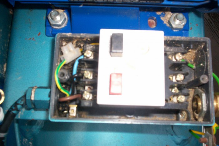

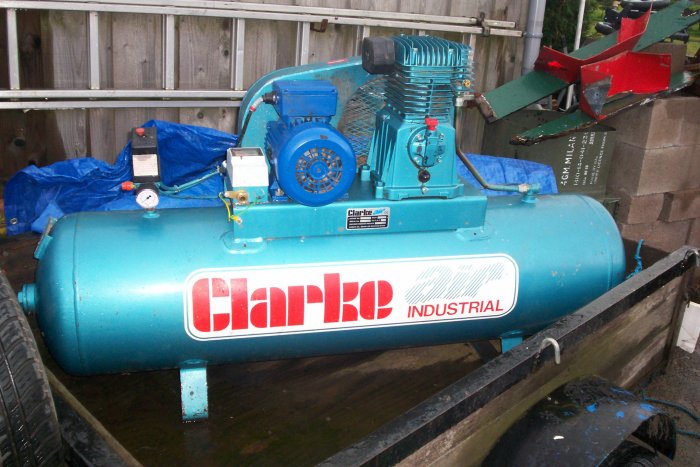

a fortune to run a compresor as the starting load under presure is highHow much would an inverter cost me then?![]()
the older motors are 415volt star wired only . the newer ones are dual voltage star wired for 415v or delta wired for 240v, both 3phaseHello Trev,
that's not quite right, it does mean that it's three phase but the majority of three phase motors are marked 415 with no mention of 240.
Alec
Deffo 3 phase - 3 wires and no (visible) capacitor.
You can it off a 415V 3Ph supply or change the straps in the motor (to delta) and run it off a phase convertor at 240V single phase.
Or swap it for 240V single phase motor - try Kenworth in Huddersfield 01484 660222 we use them at work - think they do up to 3Kw single phase but they ain't cheap and need big juice to run !
Garreth
Garreth
Hello Brightspark,
"the older motors are 415volt star wired only", I'm sure you meant delta wired as a star connected 415 will run on 240 delta.
Langy, "Shouldn't it have 4 wires for 3 phase", only if you count the earth wire, no neutral required.
Alec
Shouldn't it have 4 wires for 3 phase ??? On my compressor the start caps are in the black box, so are not obvious.
