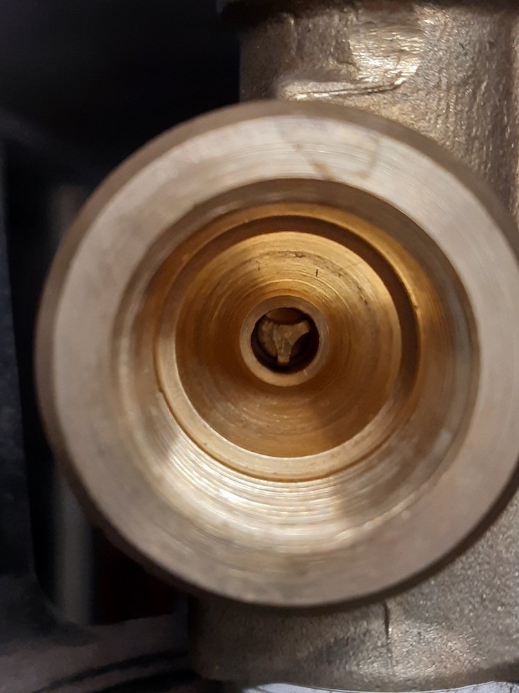

Like Foxx I'm having trouble with my SGS Argon cylinder tap.
I couldn't hear any gas coming out of the torch. I took off the regulator and unscrewed the cylinders tap and I thought the cylinder was empty - already?.
Pressing in the little 3 sided piece you can see in the middle of the cone - gas came out under pressure and didn't stop, Screwed down the tap again and it stopped, open it up again and nothing until I repeat the previous - it appears this little valve thingy is sticking - should it do this?
They're sorting me out a replacement cylinder now!
